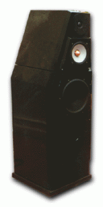

I'm not suggesting something specific but an example. At VSAC last year the winning design was a three-way SEAS system using a XO designed by Adire Audio. The builder carved the enclosure out of solid rock (he's a sculptor). Anyway, the 3-way SEAS system is very impressive. This is the best pic I have at the moment. It's the big gray one in the middle.
