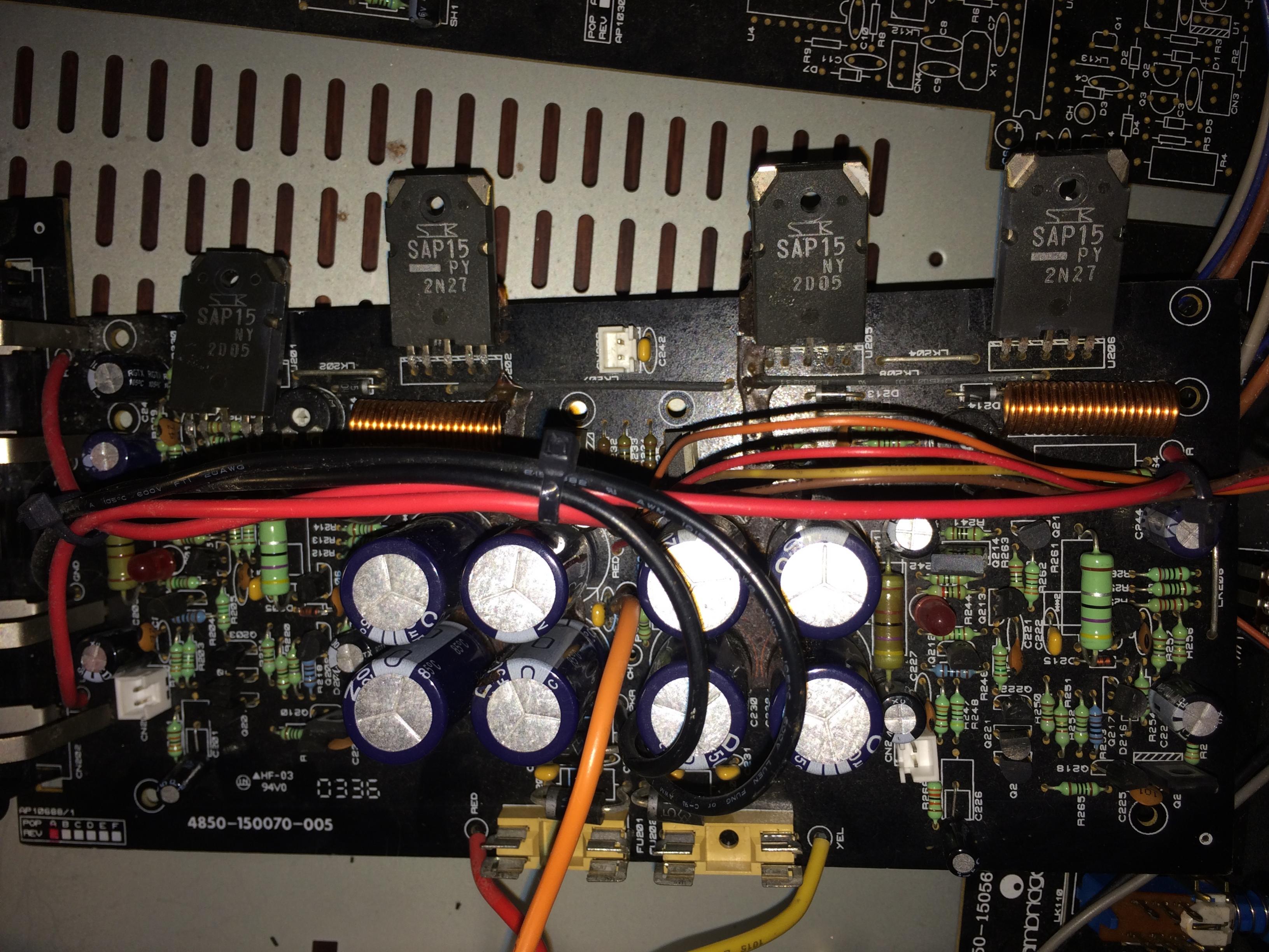

Almost certainly the SAP15 transistors will have failed. They have a known weak point which is why Sanken discontinued their manufacture... and the poor heatsinking of these Cambridge amps exacerbates the problem.

BTW, don't assume output transistors are completely gone, maybe only internal 0,22R emitter resistor are gone, it happened before.
If those resistors have blown, the transistor package will have been compromised (even if you cant see the crack). The transistors need replacement therefore.
My experience of these amps when they have been "partied" is the following. Part numbers are for the left channel:
* The SAP15's fail. Sometimes catastrophically, you can see holes in them.
* Often the bias pot (RV201) fails, and so does the capacitor (C238) across it.
* The VI limiting components often get damaged - Q207, Q207, D202, D205 and associated resistors
* Sometimes the VAS stage is damaged - Q206, Q210, Q211 and associated parts.
Use the service manual for the Cambridge Audio A500 - the amps are nearly identical, the power stage is.
I don't recommend fitting SAP15/SAP16 as replacements - they are obsolete now, can be tricky to get (leading to you looking at eBay and getting fake parts), and have the same problem.
Instead you can fit STD03 transistors - these are the same except they don't have the internal emitter resistors. You can then fit some external 3W 0.33 ohm resistors in place of them. This has proven to be reliable in my experience, though still doesnt make Cambridge amp's "party proof" !

I managed to take one NY transistor out yesterday. Only one connection, S-E works and my DMM reads ~0.2Ohms. The rest of the connections either show infinity or high resistance. The diode function on pins B-D reads inf/high resistance both ways.
The bridge rectifier (if that's what it is.. the 4 components right next to the fuses) show no continuity and a resistance in the Mega Ohm region.. but that may be something to do with the capacitors being crap right?
I measured the resistance across both the fuse sockets and the left side read almost twice the resistance value as the right.. No idea why.

I measured some resistors and some of them were also in the high KOhm / Mega Ohm region. Is it normal to have resistors of such a high value?

It's the small green resistors that measured really high.
Also the large green resistors have low enough resistance the continuity beeps across it. The resistors that are the same size (largest) but more brown have high resistance also. And there continuity function doesn't beep.
Could it be that it is measuring a sum of resistances in the circuit?

The diodes in the bridge appear to be OK from your readings. A shorted device would show (and that is how they would fail).
All other resistance checks need to have the parts isolated (unsoldered at one end) in order to stop interaction with other parts in the circuit. Also any small residual charge on the caps can confuse most DVM's when trying to do resistance checks.
As long as you have a bulb tester in place then you can temporarily link out the two secondary fuses to allow you to work on the amplifier. There is no safety risk because the bulb limiter threshold is way below the rated 4 amps, and of course we are dealing with the secondary side of the transformer.

I see the four big green resistors. What do the colour codes tell you?
I can see that the left of each pair is discoloured to brown in the middle. That indicates they have been massively overheated. That may tell you which of the output transistors is blown.
