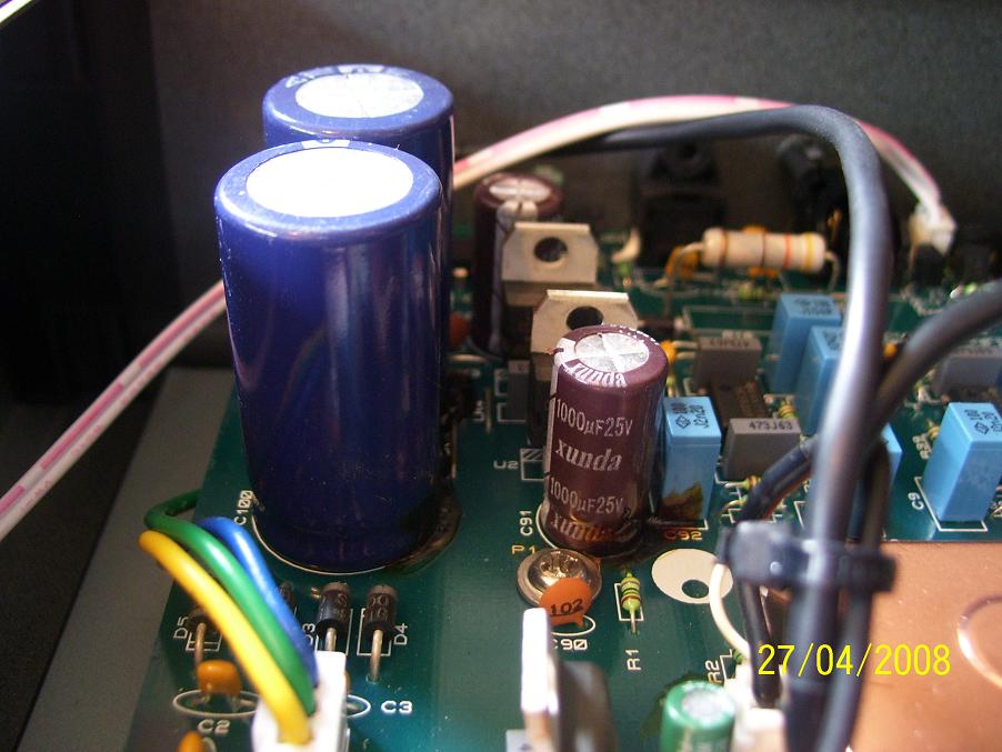

I think these mods are along the right lines, but are there also some psu diodes that need changing to schottky or HEXFRED types? Or are they a good type already?

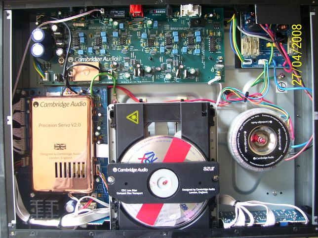

More photos here:
http://www.23hq.com/2007snowdon
Let me know what you think having seen inside the player.

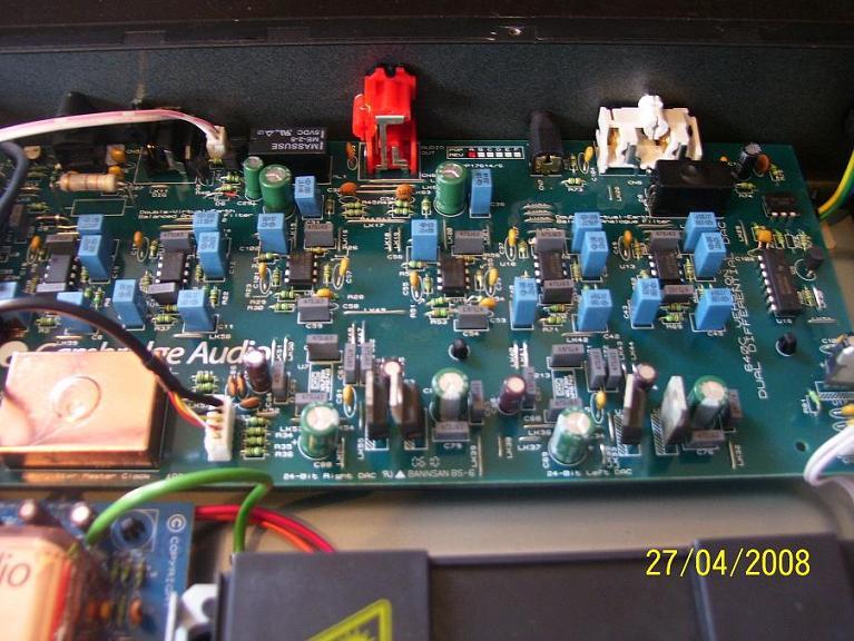

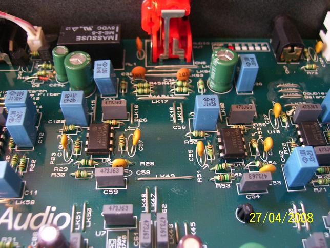

Cheers Lee.
So they need changing then. Should I change the green Caps and the Blue Bypass ones? Or just the bypass ones?
I'm ordering some Hovland Musicaps for my TDL's this week so I migtht as well get some to replace the Bypass Caps in the CDP aswell. Or lose the bypass caps and change the coupling Caps? Whta do you reckon?
Do you know which opamp to replace the NE5532P? Im sure I dont need to change all 4, just the pair closest to the phonos right?
Looking at the pics can anyone advise which are the exact components to change here? Can anyone tell me where the 2 Wolfson DAC's are?
Cheers, Mike
