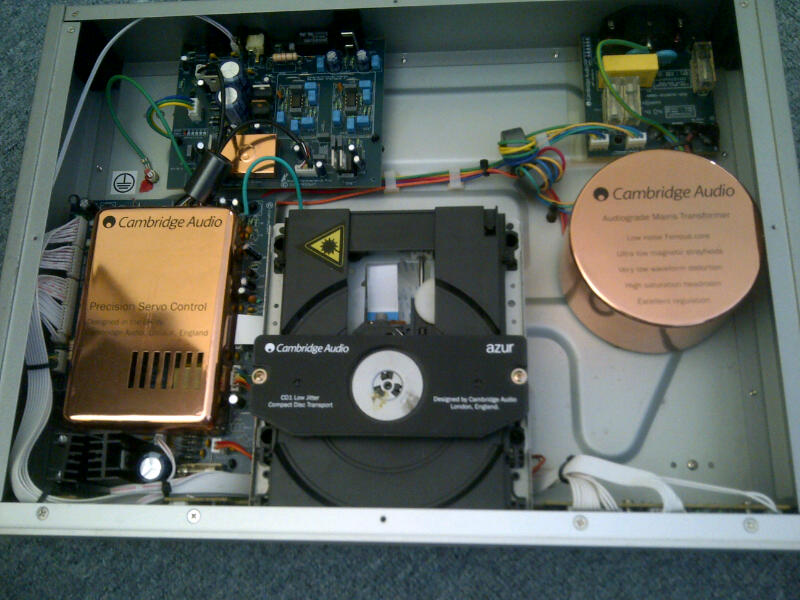

Hi Guys,
i know this is a mammoth thread but I have a few question to ask in regard to actually repairing and modding my 640C V1.
My unit is 6 years old now, and after shipping it back from Australia to the UK, noticed a problem with the CD drawer going back and forth when trying to open and close the drawer.
When it did eventually decide to behave it's self, it sounded different although it has been some months since I last played it, but It sounded very harsh and unbalanced.
Upon closer inspection I found a number of leaked/leaking Electroclytics in the following areas.
Servo Board, C49 next to the heavily heatsunk voltage regulators, C82
Both 22000uF on the output board. adjacent to the 4 diodes forming the bridge rectifier.
I was think I may as well change these out for superior versions and change the NE5532P's for LM4562's.
I have also noted some hum from the transformer, the V1 does NOT contain a toroidal :(
Is it worth spending the money or should I look out for a second hand V2 to mod instead.
I notice the the bulk of this thread and attached images relate to V2 modding.
The V2 is pretty much the same unit. It has an improved tx (needed for the extra circuits) and a twin dac output. The rest is the same.
There is nothing wrong with a 'normal tx' they usually offer more current than the equivalent toroidal. CA used a copper plater can to cover the tx. Mostly for show but if you gnd it then is becomes a shield.
To be honest though, if you really want to upgrade it properly then you should add custom power supplies to isolate the circuits.

Thanks for the reply guys.
I guess firstly I need to have this unit in proper working order by replacing the electrolytic caps and then go from there.
Like 99% of people here I am on a limited budget, so I guess it is about getting bang for buck when it comes to modifying, and perhaps a progressive mod over a duration of time to spread out the cost.

Brent,
Would you advise earthing the shield/shroud over the Tx, I guess this could introduce RF noise into the circuit?

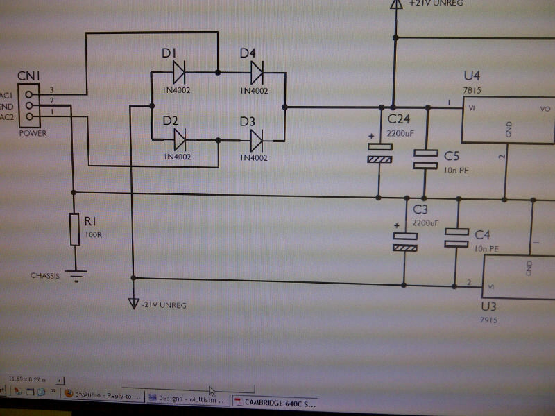

Hi Guys,
I have a question,
What would you advise replacing the two main smoothing caps on the main power supply? On version1 Schematic they are shown as C3, C24 22000uF 35V. I assume nothing too special as they are only smoothing caps.
I also plan to replace NE5532P's for LM4562's

Hi Guys,
I have earthed to cover on top of the transformer as advised by Brent. Cheers Brent.
I have installed 8pin sockets where the op-amp are mounted so i can try a couple of different types of op-amp.
Iam also going to repalce the smoothing caps, x2 2200uF. for some Rubycon ones, they are not boutique but I am sure they are better quality over the stock ones which are branded 'NCD'.
I plan to add some damping to the case too.
Any hints and tip from your experiences are most welcome.

Hi Andrew,
From what I can tell these are the main smoothign caps for this part PCB, supplying the Voltage regulators that provide 15V to the op-amps.
The caps in question are lablled C24, C3.
Dom

Quickly simulated the circuit with shown below, and simply put a 1k resistor across the smoothing caps to act as a load.
You can see on the scope that with the 2200uF caps there is some ripple from them, I guess it depends how well the voltage regs respond to that ripple?
Dom
Hi Andrew,
Those appear to be the main smoothing caps for the DAC board. The voltage appears to be stepped down by the transformer to 21v for this circuit.
I have replaced them with 2200uF 50V Panasonics. Just to see if it had an discirnable difference, it hasn't.
