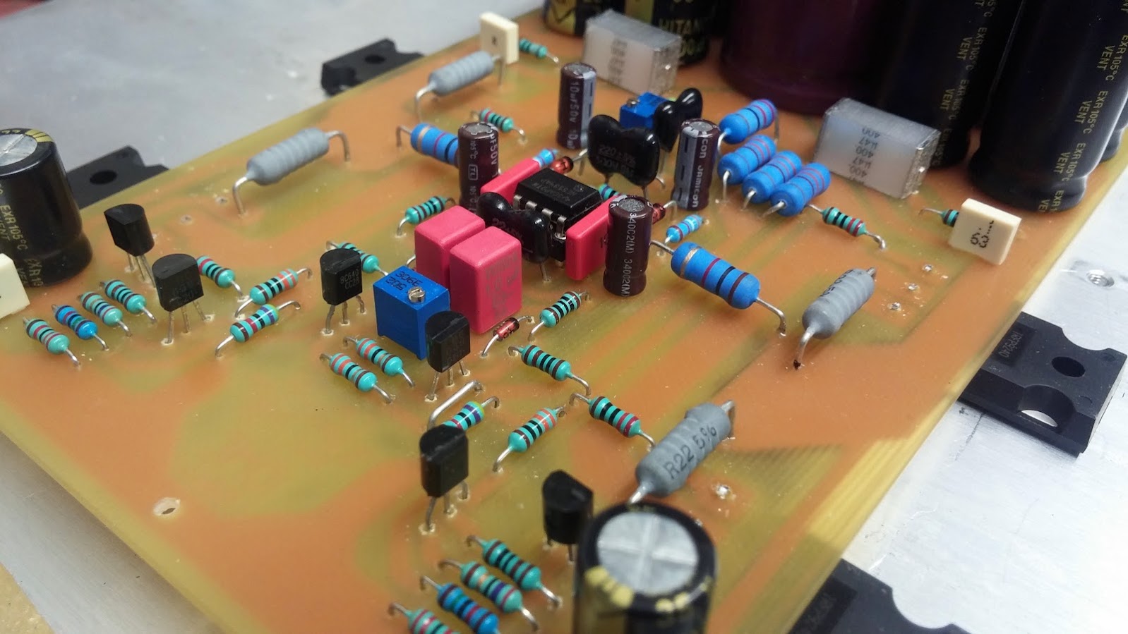

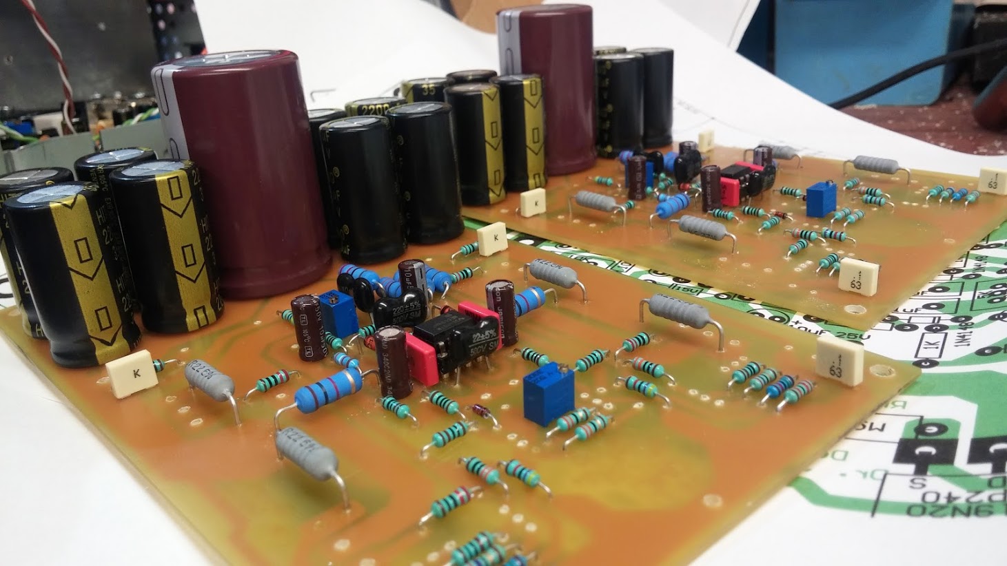

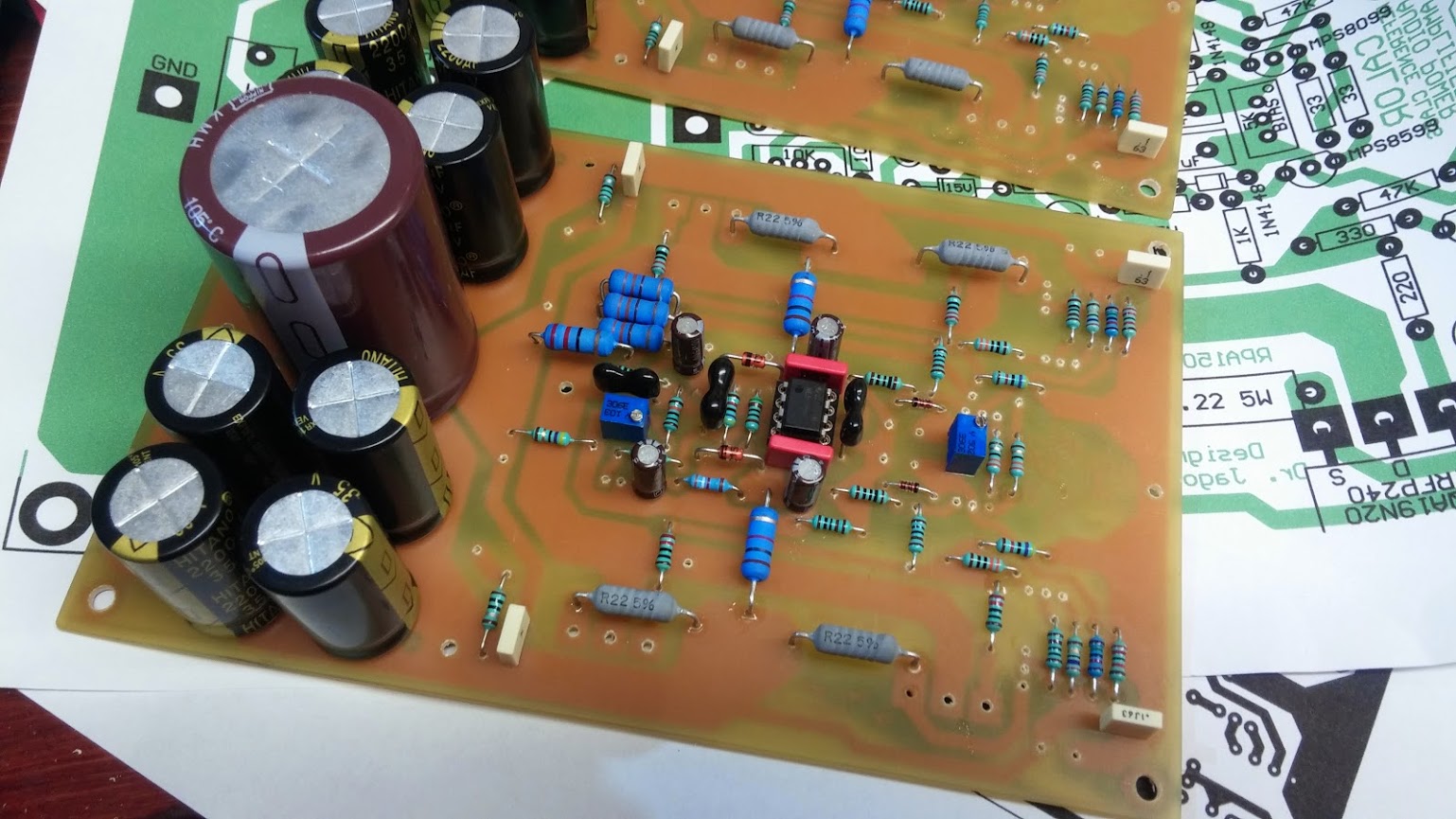

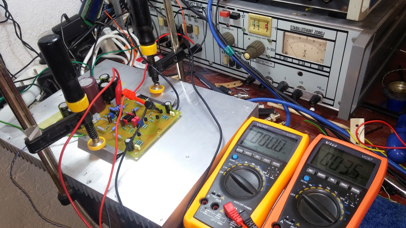

Yesterday I started work on this amp. Again by my own made PCB by simple toner transfer method... Some part missing, let´s continue tomorrow Thank you for support Dr. Bora

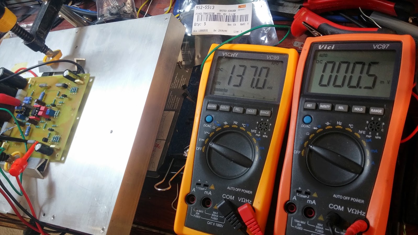

This is an old thread but i have the curiosity to know if it is any progress.So, now amp running well.. I am dope, i forgot, that I used trans with different pinout... Now I using ZTX450/550 .... Now I have to build proper PSU...

Guys, i have a lot of requests for PCB.. dr Bora didn't want to resend any materials without his permission, but situation is changed, and I hope that he wished to get his project aviable for next generation... so, if its someone interested, send me e-mail, and I will send what I get from him... maxwell(@)atlas.cz
Waiting for the results when you listen to it!After very very long time .... I decided to bring this amp to live... so today i will try , how does it sound
I have one chanel never completed,no power supply.

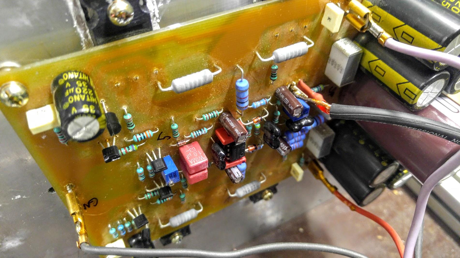

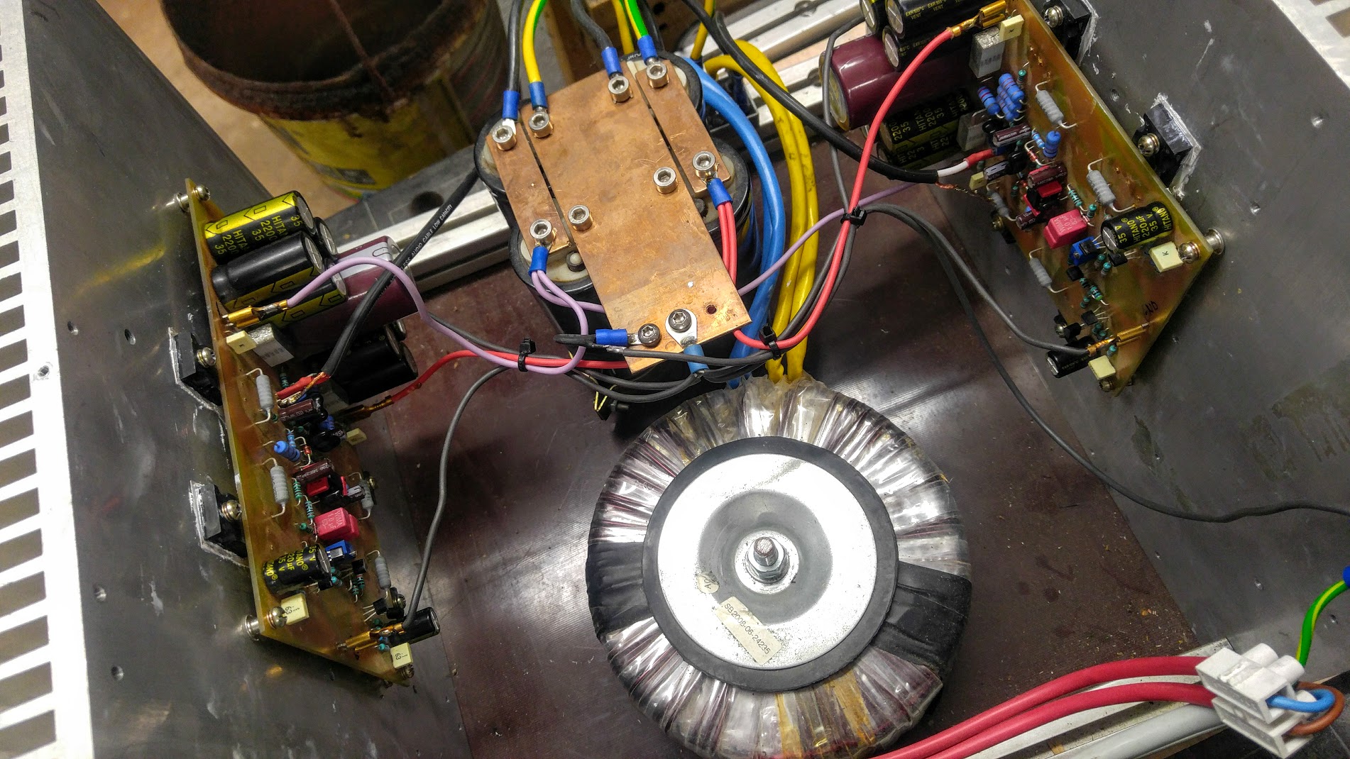

Congratulation dear Maxwell007...
I made 3 stereo of them... and all sing very fine... one thing need your attention is we need to use a very good compensation capacitor for the lead compensation C5 - 15 pf. maybe the silver mica cap is a proper one.
