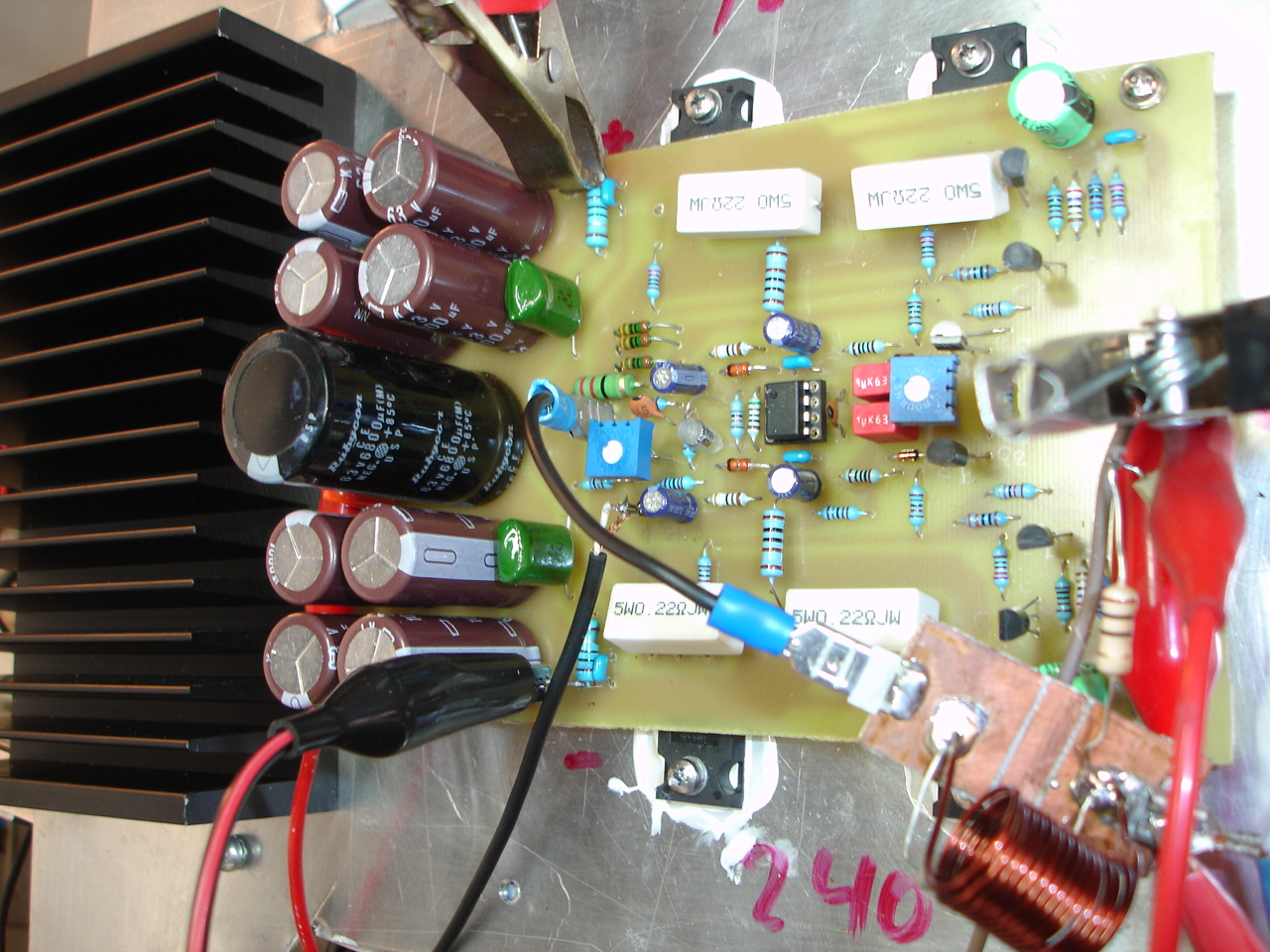

small progress in calor gold.

That's before first test fire!small progress in calor gold.
I must mention that i haven't all appropriate parts so some parts are for test conditions ONLY.
I must mention that i haven't all appropriate parts so some parts are only for testing conditions.

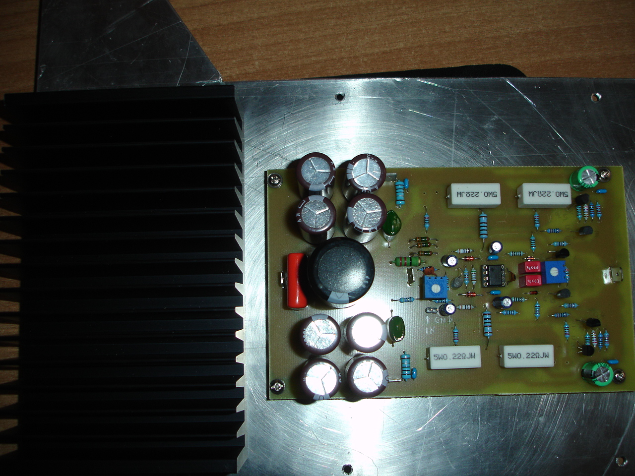

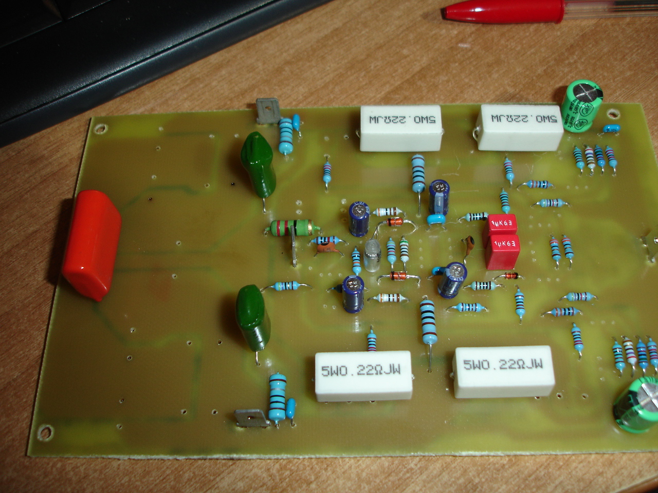

CALOR GOLD

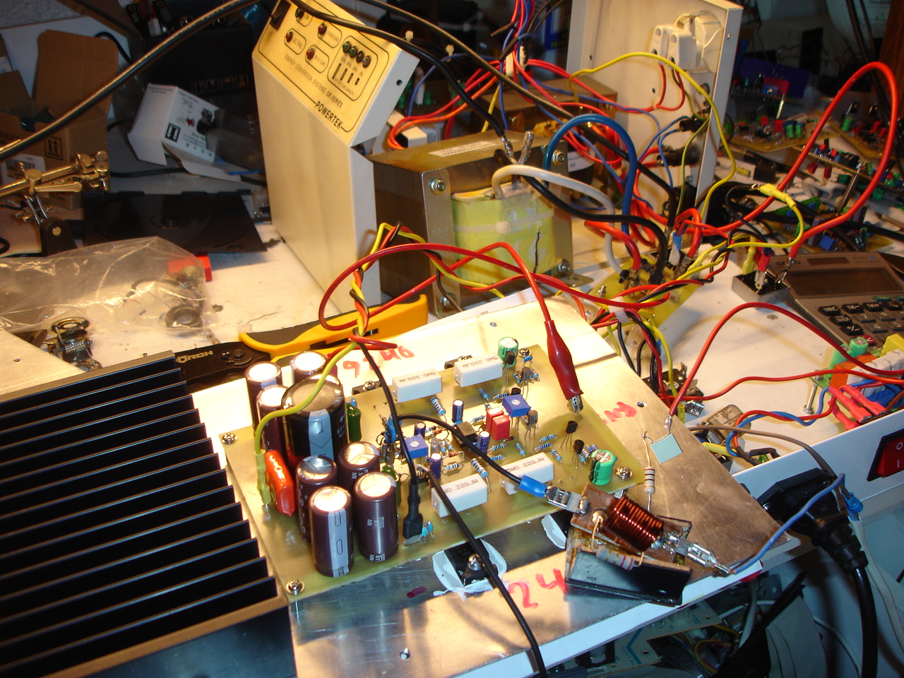

First test successfully ended.
First time, amplifier tested at +/-24v from two regulated power supplies.
Second test with two transformers ,one +/-16v and other +/-8v in series.
All under control.
All small signal transistors BC550C,560C.
Out fets IRFP240,9240.
Sorry Dr.but i have these on hand now.
Tomorrow i will have a small listening test.
Some pictures from first test.
I guess it is not permissible to show the copper side.

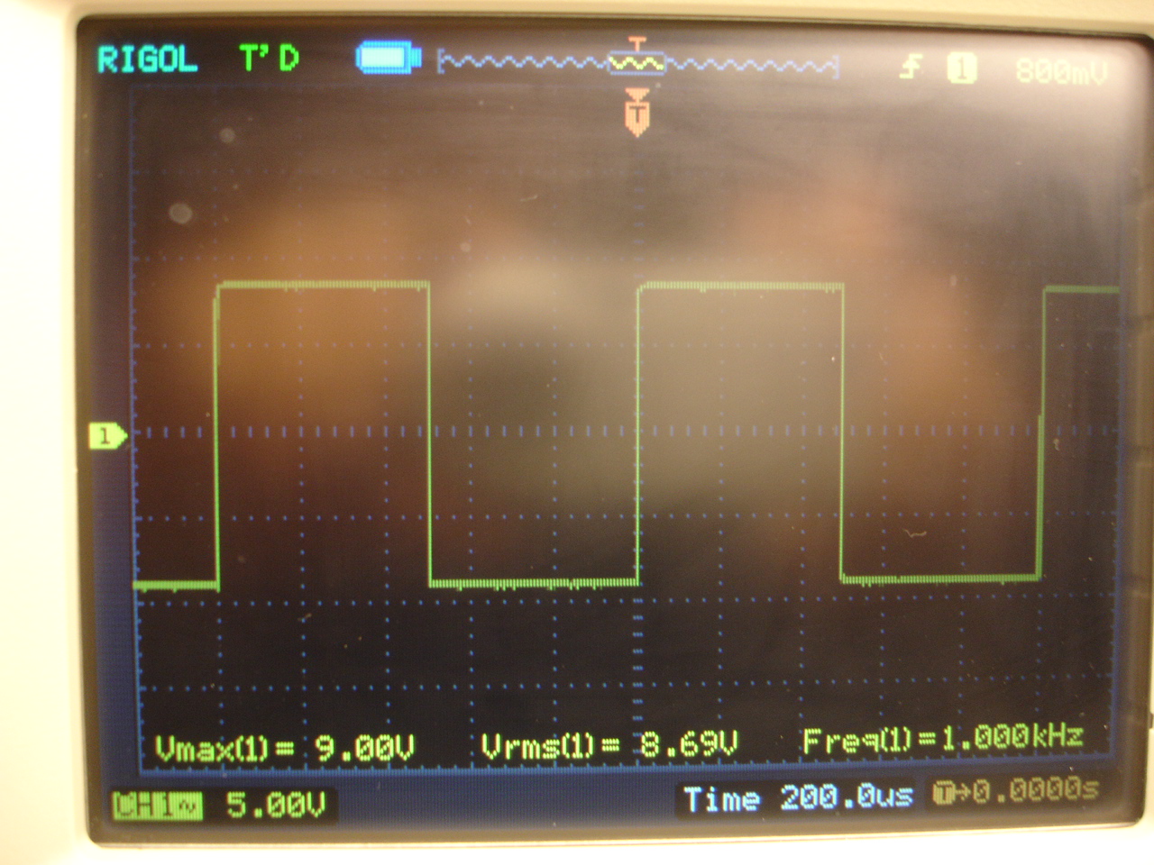

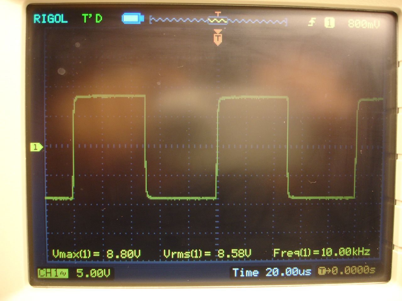

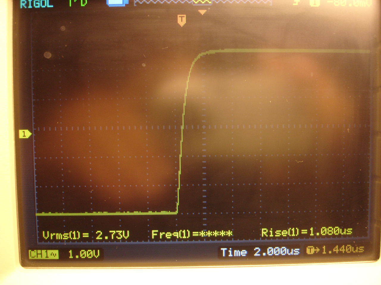

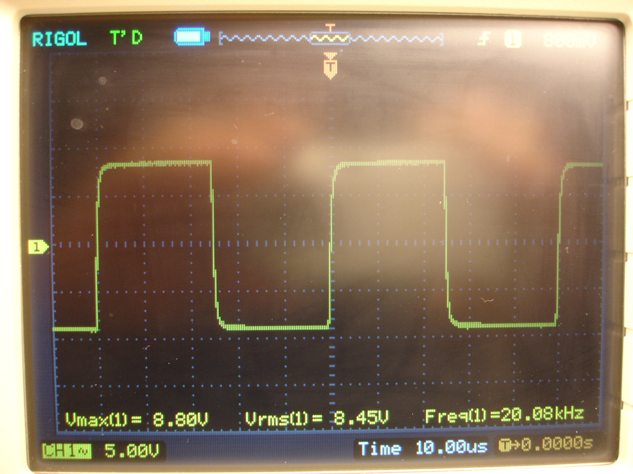

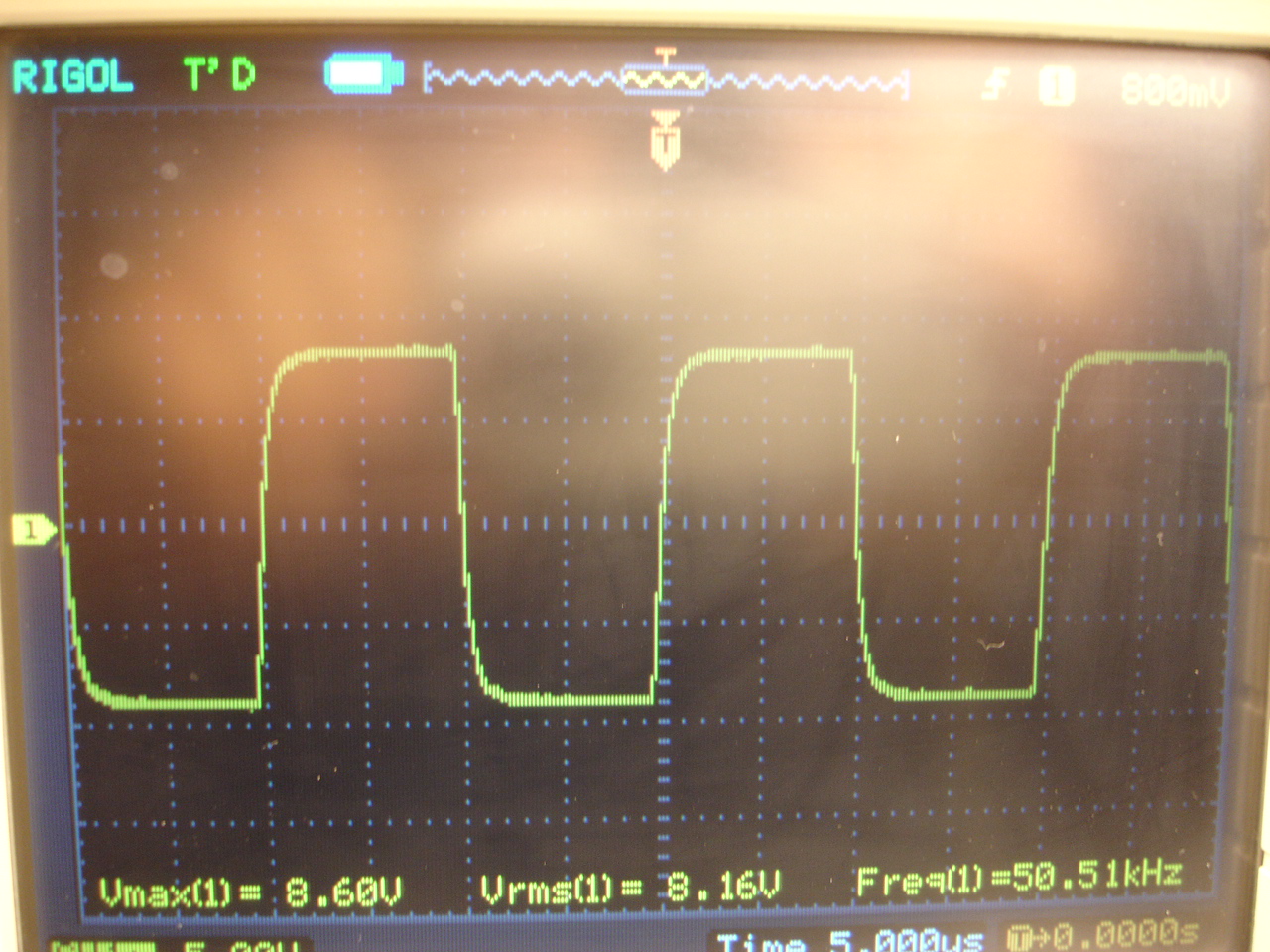

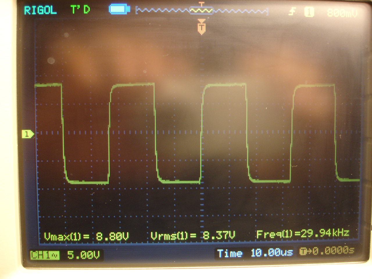

calor gold measurements.
Power suplly +/-30v
33.000uf/rail
R dummy=7R
Idle current =800mA./pair
1v RMS input give 20v RMS out./7R dummy=26db
20v RMS/7R=57W RMS just before clip.(1000Hz)
