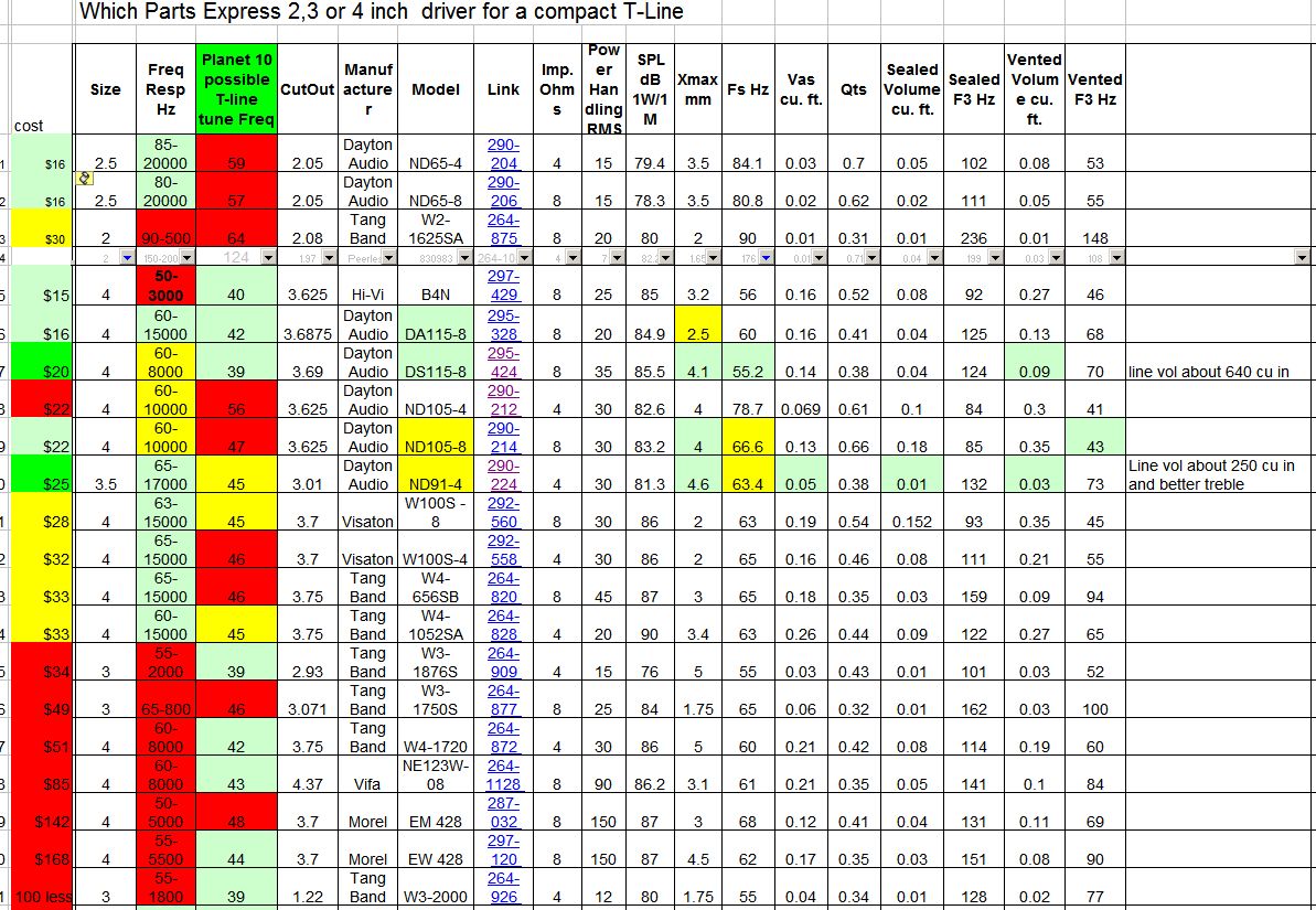

First, the attachment in 19 is a little off. I pulled in a table of data from Parts Express but when I went to one of the drivers, that driver page was different than the table. The updated table is below.
There really is no specific goal, just designing the smallest taper T-line that has a f3 of 40 hz. There are two speakers on the table (bright green in the 2nd column) that I think will meet the 40 hz with some circuitry. And not a lot of volume either - from 250 cu in (about 4 liters) line volume to 640 cu in (about 11 liters.) That will make a pretty small box. See the past posts on how it might be done.

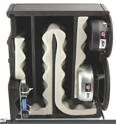

Great! They do it with a 6.5" driver. I knew it was possible to get under 40 with a T-Line that is less than 1200 cu in. I think we can do it less than that with a 3 to 4" driver because the line volume will be less with a smaller driver. The difference is the SPL and since we are going for near field, than that isn't going to hold us back.
Their smaller one about (700 cu in) has a 5.5" driver, with a line length of 66" for a 46hz.
But we should be able to do it even smaller with a more complicated innovative DIY design that commercially would not make sense.

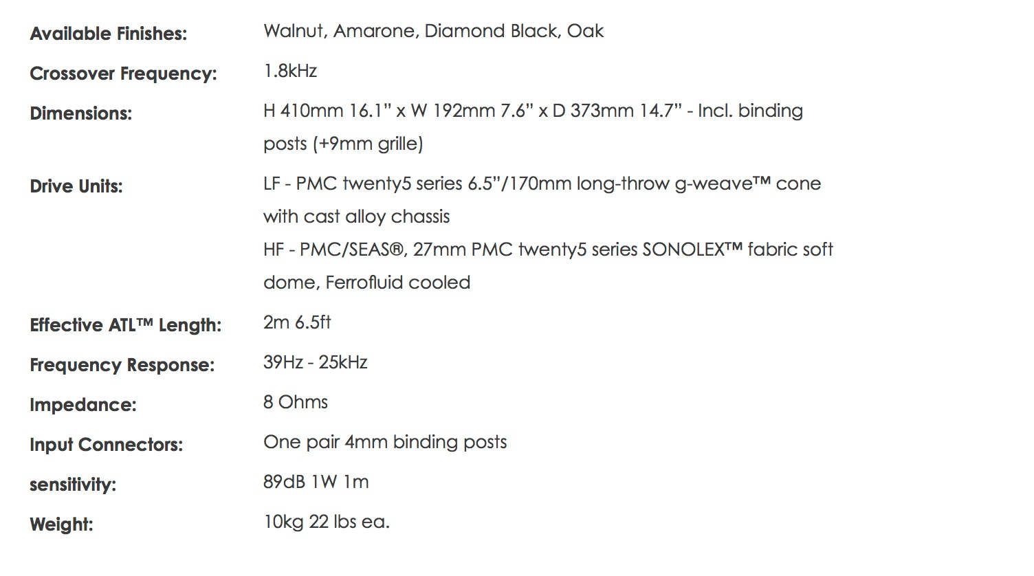

Not exactly small.
Dimensions:H 410mm 16.1” x W 192mm 7.6” x D 373mm 14.7” - Incl. binding posts (+9mm grille)
(ie 1800 in^3)
dave
Yes, not as small as I would want it but the size also depends on the size of the driver (among other things.) I think with a 3 or 4" driver it will be much smaller. Their 5.5 inch driver enclosure has an internal vol of around 700 vs the internal vol of about 1300 for the one above. That seems to have a trend so maybe a 4" internal volume for a near field tapered enclosure might get to 500 or so.

Maybe not because I used your formula in post 15, then looked up many parts express 3 and 4 inch drivers (result in post 22) and found one full range one that got down to 39 with several others around 45. I have a TB w3-2108 3" that has a fs of 45 so that will definitely work but it is not full range -
Do you think it is possible to hit 40? Remember, spl not an issue because of near field.

OK, that is good to know that formula might be too optimistic. However, I have read that a properly designed T-line has the possibility of reaching a 1/2 to a full octave lower than the Fs. If that is so, this goal might be able to be reached since a few of those 3 and 4 inchers in post 22, have a 55 to 65 fs and that fits into that 40 hz goal.
