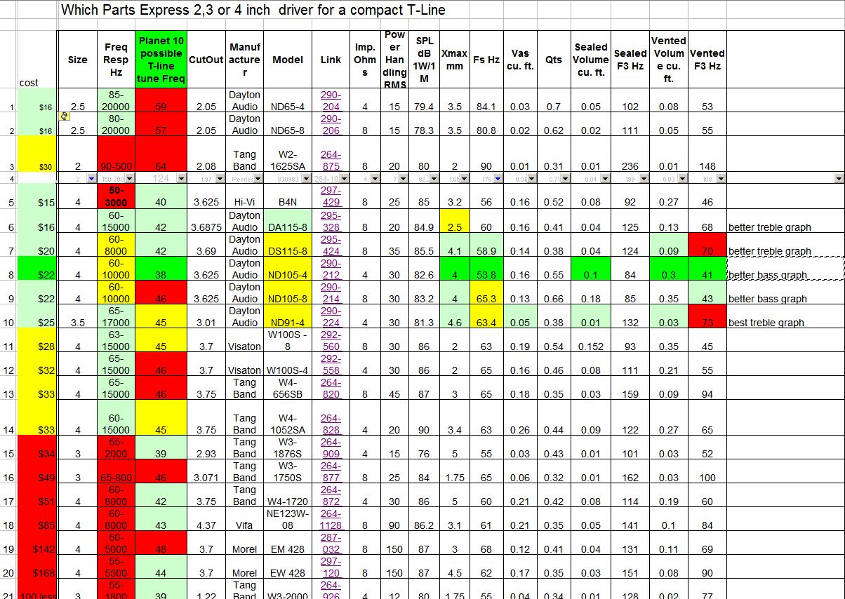

"What's this for?" Well, who knows - just a little exercise to see if we can design the smallest tapered T-line that will hit F3 40hz or below using new materials, innovative thinking about the enclosure, on board electronics and a driver under $25.
Let's decide on a driver - I have made a Parts Express table as a graphic below. I used Planet 10's formula (see the top green column) to see which 2,3 or 4" driver would have a chance to get to 40 hz in a T-line. The ones in green I think are the best candidate's with yellow = maybe. I think, but I need some experts to chime in, that the best one is the one in bright green in the 2nd column. Once we all agree on one of these under $25 drivers, then all who are part of this thread can buy one, then keep on reading this thread to get all the expert's ideas. Then we can all make the same enclosure or different ones and then we can compare the builds. Hopefully, we together, will come up with a really nice sounding, compact (under 1000 cu in / 16 liters) system with an amp and BSC/EQ circuitry. Xrk971 suggested I make the project more focused and hopefully I did it.
scott

Just saw your note - thanks for joining. And thanks for the suggestions.
Yeah, I know the bandpass is the best but then it is not full range with one speaker - I have a bandpass, two theater systems, two 15" subs, a sunfire sub, a floating dual person theater chair with two Tv's and two planar audio systems and about 50 speakers laying around. So what am I doing (sometimes I ask that too.)
