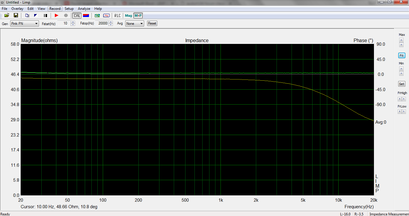

Merlin, it seems i have found where you picked your schematic.
From the wrong place!
AudioBlog: A simple loudspeaker measurement jig for ARTA
The guy has really no idea of whats involved in the calibration process. He seems to believe that the user is in charge of the calibration adjusting pots level so that he gets a plausible value for the resistor he is measuring, bla bla bla...
In fact the user does not have to do anything: simply let Limp calibrate ITSELF by using the Record / Calibrate menu.
In case Limp finds an imbalance >2dbs he will ask you to adjust levels because it cannot calibrates ITSELF well enough.
It seems that with the 1ohm resistor you have tried to follow its bad tutorial... These things happen following many bloggers...

Well after checking with my UCA202, i must admit that i have over estimated the need to do the calibration process setting the box in calibration mode, as explained in the Arta doc.
Even with the high reference resistor i use (100 Ohms) the differences i find are of a fraction of a ohm.
I still find the blog a bit misleading as it calls "calibration resistor" the "reference resistor" suggesting that this resistor and the volume controls play some role in the calibration process. The UCA202 has no vol control and works perfectly without.

But maybe Merlin's unit is defective. This should be more easily detected testing how it plays and records music, or making loopback freq measurements on each entries, etc...
If it has only been used for hard to believe measurements a couple of times, it's a bit hard to say if the unit is ok or not...
