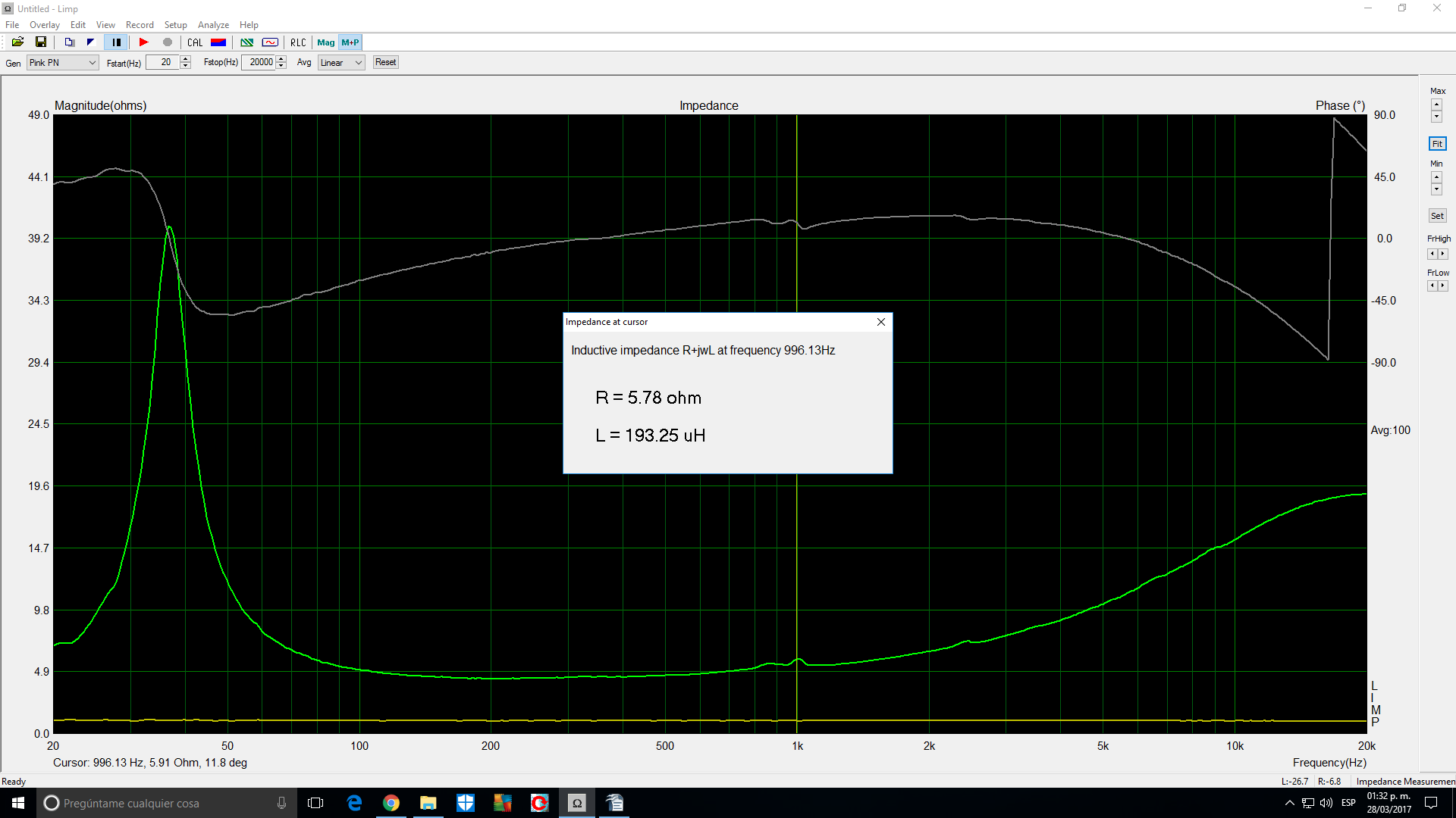

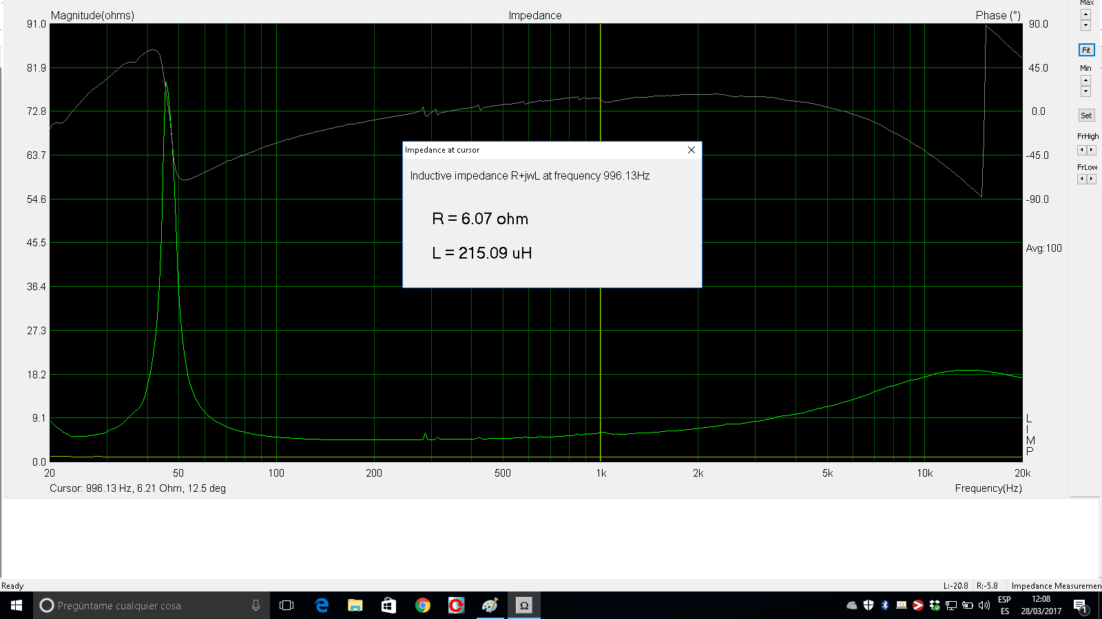

Calculating driver inductance from Limp
If the status in the calibration dialogue is "Uncalibrated", Limp will not be reliable, whatever you do with the volume controls...:smash:

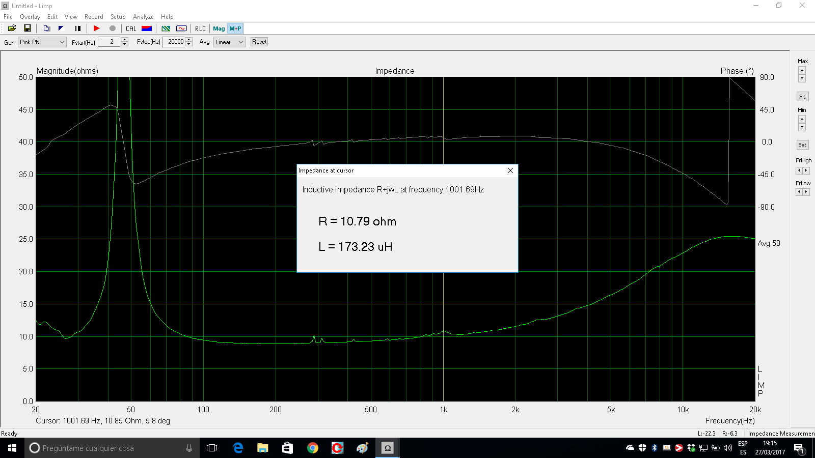

Lojzek is right, the reason I opened this thread is because I found differences between on line calculators and maths calculation to get Le at 1kHz or more. Thanks in special to VaNarn contribution post 7 21.3.2017 http://www..com/forums/multi-way/305547-zobel.html#post5026661 finding the impedance and phase of the speaker at the crossover frequency and solving for R=cos theta.Z and for XL= sin theta.Z http://www.diyaudio.com/forums/multi-way/305547-zobel-4.html#post5028875 The formula given was Cz= Ls/Rs^2. Later clones of this calculation in an attempt to flatten a speakers' impedance use Rdc or Re x 1.25 in attempt to correct for the nominal impedance (Z) of the speaker to suit a crossover network design. By example using a Focal 7N313 where the D.C. resistance is given as 6.1 ohm and the inductance as 0.38 mH ( at 1 kHz ?) the first formula gives Cz as 10.21 mFd and the latter as 6.536 mFd. Using the method outlined in my first post the impedance at 3.5 kHz ( the desired xover freq.) was found to be 10.34 ohms with a phase angle of 28.65 degrees. This gives the effective resistance as 9.0742 ohms and the inductance as 0.2254 mH . Calculating for a network to give an impedance of 8 ohm with the phase at 0 degrees in conjunction with the speaker, resulted in values of 10.67 ohm and 3.69 mFd. It is a pity that many sources still keep quoting the wrong method of correction and so many people have been caught by this misapplied Zobel network.
