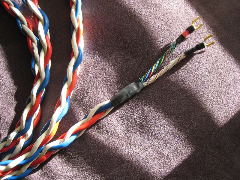

I made these 12AWG speaker cables from two runs of CAT3 (afaik, same geometry as CAT5) and two runs of stranded CAT5 patch cords with the intention of getting lower inductance cables at the expense of higher capacitance. They are not difficult to make (compared to some other twisted-pair schemes), and CAT3 can often be found as surplus.
One day soon, I hope to measure their R, L, and C per foot and compare against some other types I have.
