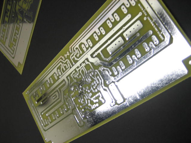

PCB's
Hi Mike,
Those pcb's are the DHR.... Dx High Resolution Turbo amp pcb's I made.
See this other picture I've attached.
Yes I can make pcb's from pdf files and many other file types.
Contact me through email if you require an exact quote or any other info
Ta Ajay
