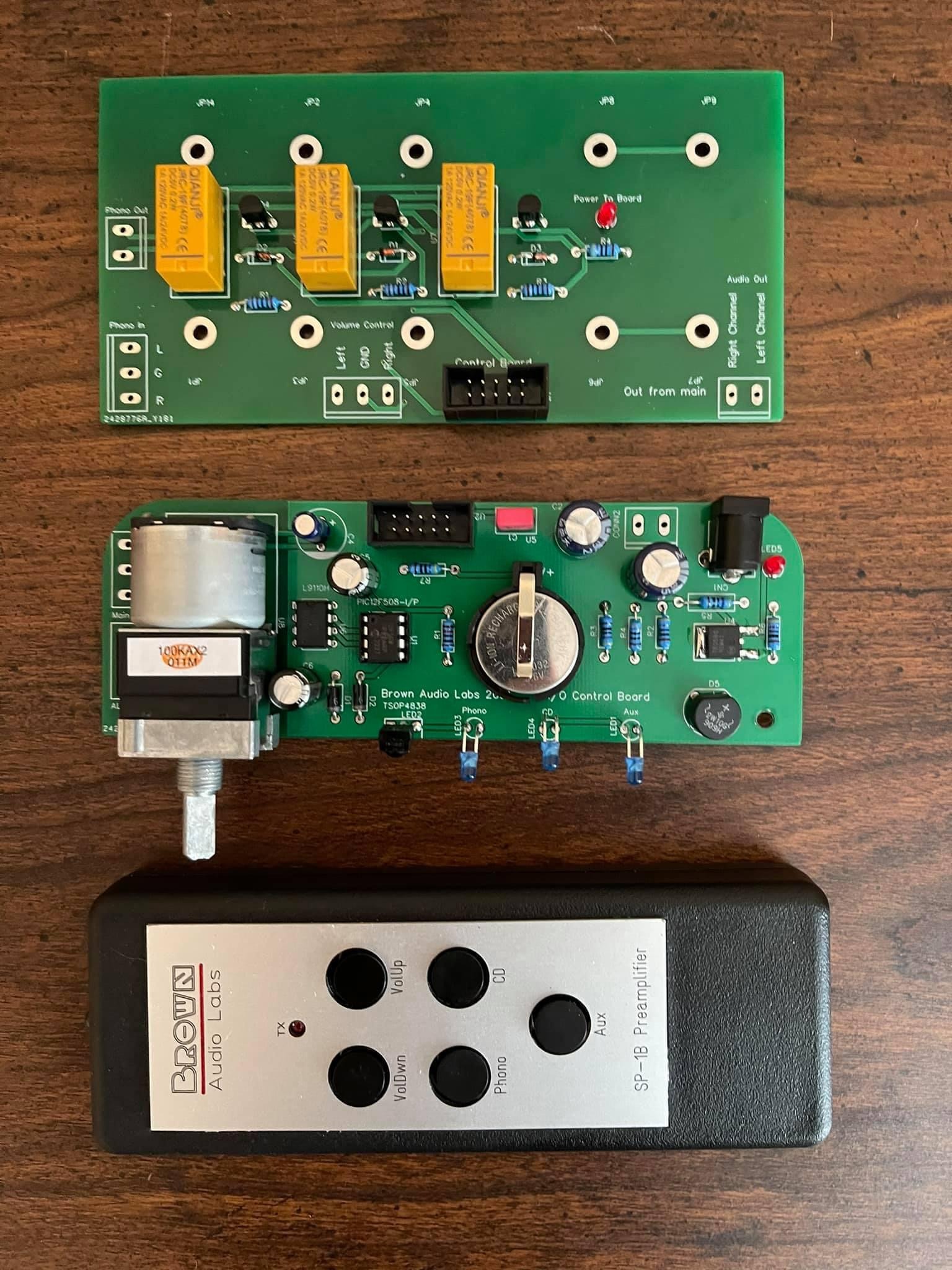

I have a few C files and some in ASM that I use to program PIC12 chips for controlling a ALPS motorized pot, I havent worked much with digital potentiometers.
I have a setup below, I also have a 3 channel selector in this one, this setup uses SIRC protocol.

I suppose the chip would be remotely controlled, using a PIC with IR capability, or an Arduino.
Yes, the chip will recieve its commands via the "3-wire-serial-control" from some MCU runnning the application-logic, be it an Arduino, RP2040 or a PIC. The library can only help you to generate the necessary commands.
If/how/when these commands are transmitted to the attenuator is left to your application. You can use the SPI library for your MCU to realize that. @jpk73 showed an example how to do that on Arduino on this post, but it would look (not exactly but very much) the same for other MCUs.
Hi @denny9167 ,
I'm still not sure what you are trying to accomplish and how to help to get there. Can you elaborate on that?
I see you have a TSOP4838, which i expect to receive the infrared-signals from the remote-control. It decodes the infrared-waves into a digital signal and feeds it into a PIC12. Your application-logic decodes the transmitted data (according to SIRC specification) and from that results a remote-control-code/"number", which will tell you which button on the remote was pressed.
Based on this information the PIC12 will then increase or decrease the volume by controlling the motor of your ALPS. If you want to replace your ALPS with a digital attenuator, you need to replace the motor-control with the digital commands to tell the attenuator what to do. So instead of letting the motor rotate X steps/seconds/degrees to the desired volume-level, you just send the desired value to the Muses-chip.
This library will generate the digital data you have to send. How to send them was shown by @jpk73. For simplicity of implementation you can use the SPI-library for your PIC12. I think you have to add it via Microchip Code Configurator / MPLabbX IDE to your project. It helps to have a logic-analyser or oscilloscope on hand to check the signals on the three control-lines and test if they look like as described/pictured in the datasheet.
