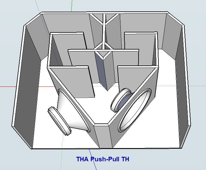

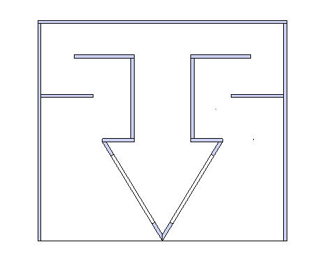

Thoughts behind My hasty lunchtime sketch.
The layout is stepped. No attempt at tapering the sections was made. This would make for a simple build for a complicated box layout. Each concentic section could be made from 4 identically cut parts.
The horn shape is fairly inflexible, I adjusted the overall width to get approx 615cm sq for S2, approx 2 :1 compression for an 18" driver. A compression ring / spacer would be needed to allow for driver Xmech.
With the simple steps, first and second section would be aproximately equal .
Third section doubles the area
Fouth section doubles again, and is the S4 driver area.
Final expansion doubles again if the horn mouth extension is used.
Each expansion is actually more than double as the proportion of the area ocupied by the timber reduces with each section.
Careful adjustment of the panels could tweak the areas / expansion ratio.
Sneaky bit is the 45 deg angling of the sections - this increases the horn length as the path crosses diagonally from section to section.
Regards Martin (Xoc1)

i measured my design diagonal ,path lengt wil be aprox 3.4 mtrs .
for me thats a bit to low.
what exacly wil that cavitie in front do?.
i was thinking putting the mouth pannel flush to the front.
just need that depth for the speaker.

note this is the square sugested by martin.
just moved some numbers around to get a flat to 35 or so
cab 80x80x80
were just brainstorming here
so i put martins idea in to a drawing.
i think we got something here.

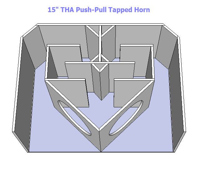

beautiful lady! epa new tapped horns are beautiful more than the past. i just hv designed as the same. love tapped horn with the sound but hate it when have the the problem when bend it. i try to design push pull tapped horn like this but still can't finish. i hope will finish if not i will want ur help with my desu\ign. thanks 4 the pic friend.
tnx thawachbeautiful lady! epa new tapped horns are beautiful more than the past. i just hv designed as the same. love tapped horn with the sound but hate it when have the the problem when bend it. i try to design push pull tapped horn like this but still can't finish. i hope will finish if not i will want ur help with my desu\ign. thanks 4 the pic friend.
drivers position in the point in the pic maybe wil cause problem.
the pressure maybe to high where the cones are closesed to eachother.
imho

thank for the reply epa. i just have finish it. hope that it works . the volume drv around 70 litres .

adjust a little, try to draw the drivers with the real scale. okay make me satisfy.
cool
One more cool Th design.
