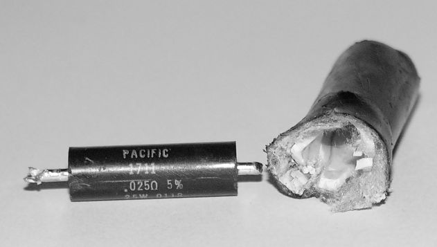

Okay, well just spitballing this around. If the shell is what gives the quantum aspect to this, I'm just curious if the shell's inside diameter, outside diameter or even some region in the middle has been doped to be an n-p junction, or n-p-n junction or some combo of junctions.
Whether anything like that is even possible to manufacture, I don't know. What effect it would have on a signal passing through the slightly inductive resistor, I don't know either. I'm just guessing.

They aren't patented. The myth is that they are classified technology (which is utter nonsense). The reality is that the disclosure would demonstrate clearly that it's a fraud, which would have saved Cal Weldon a couple hundred bucks and me quite a few hours of measurement time confirming that the little gizmos do nothing other than enrich Jack Bybee and give John something to tweak people about.

Shell? What do you mean?
The white ceramic tube which surrounds the slightly inductive resistor. The ceramic tube itself is covered with some packing material and then a black plastic sleeve.
My guess is that some part of that tube-the inner circumference, the outer circumference or somewhere in between-might be a pn junction. I have no idea if it is possible to manufacture a pn junction like that, but that's my best guess about making the device quantum.
