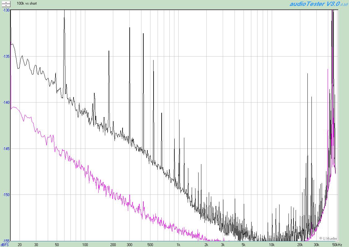

That's a fair point- I've been rather demotivated because of how... mundane the results were. Here's a few more dribs to chew on. It's been said that the Bybee will reduce noise in a circuit by some sort of "slipstreaming" and "stripping of quantum noise." Putting aside the clear violations of basic thermodynamics, let's see if it actually does.

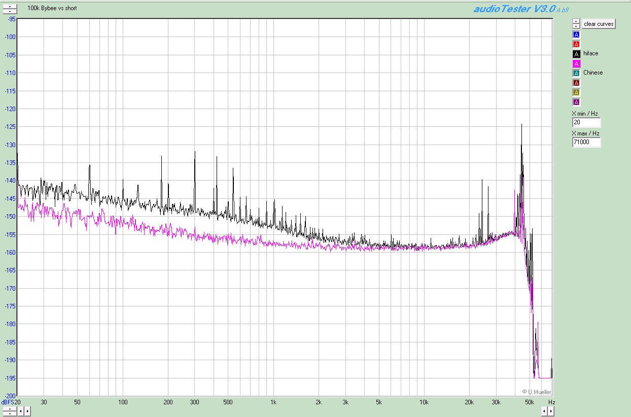

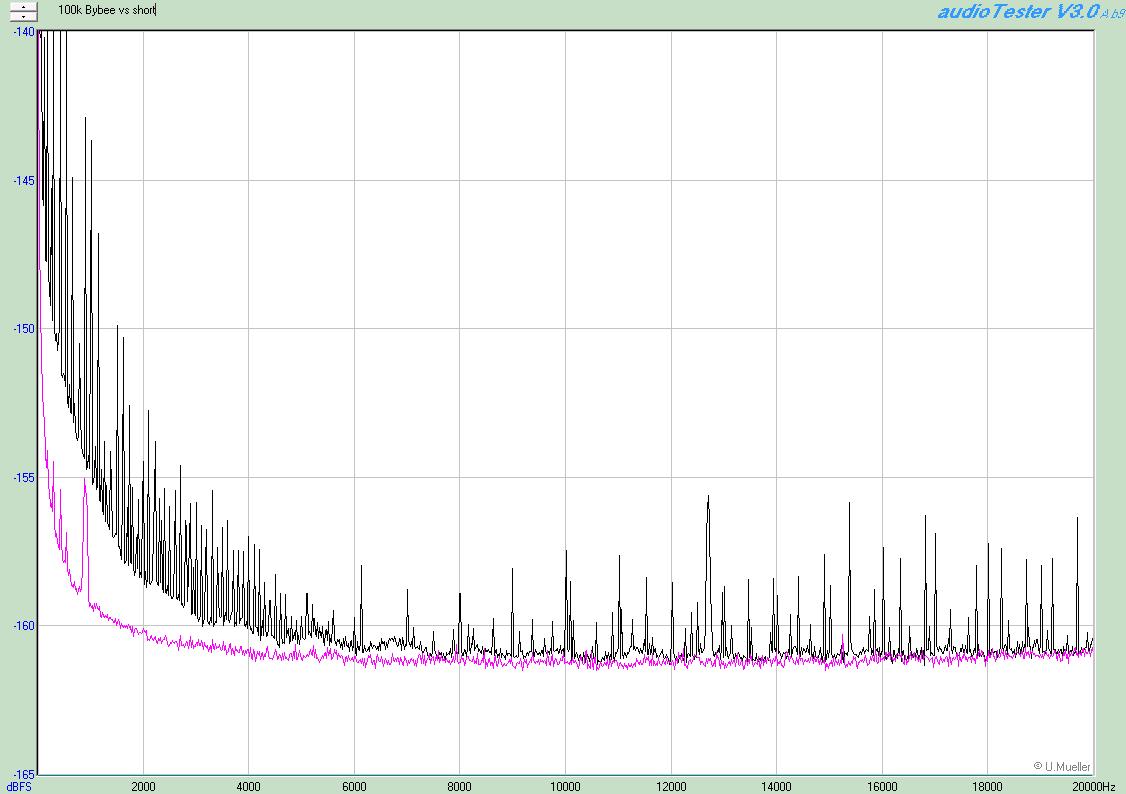

First, as a baseline, I compare the noise floor of the measurement system with the input shorted to the same system with a 100k resistor across the input. This is in a relatively electrically noisy environment, but still those alarming spikes and other noises are still pretty low.

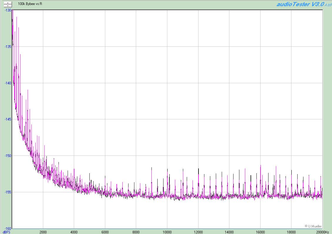

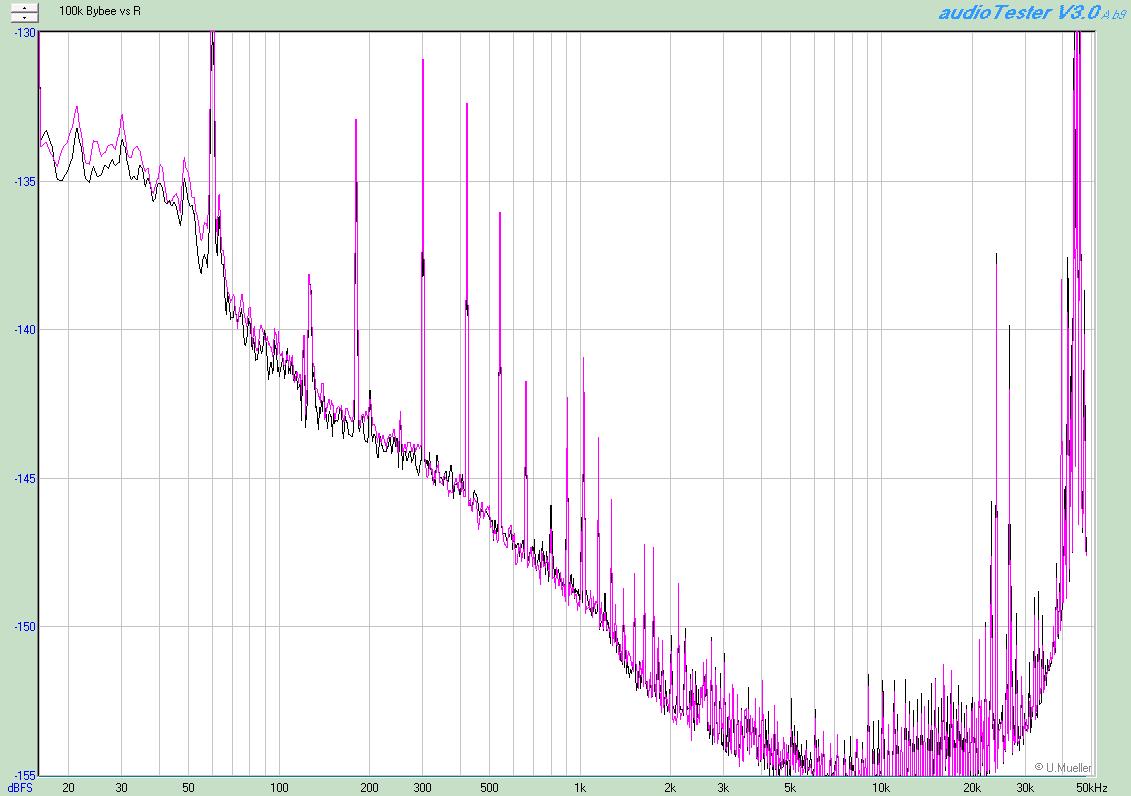

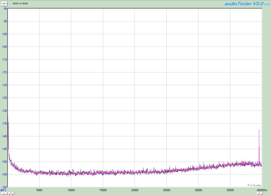

OK, fine, is the Bybee having an effect? Here's a comparison of the Bybee in series with 100k versus the 50 cent resistor in series with 100k. I show both linear and log plots. If you can see any sort of consistent noise improvement, you're better than I. And, again, if you want to worry about stuff below -150dB and at broadcast frequencies, have at it- it's irrelevant to what's going on in the region where our ears work.
More later.

Hey SY,
Thanks for these, I know that we all have been anticipating the results.
Just to make sure that we're all on the same page, could you please give us the legend for each graph?
I'm assuming that the title of the graph (top-left) represents the order comparisons and black always means the first plot while the purply-pinkly(ish) colour means the second plot.

My M-Audio box has an input impedance of 20K, what is it for your setup?
ES
For this measurement, 20k (which is why the noise floor is what it is). For some measurements-to-come, I use a home-made interface box with a 1M input impedance.

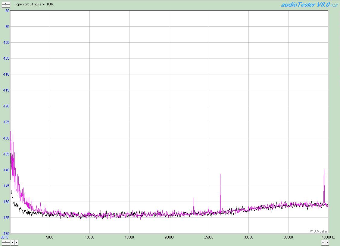

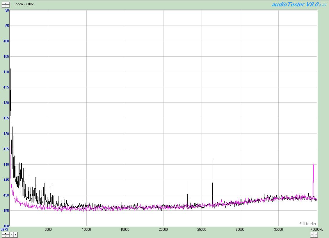

That is what I thought. I assume in addition to shorted noise level you also did an open circuit reference. Could you post that?
Also useful is the equivalent measurement bandwidth.
I slowly get more familiar with the quirks of my various tools and so know when to ignore something (In the old days the noise spike from the horizontal scan frequency) and when something stands out. It is harder for me to read others results with just a few samples, so thanks for putting up with my questions.
