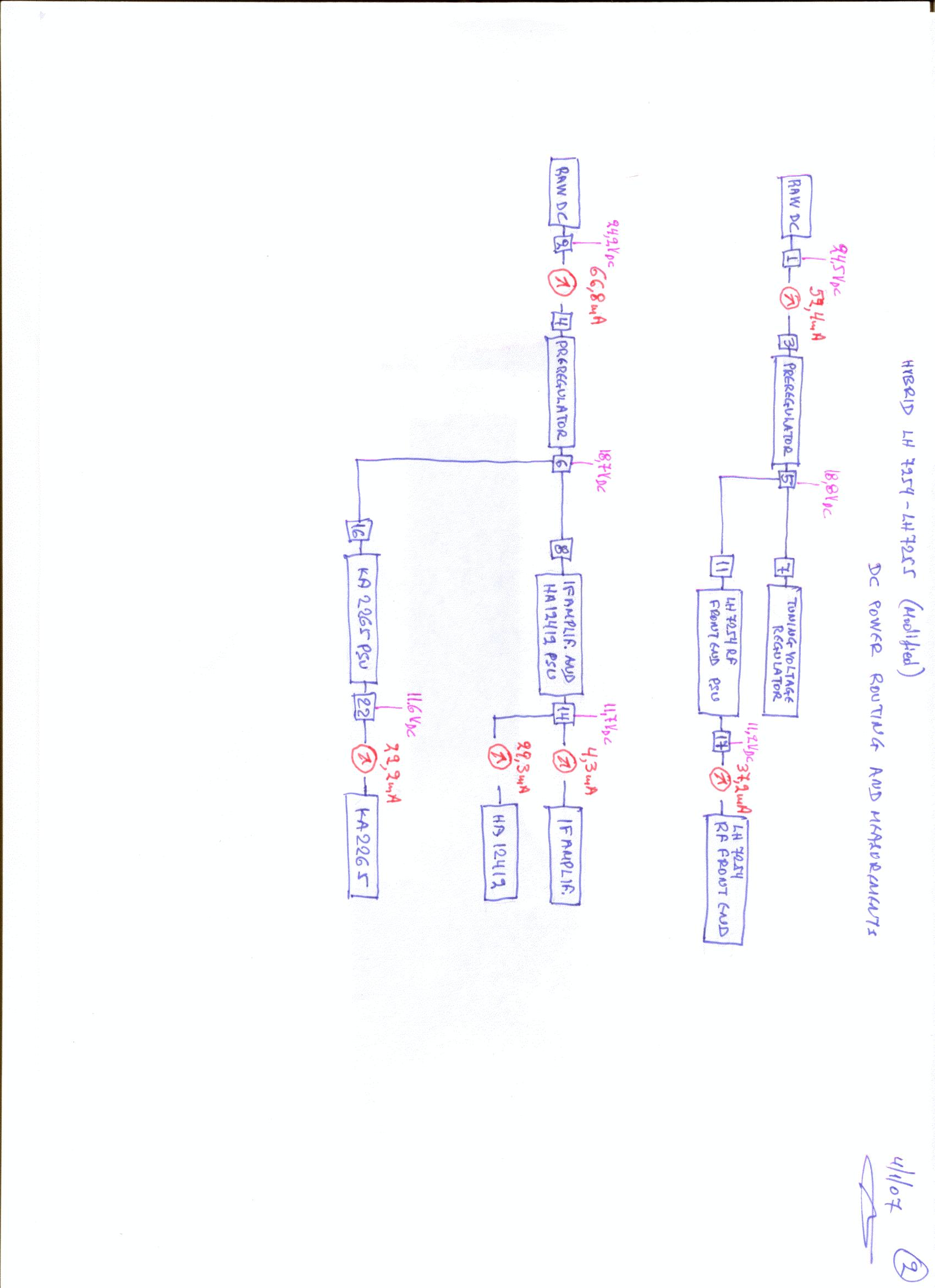

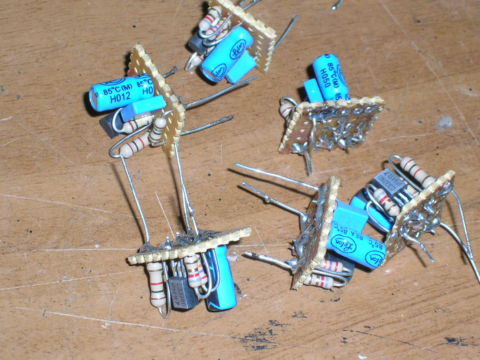

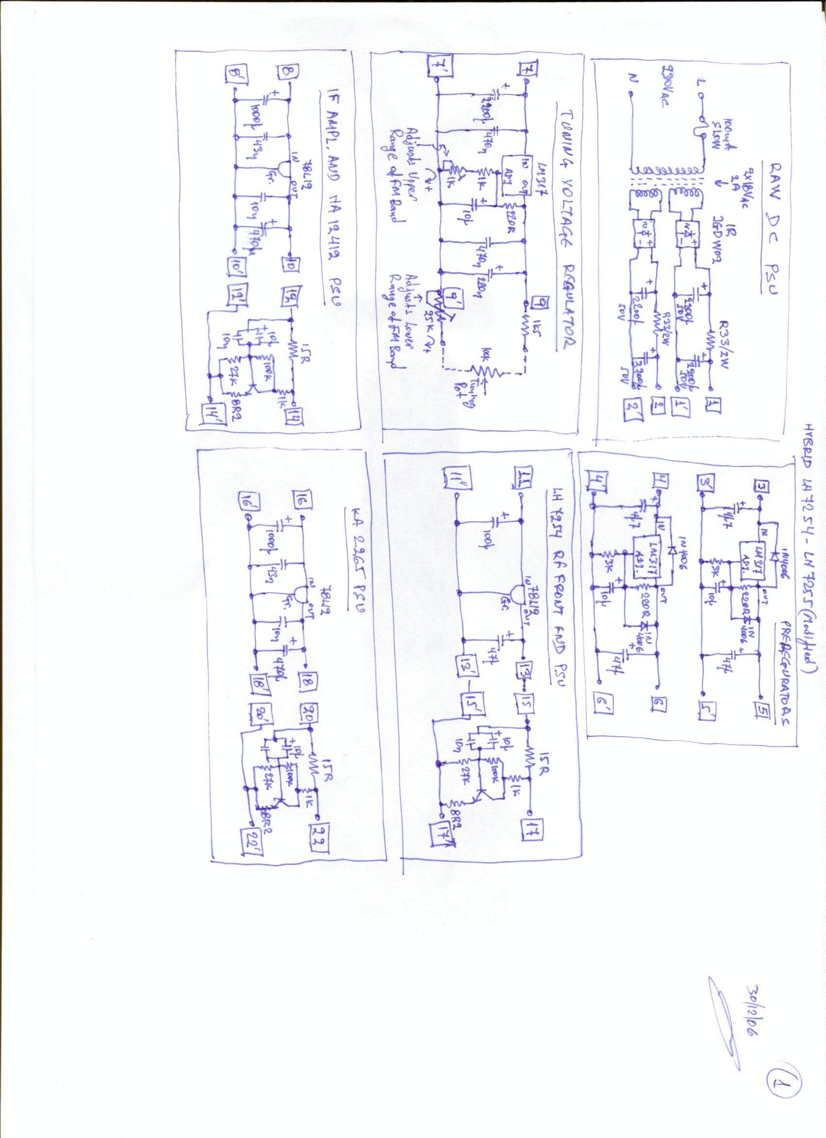

Chris, I have built several one-transistor "Clean-up Shunt"Finesse Voltage Regulator Noise!
as small add-on modules. Three of them are in an FM tuner I built end of 2006.
http://www.diyaudio.com/forums/analogue-source/8089-fm-am-tuner-8.html#post1112711
I could try measure their “clean-up” capabilities if anyone is interested.

Sounds like a cool idea. You will probably need an AC signal amplifier for the noise to be more visible on a 'scope. That's if your supply is reasonable to begin with. I have played with similar circuits, and the one in my reference. They work very well, but it wasn't important to measure the amount. I just noted that is was effective. In situations like these, the amount of effectiveness varies depending on a number of factors. Certainly the way the grounds are run may reduce the effectiveness of any supply cleanup attempt. They are worth including in a design where power supply noise will have a detrimental effect on circuit performance. Serious shielding of the circuit you are supplying would be a natural extension to reduce radiated noise. An MC phono amp comes to mind for the audio hobbyist. In test equipment, the uses are obvious to me and should be to anyone else familiar with the concepts.
