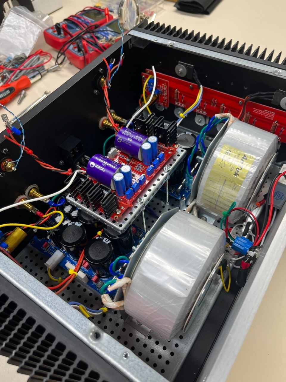

I don't like leaving my questions I post without conclusions in case something in them is helpful to others. I had posted on 9/12, post 2413, some questions. The official conclusion to them is that I had one bad transistor in the cap mx section the SLB power supply which led to too high voltage on one rail. Overall, my power supplies deliver 34.2 volts instead of the 32 I was planning for, so I'm addressing that with a RC in series/parallel with each rail on the FE board to bring the voltage into a safer range. The voltage regulators I had bought on Amazon were too cheap and hardly reliable. Last, I had an odd pulsing noise coming from both output stages which was fixed after I replaced the output transistors. Maybe one day I will figure out which ones are bad out of the 12.
Anyway, enjoy some pics of my amp (with its art deco faceplate) and the system it is powering. Best bass so far from anything I own, dead slient with the Smooth as Butter power supplies, -extremely- transparent. Wide, deep soundstage. I can even hear the floor of the recording venues sometimes now! These speakers are not the highest end that I have, so there’s much more to discover. The preamp above it is a BA-3 FE as well.
