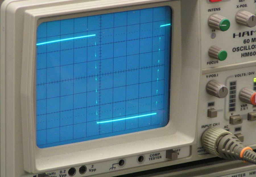

-ecdesigns- said:Hi QSerraTico_Tico,
DI DACs have zero ringing (linear interpolation / no analogue filtering)
can you show scope picture?

Yes, I was wondering what causes those "steps" or glitches.maxlorenz said:We can see 8 "steps" or spots on the vertical lines

Hi QserraTico_Tico,
These are interpolated samples, placed between the original samples (DI8M has 352.8 KHz output sample rate).
The sample amplitude is also interpolated, so each single amplitude step is now subdivided in 8 equal smaller steps. That's why the 1 KHz square wave transients are subdivided in 8 smaller steps.
The interpolation method used, provides a slow rolloff linear phase filter
