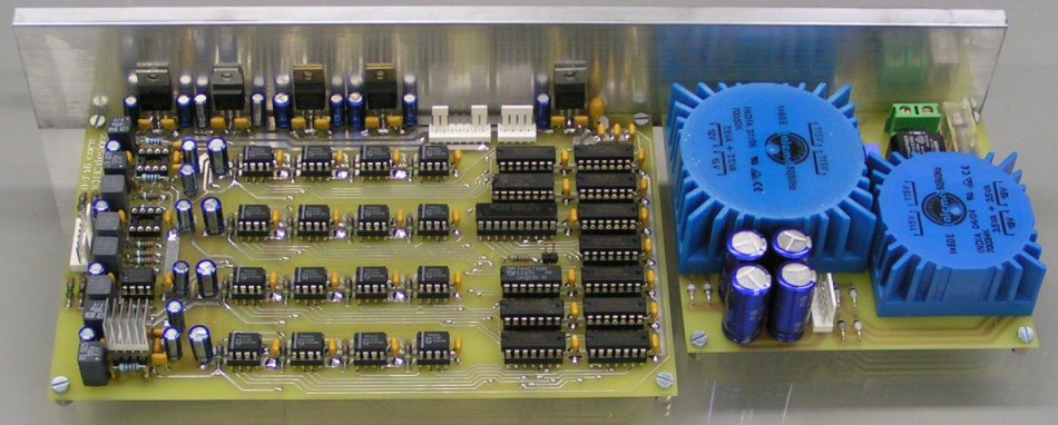

Hi all,
Project update, the D-I 16 core power supply is ready.
I added a photograph of both the D-I 16 core and the small power supply I designed for it. I used 2 separate encapsulated torroidial transformers to reduce power dissipation (low voltage for logic and TDA1543's and higher voltage for the OP-amps). Like the octal D-I DAC power supply, mains voltage selection is integrated (jumpers). The power supply PCB is single-sided. If desired, a relay can be mounted to provide remote ON/OFF function, if not, a wire jumper can be used instead like on the photograph. The rectifier diodes are fast BYV26E types (1KV). The power supply has a integrated mains filter.
In the background is one of the 8mm thick aluminum side panels of the new housings, it will also be used as heatsink. These side-panels will be used for all projects, the octal D-I DAC, the D-I 16 DAC, the control amplifier and the mosfet power amplifier monoblocks.
I am planning to modify the USB interface, I am going to integrate a automatic I2S switch, providing a external I2S input, and some logic to control the indicator LED and logo backlighting. The output is single-ended I2S, so it can be directly connected to the D-I 16 core. This module can also be used in the octal D-I DAC, greatly simplifying it's design. When using the USB interface as a separate module, it already outputs a single-ended I2S signal and provides a extra differential I2S input, in this case only a 5V supply has to be provided to power the I2S buffers and the logic. The USB input has the highest priority and overrules the differential I2S input.
Next on the agenda is redesigning the octal D-I DAC power supplies, making them more compact and simplify them where possible. I also need to redesign the tube output modules, placing the tube sockets on the component side and reduce PCB dimensions.
I am also considering using the mixed mode exclusively as this definately produces the best sound quality by far, this way the analog output attenuator module can be left out as well. Now the system controller can also be removed, again simplifying the design.
By these redesigns, the octal D-I DAC can be made less complicated, while still providing exactly the same sound quality as the prototype. If desired, the D-I 16 core can be placed in the large octal D-I DAC housing as well. Now the D-I 16 core can also have a mixed mode output.

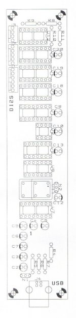

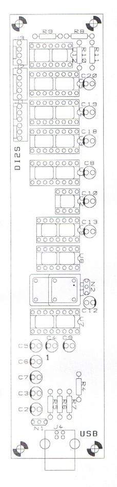

New USB module PCB design ready
Hi alleycat,
Thanks for the compliments [post #1137]
The relay on the D-I 16 power supply can only be controlled by a external device like a control amplifier. If this setup is not used, the relay is not assembled and a wire bridge placed across the relay contact connections on the PCB to enable power. The D-I 16 DAC still has a mains switch of course. The USB voltage is only used to toggle beteen USB input and the extra differential I2S input automatically, the selected source is indicated by a multicolour LED on the front panel. When pulling the USB plug, or switching-off the computer, the octal D-I DAC / D-I 16 DAC doesn't produce a click or pop, with the new USB interface, it also immediately switches to the external DI2S input.
I finished the USB/DI2S/indicator module PCB design today. Now the automatic input switch and indicator LED control are also integrated. I added a silkscreen plot of this new module. So the complete D-I 16 DAC will basically consist of 3 modules:
- The D-I 16 power supply
- The D-I 16 core
- The USB/DI2S/indicator module
Using the same technique for the octal D-I DAC would limit the necessary modules to:
- The octal D-I DAC main power supply
- The octal D-I DAC core (11 small PCB's and one analog mainboard) or the single PCB D-I 16 core
if the mixed mode output is also added:
- Tube diff. amplifier module (both channels will probably be placed on one PCB)
- Tube power supply

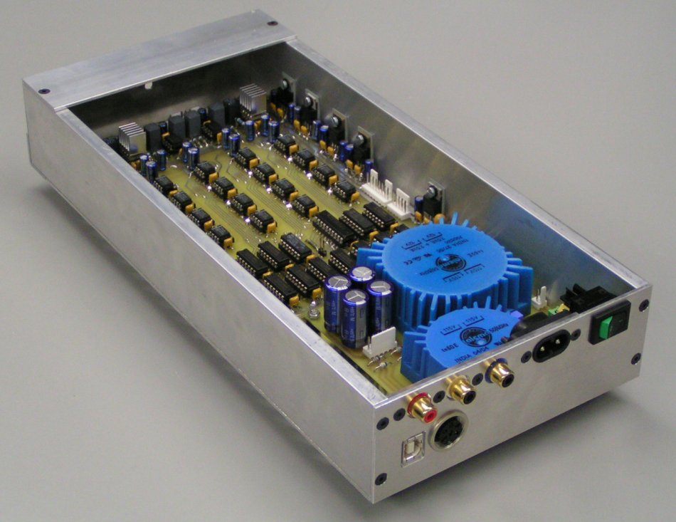

Hi all,
Today was a good day for designing and building housings, for the D-I 16 DAC that is. I added a photograph of the D-I 16 housing. As you can see I just managed to fit all modules, connectors and switches in. It's a very compact housing. The side panels are made of solid 8mm aluminum, the other panels are 2mm thick aluminum. The feet are 20mm diameter and 12 mm high, they are turned out of a tough black coloured plastic, acetal copolymer. They have adhesive rubber discs mounted to avoid scratches. The front panel is made of 2 aluminum profiles and a high-gloss stainless steel sheet.
At the rear, there are the RCA sockets for both right and left channel (red and white), and the RCA socket for remote power input (blue). Below the RCA sockets is the USB connection and the DI2S connection. Further to the right are the mains connection and mains switch. The RCA connectors are mounted on a transparent polycarbonate sheet for insulating them from the chassis.
The power supply PCB is mounted on top of a transparent polycarbonate sheet as well, preventing any contact of the PCB connections with the housing. All voltage regulators are mounted to a aluminum side panel, to ensure optimal cooling.
I still have to manufacture the new USB PCB that fits on the left side panel, and a small PCB for the LED indicator and logo backlighting, that has to be mounted behind the front panel.
