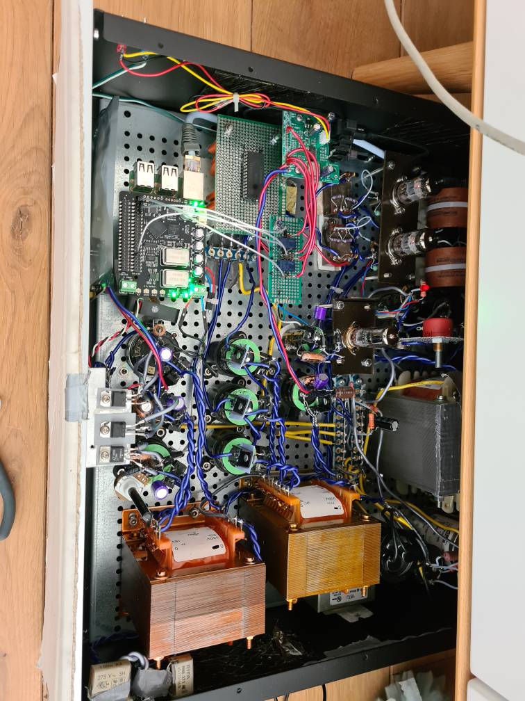

Seeing this thread just now. Didn't read all the thousands post[emoji54]
Build also a dac/streamer around a tda1541a with tube output stage. 20200602_131418.jpg
