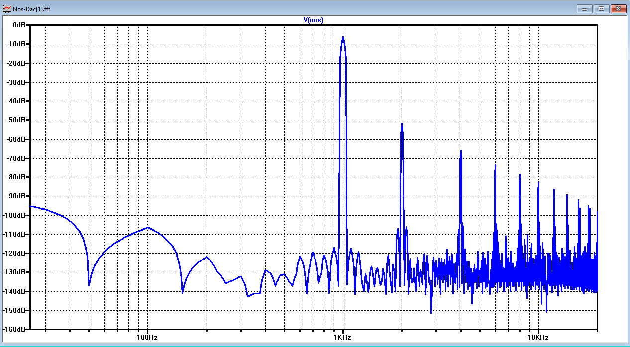

Hans,
How would you suggest to tune the amplitude. The one suggested by John, does not work. He suggested to put 150 Ohms on each of the two outputs (+ and -) and then sample the signal with two 1 Kohm resistors and then trim the 150 Ohm I/V resistors . Yhis does not work. The two outputs have to be conneceted directly. See post #7093-7094 and 7095.
I have simulated what John has suggested and compared the result to a perfect single +/- 4mA Dac.Hans,
I1 represents this perfect +/-4mA Dac, producucing output V(out75).
I2 is the negative going Dac, producing signal V(n002) and I3 the positive Dac, giving V(n003)
In the upper halve of the image, I have given Dac I2 a 4mA max output current and the other Dac I3 5mA.
Resistor R2 has already been adjusted from 150 to 120 Ohm to get the proper output swing, but as you can see, beween the green curve from the ideal Dac and the Blue curve from the compensated Dac there is still an offset that has to be adjusted.
By adjusting R5 from 2850 to 2280 Ohm, the offset has been adjusted and the blue curve V(out150) fits again perfectly on the green curve V(out75).
So you have to adjust two resistors.
Hans

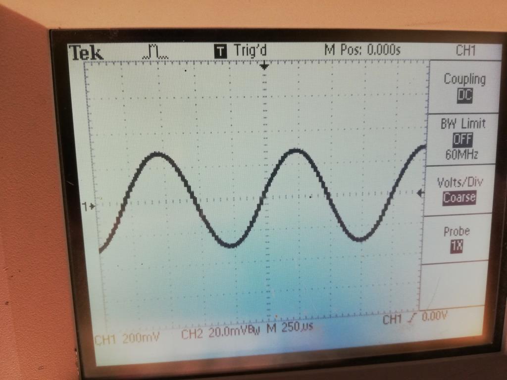

So to try to find an explanation for this behavior, and show how strange it behaves, take a look at this:
Pic 1:
This is the how it handles a FS , with one 150 Ohm on each output (resulting in 75 Ohm when shorting the outputs as John says), a 1,45 kOhm to 6,25V Vcc and the two outputs shorted together.
So about 4 mA ( well 4,3 mA) bias and that is all fine and good.
But what happens if I separate the two outputs?

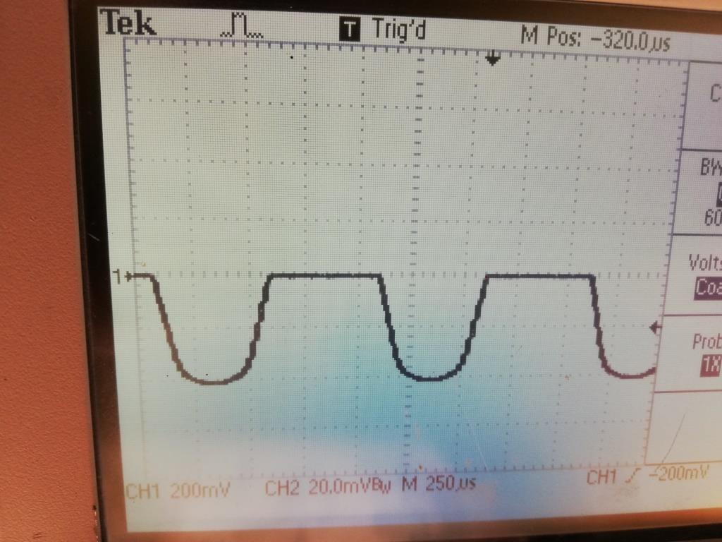

Pic 2:
This is the DAC output from the DAC that handles the positive portion of the digital numbers. Now with 150 Ohm to ground AND still with 1,45 kOhms to Vcc alas a bias of 4,3 mA to only this DAC (if I chance the value, the baseline is no longer 0V)

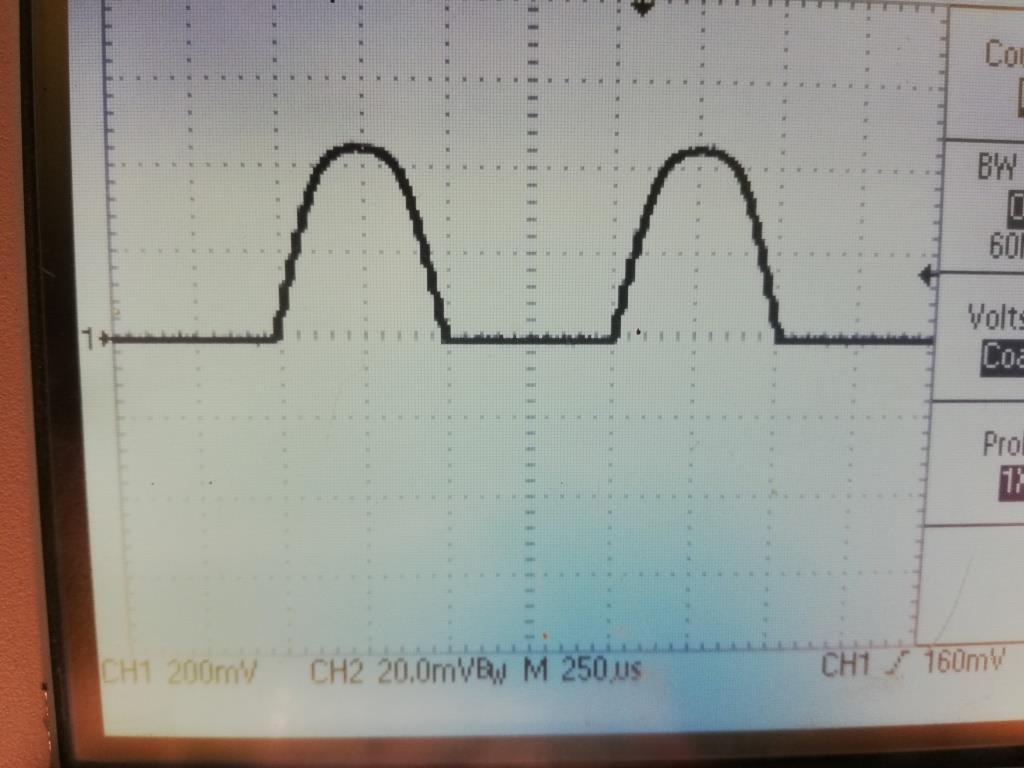

Pic 3 :
This is the DAC output from the DAC that handles the negativ portion of the digital numbers. Now wit 150 to ground and NO bias.

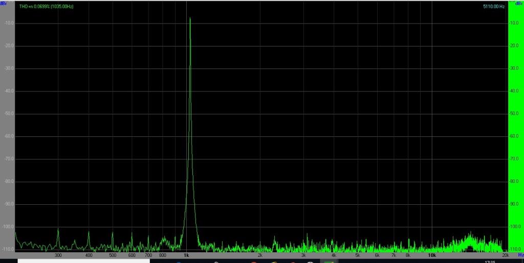

What a coincidence. I have just finished some trimming and measurements, and sat down to post it, when I saw your post
I am not sure I see what you want to do with two in parallel. Could you elaborate that a little or perhaps a schematic?
What I have done is this.
I put trimmers in both bias and I/V resistor in all 4 dac's (2 tda1541A) .
I initially adjusted all the I/V to excatly 150 Ohms and all the bias resistors to 2mA (3,15 K @ 6,3V).
The result was not very good. A lot of even and uneven harmonics. Then I adjusted the bias resistors (long time, they interact) and by this I could trim the uneven harmonics to -100dB. Then I trimmed the I/V. This reduces the even harmonics. Again interacting , not with the other dac but with the bias setting, and that makes perfect sense. I only had a 100 ohm trimmer (in series with a 100 Ohm resistor) and this is way to coarse. But I managed to get to the result in the picture. Pretty impressive right?
This is a -6 dB signal. It clips at 0dB.
