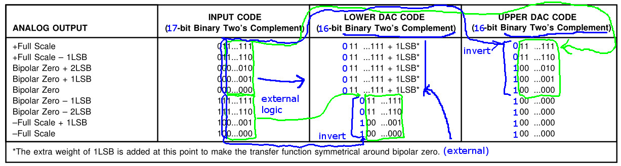

17-bit signal from 16-bit format
If I understand correctly (please correct me if I am wrong), we do the conversion the following way:
There is an "upper" DAC e.g. the left channel within the TDA1541, and a "lower" DAC e.g. the right channel on the same chip. This way the symmetry of the positive and negative half cycle of the analog signal is provided.
The MSB of the original 16-bit signal gets stripped off. This bit will switch between the upper and lower DAC, it acts as a sign bit indeed.
But each DAC needs 16-bit input, how is it done? My interpretation is that each 15-bit stream is shifted 1-bit left. The leftmost bit will be the "new" MSB, and it will change from 0 to 1 at half-scale in each DAC (-6 dB analog level, where music instantaneous volume is loud). But now the LSB will be empty, 0. My idea is that it could be filled with a random bit, i.e. with dither. So we get 16-bit signal again in both the upper and lower DAC, and their combination is a true 17-bit DAC. We lose the sign bit, it won't enter in the DAC (its function will change) but since it is missing, we complete the 16-bit format at the LSB with a random bit. Essentially we get a 17-bit converter where the LSB is dither, and this converter has double digital range, resulting in double analog signal level.
Serg, you are assuming a 16 bit digital input. That is where we differ.
If you only have 16 bits at the input then your segments are indeed 15 bits.
I am assuming a 17 bit digital input into the glue logic. The msb does not go into either dac, it just selects which dac receives the remaining 16 bits. We have two 16 bit segments.
The solution for outputting 17 good bits, with good dither, inside a 24 bit container, is done with a software player such as JRiver.

Lcsaszar,
Your reasoning (for a 16 bits input) is correct, just a couple of details about the logic:
1 - The state of the msb also determines whether one dac receives all zeros or the other receives all ones.
2 - The state of the msb also determines if the data must receive addition of 1 LSB or not.
If your source is 16 bits, you can only form two 15 bit segments and you gain nothing by adding a random lsb. Better leave the lsb alone. (Just remember you need to add 1 LSB to one of the segments).
Good dither is a game changer, but must be done properly. You need higher than 17 bits source material and a good algorithm. This guy knows what he is doing: Not Just Another Dither/CD | Airwindows
(I´d ask him about making a 17 bit version, very easy for him, this would be minor changes in his source code.)
