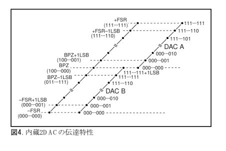

So, how you guys understand how the PCM1704 sign magnitude DAC work?
PCM1704 converts the input signal in the format of OB or TWC to USB format. In this case, two 23-bit segments are obtained from the input 24-bit signal inside the chip.
Guys, look at it this way. Suppose we have 17 bits of good data coming from the dir. The format is two´s complement. We convert it to offset binary by inverting the msb only.
Now, if the msb is zero then dac#1 gets all zeros and dac#2 gets the data left shifted.
If the msb is one then dac#2 gets all ones and dac#1 gets the data left shifted plus one.
Thanks,
Alex
Code:
-FS 0 0000 0000 0000 0000 (dac#1 and dac#2 get all zeros)
-FS+1LSB 0 0000 0000 0000 0001 (dac#2 gets the data left shifted)
BPZ-1LSB 0 1111 1111 1111 1111 (dac#2 is "filled")
BPZ 1 0000 0000 0000 0000 (dac#2 gets all ones and dac#1 gets the data+1LSB)
BPZ+1LSB 1 0000 0000 0000 0001 (dac#1 gets 0000 0000 0000 0010)
+FS-1LSB 1 1111 1111 1111 1110 (dac#1 gets 1111 1111 1111 1111)
+FS 1 1111 1111 1111 1111 (hmmm....)
