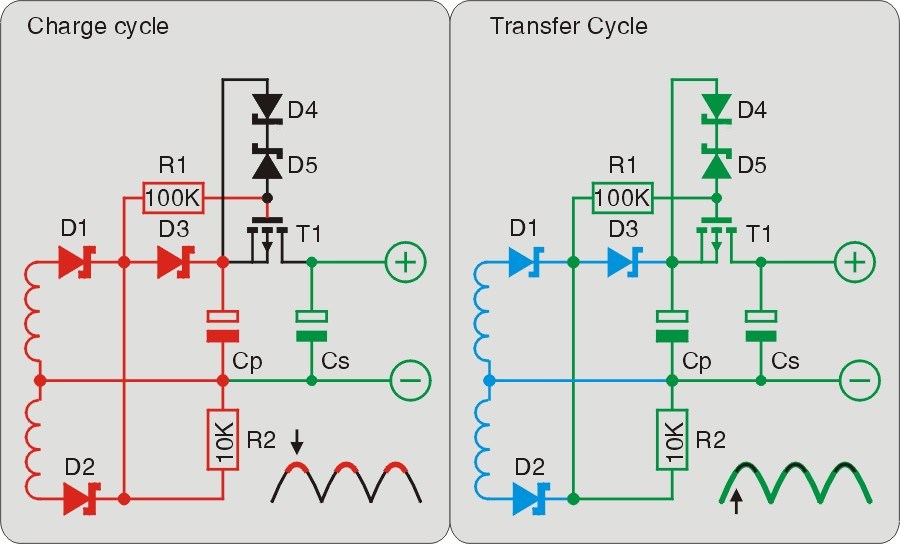

I still think of major disadvantages of the standard PS vs. battery.
1. DC saturated transformer
You need to have a DC-blocker in the mains path, otherwise you'll get
a saturated transformer, causing quite some degradation
2. The mains- sinewave is not a sine - it is a mess with quite some HF rubbish on top.
This will for sure have an impact on the transfer function.
How do you solve these issues?

Charge-transfer circuit schematics
Simply by using a charge-transfer power supply!
OK, I added a schematic diagram of a possible implementation (I currently use a similar circuit for testing it in the DI4T).
> First the primary smoothing cap (Cp) is charged with the polluted rectified voltage through D1 ... D3. R1 puts a positive voltage on P-FET T1, switching it OFF, and disconnecting the load during this charge cycle.
All interference surges through the primary smoothing cap -not the connected load- The severety of the pollution really doesn't matter at this point, main purpose is to get the primary smoothing cap Cp charged.
> Next the rectified voltage drops below the voltage across the smoothing cap Cp plus voltage drop across the rectifier diodes D1 & D3 or D2 & D3, now the rectifier diode no longer conducts, and interrupts the noisy charge current. All that remains after this interference attack is a charged capacitor. The P-MOSFET is not yet switched-on as -Vgs is still too low to make it conduct.
Now we have a floating charged cap (Cp), it's basically similar to a battery connected to GND with the minus terminal. Needless to say that all the interference signals during charging are not "remembered" by capacitor Cp.
> As the sinewave voltage drops, P-channel MOSFET -Vgs gets high enough, and T1 switches-ON. T1 now connects charged cap Cp to both Cs and load, the charge of the primary smoothing cap supplies clean energy to both Cs and load.
> After the sinewave voltage rises again, -Vgs drops and T1 is switched OFF. Now the secondary smoothing cap Cs continues to supply clean electrical energy to the load.
The cycle is repeated 50/60 times a second with half-wave rectifiers, and 100/120 times a second with full-wave rectifiers.
Both D4 and D5 (Zener diode and Schottky diode) are added for protecting the gate of T1.
D3 was added to create the required switching signal for T1. T1 is switched-on by pulling the gate to GND through both R1 and R2, the protection diodes D4 and D5 will limit -Vgs. T1 is switched off by pulling the gate to plus through R1.
The peak charge transfer current through Cs is limited by the P-MOSFET RdsON, but can be further manipulated by adding an extra series resistor in the drain lead.
Negative charge-transfer power supplies are very similar, just use a N-MOSFET, and reverse polarity of diodes and caps

Reminds me of the flying cap schematic posted by Jonathan Carr some years ago.-ecdesigns- said:

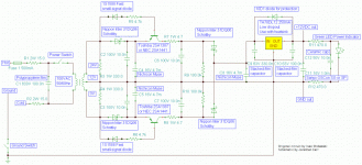

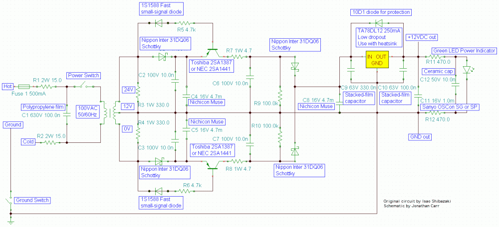

It looks similar indeed, but it requires more than twice the amount of components for the charge-transfer section. It might be slightly more efficient as it uses two secondary caps (C6 and C7) that feed the load.
I have doubts about the connection between transistor base and transformer, this could still inject (HF) interference currents through the transistor stray capacitance. Other problem is the voltage drop across the transistors (Vce). This voltage drop might well be in the range of a few volts, depending on connected load.
I use MOSFETS as these have very low RdsON (very little voltage drop across the MOSFET), and can handle very high charge currents when required (power amplifier supply). I can also use high Ohmic gate series resistors (reduces possible interference current injection through the MOSFET gate).
I am currently re-designing the charge-transfer power supply, by integrating a discrete ultra low noise voltage regulator + capacitance multiplier. If this works well, it's goodbye to the noisy integrated 3-pin voltage regulators. This would also mean that I could remove all 78XX and 79XX voltage regulators from the DA1541A modules ....

Hi pocoyo,
The problem introduced by conventional power supplies cannot even be solved by using the world's best hyper-low noise regulator. The problem is the direct galvanic connection between transformer that passes through mains (HF) interference and the load. By doing so, the interference currents also passes the ground routes. This way the interference current is added to the pure DC current of the super regulator, resulting in .... a polluted power supply for the load.
Super low noise regulators are usually tested running on a battery power supply while being placed in a metal box for screening. This already gives a hint about the problems that can be expected when running it on a conventional mains power supply.
So the super regulator is only a part of the solution.
I already experimented with 2nV root Hz regulators, and the problem persisted. The problem was solved when feeding the ultra-low noise regulator by a separate battery power supply, clearly indicating that the problem was caused by the mains power supply NOT the super regulator.
The charge-transfer power supply prevents a direct current loop (that carries all mains interference) between both transformer and load. Now the power is supplied by a "floating" charged capacitor, this is similar than when using a battery power supply. This requires at least two capacitors, the secondary capacitor that continuously feeds the load, and is never being connected to the transformer, and primary capacitor that is disconnected from the secondary capacitor while charging. So both load and transformer are never directly connected, this opens the loop, so interference currents can no longer flow (interrupted loop) and the ground routes stay clean (pure DC).
I use this regulator to my Shigaclone CD
maybe you can try it
