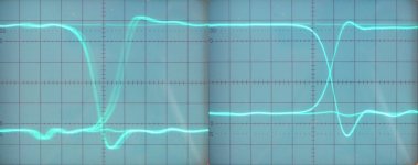

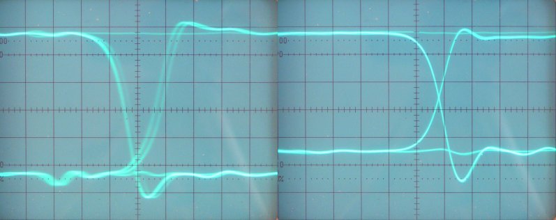

Yesterday I tested the SPDIF cleaner. This device takes an SPDIF signal (TOSLINK / COAX), and basically reclocks it using a second SPDIF receiver.
The cleaned-up SPDIF signal is then fed to a second SPDIF receiver chip that derives the I2S DATA signal from this clean SPDIF input signal, while receiving low-jitter timing signals from a VCXO and dividers.
So I now basically got 3 PLLs, one in the SPDIF cleaner, one in the SPDIF receiver, and one in the VCXO.
I attached an oscillogram, on the left is the output signal of a TOSLINK receiver connected through a 5 meter TOSLINK interlink with plastic fiber- optics to my Apple airport express module. On the right is the cleaned-up SPDIF signal that's fed to my DI4T.

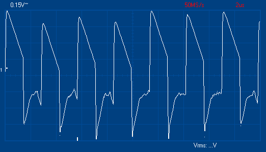

Again on DEM reclock
I have built ecdesign's DEM reclock. The output from the 74LS161 is fed to pin 16 through a 680 ohm/330 ohm divider and the 470 pF capacitor disconnected from pin 17. The signal at pin 16 is showed in the attached picture. Amplitude is less than 1 Vpp.
After the mod focus seems to be a little better, but prior the mod (470 pF directly soldered under pin 16 and pin 17, ultra-short connections), sound seemed a little cleaner.
Questions:
1) I could not find a 74HC161. Does the LS series have a lower performance in this circuit?
2) The signal at pin 16 looked instable and my scope (Velleman PCS500) did not trigger it for most of the time. It also had a slightly variable amplitude over the time. Was that signal suitable for the purpose?
Any comment?
Best regards.
Paul
DEM clock
Hi Sandor,
There are many factors affecting DAC sound quality, the DEM clock is only one of them, and can only perform correctly when the other circuits are performing optimally as well.
One thing is for sure, the original DEM clock oscillator shows massive data-related jitter way above 1ns rms. This translates to data-related bit-errors (active divider efficiency).
The 352.8 KHz DEM clock reduces this jitter to approx. 50 ... 200ps depending on BCK jitter and routing.
In order to achieve highest possible DAC performance, ALL introduced errors like distortion, crosstalk and jitter must not correlate to the audio data. It's better to have 1ns jitter with a "white-noise" spectrum than 100ps jitter that correlates to the digital audio data.
This could explain why TOSLINK producing lower jitter amplitude, but data-related jitter, generally performs worse than coax producing higher jitter that correlates less with the audio data.
Correct DEM reclocking enhances resolution by reducing bit errors (more accurate averaging in the active divider stages of the TDA1541A). As a result of this, other flaws in the DAC design may surface that need to be solved.
Routing is critical, GND return paths are critical. The 74HC161/74HCT616 needs a very low jitter clock. It could help to place a 100 Ohm damping resistor between 74HC*161 output pin and the wire that is routed to the DEM clock attenuator.
In general DAC lay-out is highly critical, and the routing of one single wire can already degrade sound quality. It's also important to use I2S attenuators for both DATA and WS signal (5K6 series resistor, 1K to GND, 3K3 to +5V). Crosstalk with the I2S DATA signal and other timing signals should be avoided / minimized.
Other problem is TDA1541A digital and analogue GND. DEM clock is referenced to AGND, the DEM clock generator is referenced to DGND. The correct DEM clock phase with respect to BCK is also important, so you could try inverting the DEM clock.
Finally the decoupling cap properties are very important when using higher DEM clock rates. I still have best results with BC components 470 series (stacked foil caps). Large "audiophile" decoupling capacitors have far too high inductance to effectively filter BCK and DEM clock pulses on the active divider outputs.
This also means that ALL decoupling caps need to have exclusive shortest (lowest inductance) path to AGND, every millimeter matters here. Most ideal would be soldering the decoupling caps directly between active divider output pins and AGND pin (so no other currents pass through the AGND decoupling return path).
Do realize that the frequencies present on the active divider outputs can be in excess of 2.8MHz, a large foil cap simply can't cope with these HF signals. Ceramics are unsuitable because of DC leakage currents, capacitance modulation, and drift.
