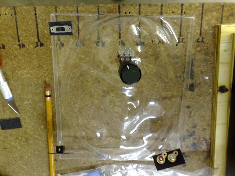

Hi guys.
I'm sorry to interject in what looks like a very long and interesting thread. I have not had time to read all 29 pages. Just from listening in on the last page and then looking to the first page...the injection molding of the wave guide caught my eye. The wave guide is the white round cone(ish) shaped thing at the top?
At the very real risk of being really stupid, this part looks perfect for vacuum forming. I have a small vacuum former that I assembled for about $30 and fits anything up to about 10-13 inches.
Once you form the shape from plastic you could easily reinforce it with fiberglass resin , maybe add a sound deadener to it.
Here are some pictures. I made a face mask with plaster and cast a positive off it, then vacuum formed a "face" plate for my amplifier...ha ha. Get it, a FACE plate! ha ha ha...(crickets chirping)
I told my partner, Jimmy, that I always wanted a volume control for his mouth...now I got one! Ha ha ha.. ba da dum!
Of course I'm probably missing the gist of the conversation, having skipped all but 2 of the 29 pages.
Sorry if this is totally unhelpful.
-Spencer
-Spencer

EXACTLY! Couldn't have said it better myself. Maybe even cheaper than EF. Looks like a winner. I was gonna suggest vacuum forming (it's how instrument panels in cars are made) but those involve the dreaded electroforming, so I kept mum.
I believe you're onto something there..
John L.
