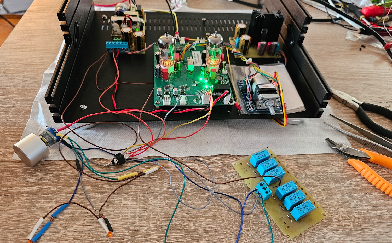

I have the board since many months, but I have so many projects, so it took some time to start with it.

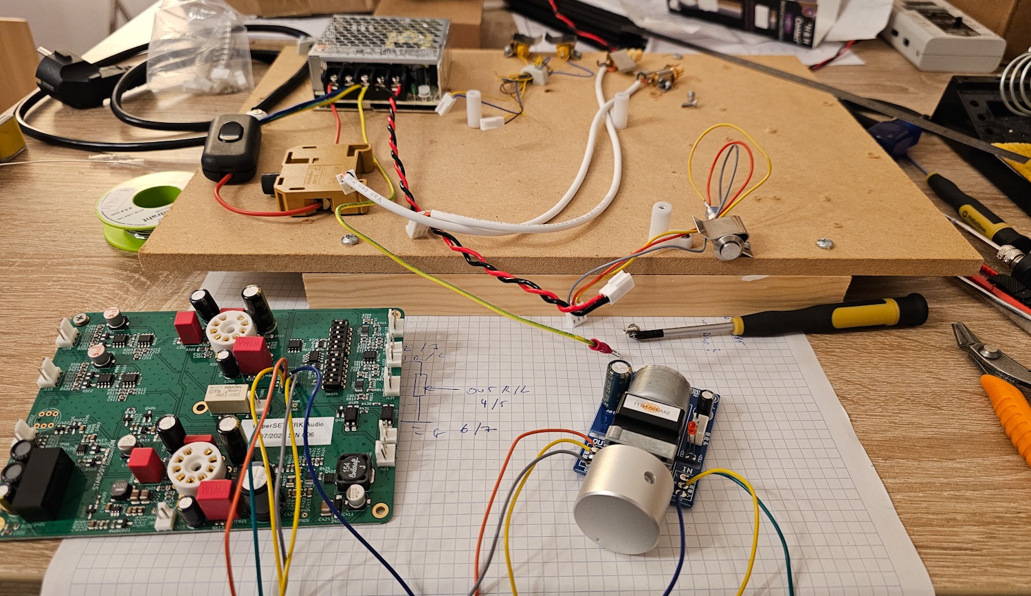

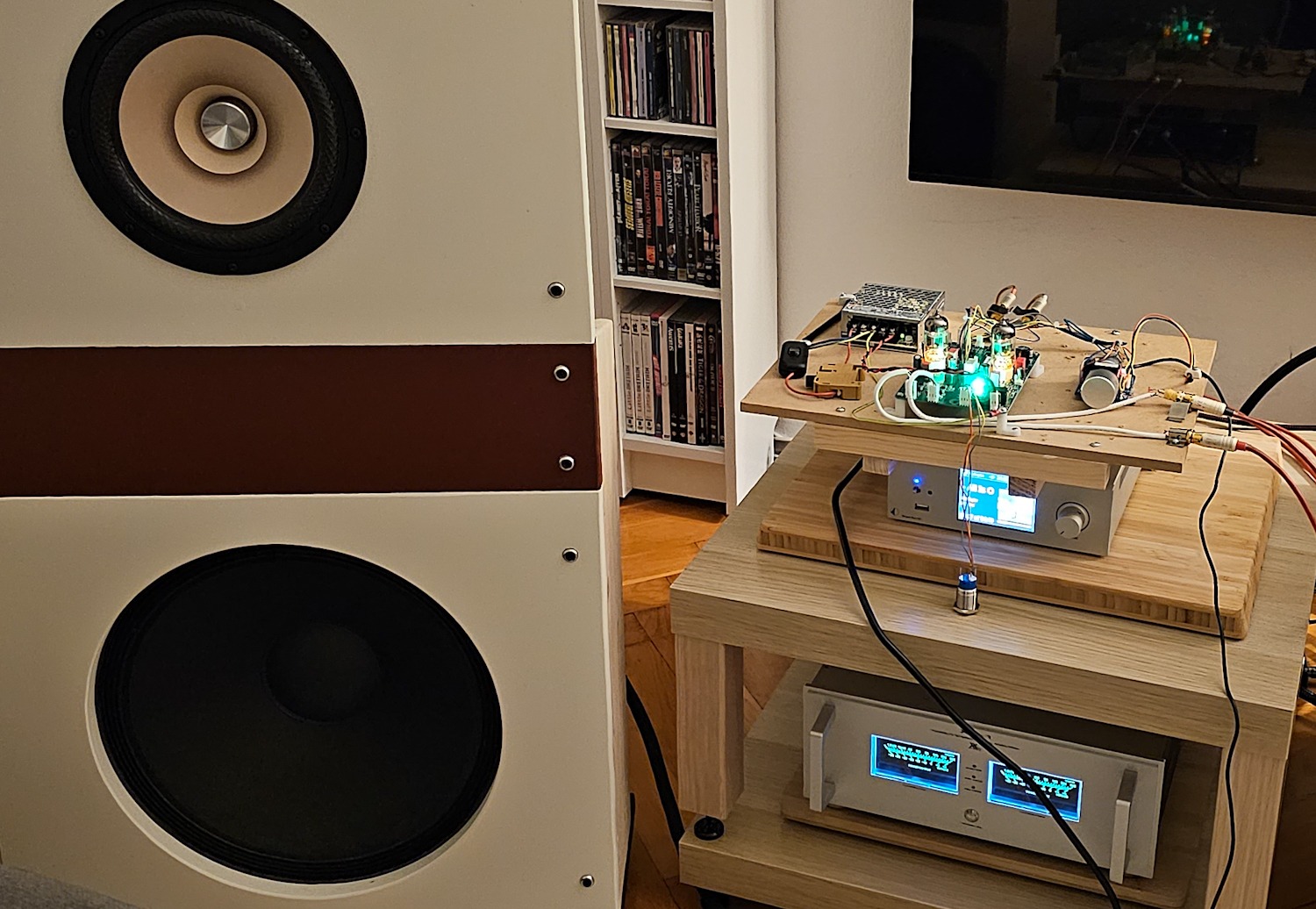

In the first step, I temporarily wired the board on a test bed to simply test whether it worked and of course to hear the sound.
And it sounded very promising.
So I decided to go all-in (or very-much-in).

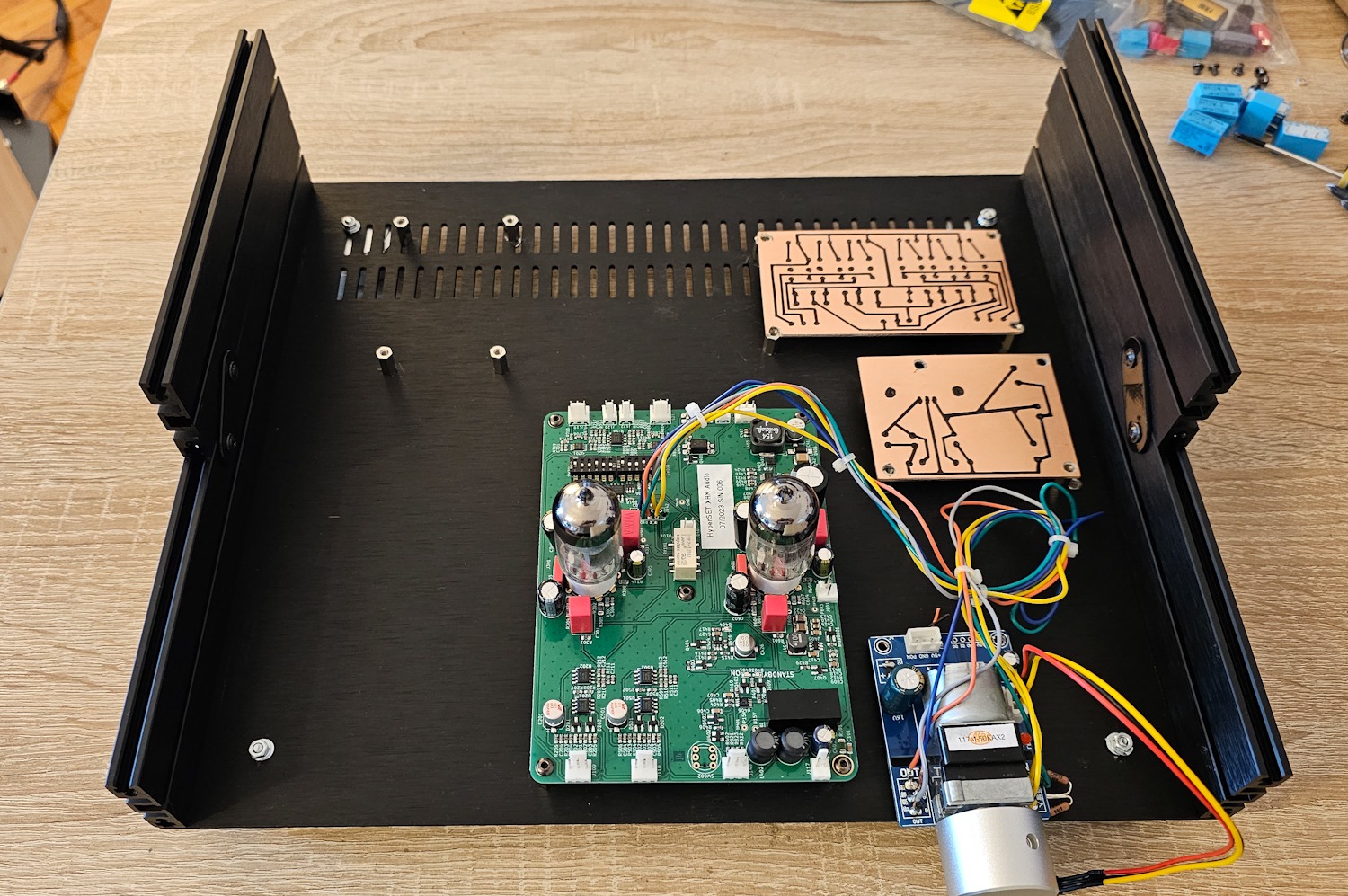

Chassis work began, but as it happens, more ideas came up during construction... volume with remote control... but then I need an internal 5v converter, so I have to make a pcb... input selector with RCA and XLR inputs, but then I have to make another pcb... I made my last pcb about 30 years ago... so I planned it the old fashioned way on paper, drilled holes in the board, then drew the conductor tracks with a permanent pen and finally etched them in FeCl3. Flux and cover with solder, done. It's a lot of fun and can be completed quickly.

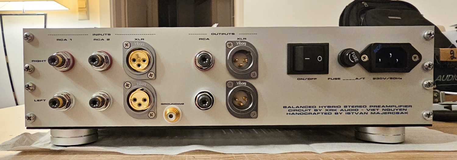

As you can see, the chassis is a combination of parts from @Gianluca and they will be combined with custom made front and rear panels.

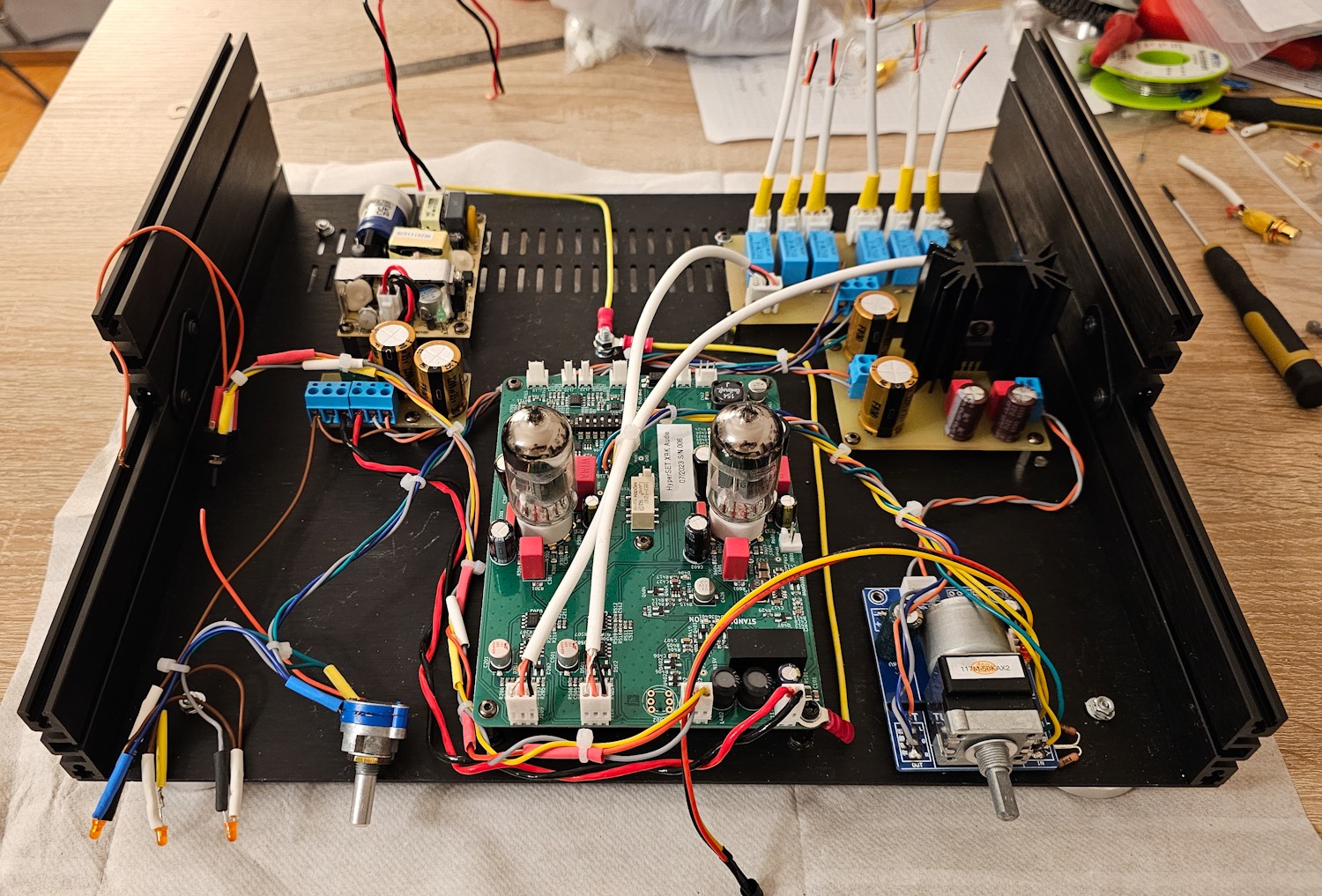

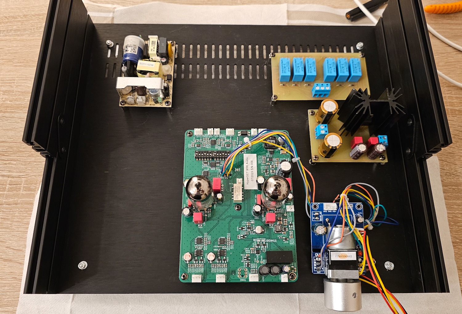

And here the current status from today: SMPS, 5vdc converter, input selector, remote control and amp board working great.
Next step will be completing the chassis, and wiring everything together. I enjoy this project very much
