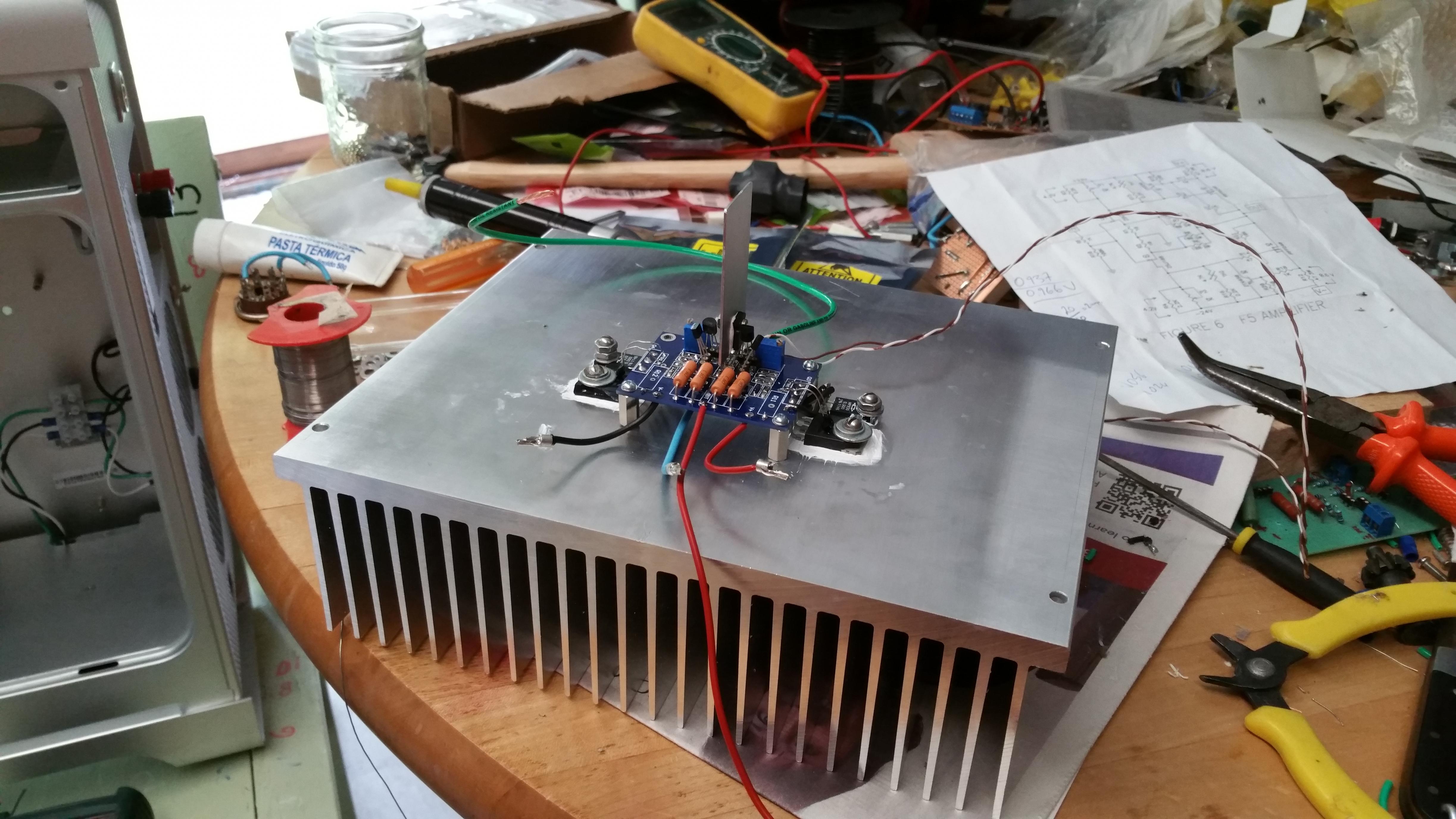

Hi Everyone,
Somehow other things got in the way of my diy efforts, so I haven't had anything to report for ages. However in the last few days I've got back to the F5 build, and here are some photos.

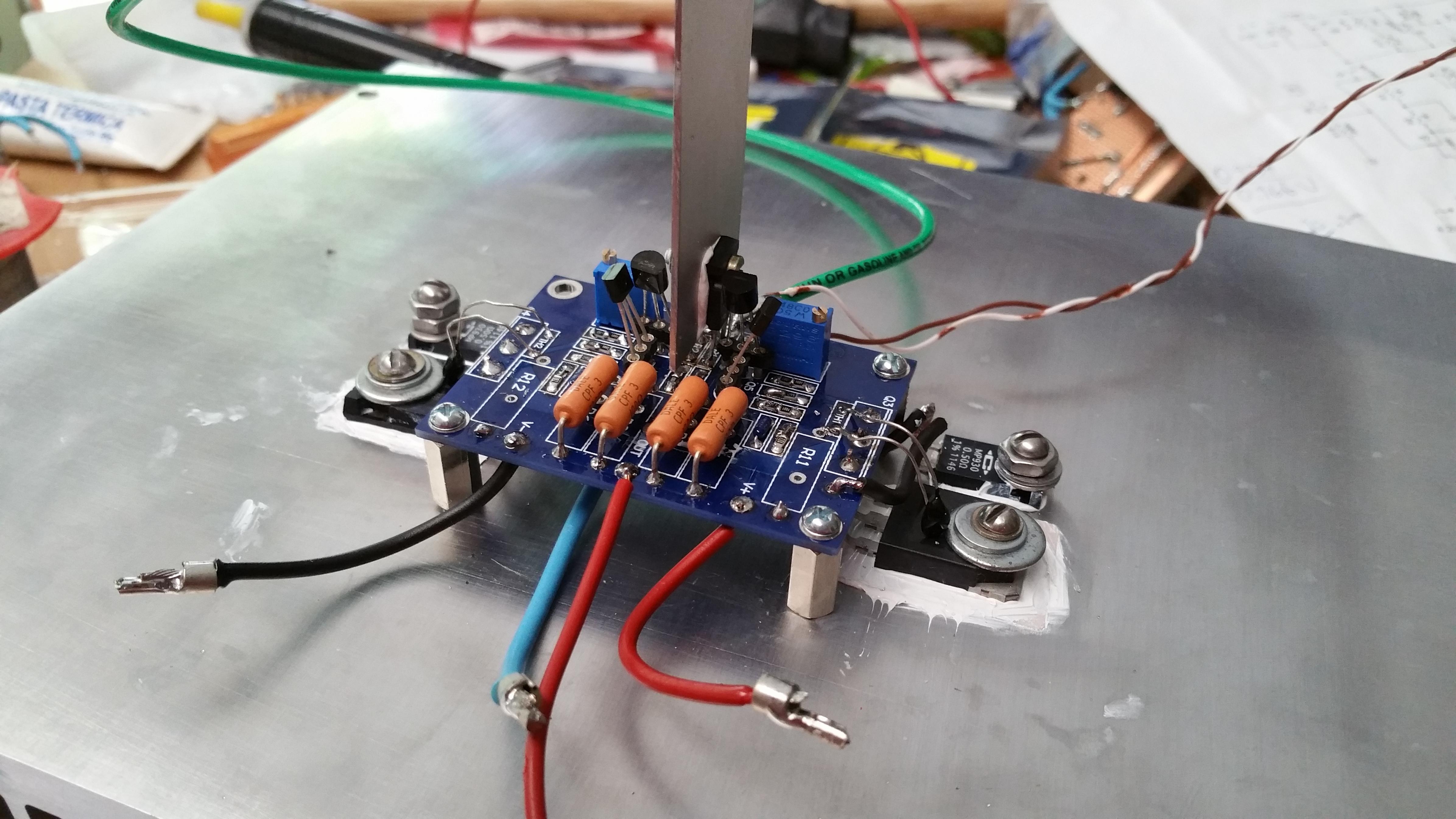

The third shows the hole in the side of the Mac case, where the output transistors and the amp board are fixed on the heatsink. I'm using some caddock MP930 for the source resistors on Q3 and Q4, so these are screwed down on the main heatsink also. The first and second photos show one of the not-quite-finished boards on its heatsink.
I made a couple of errors (probably through doing this while tired...) The first was messing up one of the tapped holed for the standoffs - meaning that on each channel the board is only on three, not four. In this case the board is so small I can't see it matters. (Very irritating, though...) The other was mounting two of the caddock MP930s on the wrong side of Q3 and Q4... (dohhh...) I intended to connect one leg of these directly to the source legs on Q3 and Q4, but this won't work on one side... Oh well. I don;t think it's worth redrilling and tapping two holes...
A question: I'm also using Caddocks for the 10R R1 and R2 on the jfets. I ought to put a little heatsink on them, and was planning on looking through my junkbox to find something. Does anyone have a photo of an appropriate size heatsink? If you look at the photo you can see I intend to put one heatsink for both. I had thought to use Caddocks for the feedback resistors also, but in the interests of getting these things running I think I'll use what I have on hand.
As always, any and all input appreciated.
Even 3 is probably over kill. Mine are hanging off the mosfet's leeds "dead bug" style with no problems. These boards (Peter Daniels F5 boards) are tiny and weigh nothing.
Russellc
What about a sheet of copper, or aluminium, as a cooling spacer between the two resistors?
This is the "default" idea I was going to use if no-one had any other suggestions. About 2 sq. in. or so. Copper if I can find the scraps that are somewhere in the boxes I didn't unpack after my last move, since it is thinner. Alum if not.

Tiny indeed, and you're right that three standoffs is surely more than enough. If I install Caddock feedback resistors one day (as described in my last post) then the heatsink may add enough weight that just mosfet leads might not be adequate, however, and its easier to overdo things now and be prepared than have to rebuild substantially later.

The JFET source resistors may need to dissipate more than a watt or so at higher output levels, so a 2W part is the de facto standard here. People get by with less because the ratio of peak to average power for music is much higher than test tones, but I would recommend a small square heatsink on those Caddocks.
The feedback resistors need to be rated to about 6W (though 10 is probably safer), so if you ever decide to use Caddocks in those positions a small heatsink will be definitely required. You can work all of this out using Ohm's law - the two resistors in the feedback chain will see roughly 20V peak, this will give you the peak dissipation figure for the total chain, and the ratio of their dissipation is the ratio of the resistors. The total dissipation is around 6.5W, with the 10R unit seeing about a watt and the other sees the rest of it - if you use the default values.
Strangely in the F5T the resistors need not be so robust, as the voltage across them actually drops quite a bit because of the decreased feedback.

For back-to-back placement like on the PD boards, the 10 ohm MP930 I generally use are fine as they are - they are rated to 2.25C/w without sinks. My guess is that to extend the MP915 to a similar level will require very little metal indeed. A 2x2" piece of 2mm thick material would be sufficient, if you can work out a way to squeeze it in there.
I've used T-shaped pieces with the vertical section stuck into a pair of devices, and strapped on with a cable tie or heat-shrink. You do have mounting holes available, so it's less of an issue.
For Caddocks I prefer to mount them to the sink as far as possible. When retrofitting or fixing mistakes, I've used pretty much what I had on hand and braved it out. Have yet to see one fail, in spite of the dire warnings they are pretty durable unless I did something stupid (like reversed power supplies, that will kill them quick). I've used heatsinks the size of the resistor itself, as well as the SK104 copies we get here. Also small blocks of copper. And a 1" aluminum bar with multiple units bolted to it.

So in the end I used aluminium; a little smaller than you suggested, but I think it'll be fine. Photos show the completed board on the heatsink. Thanks for the input.
