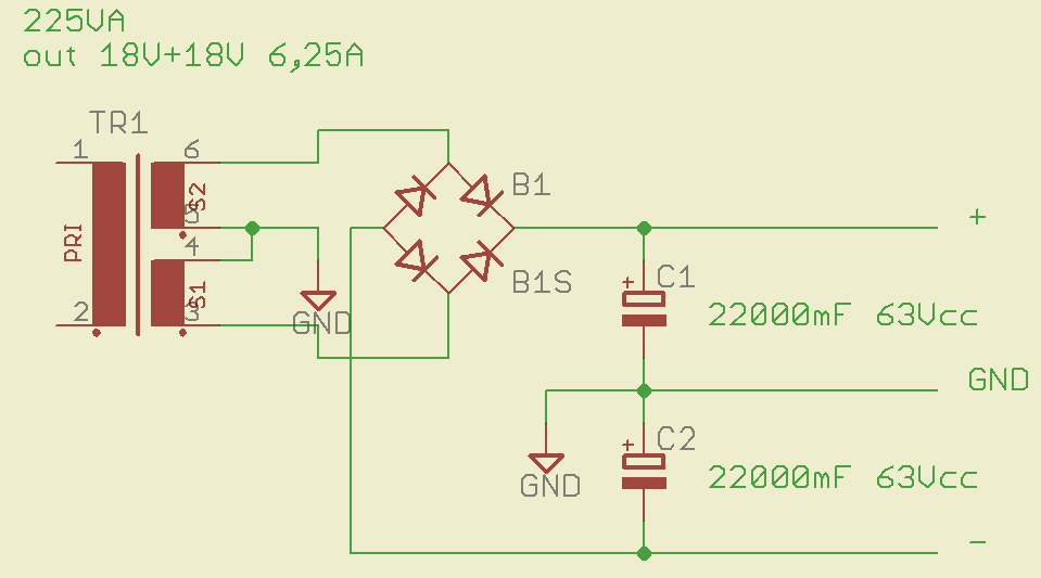

so, I think I'll use this transistors MJL21194 and this transformer 225VA 30v+30v
do you think it's enough?
thanks 1000 for patience.
A.
A 30V transformer will result in ~40V DC rails, not 25V.
The possible power on 8 ohm will be ~80W/ch, which is manageable.
You could use 33 to 43V zeners
yes! thanks
It is perfectly OK, you can feed both channels with it (or even more, if you fancy it)
thanks a lot....

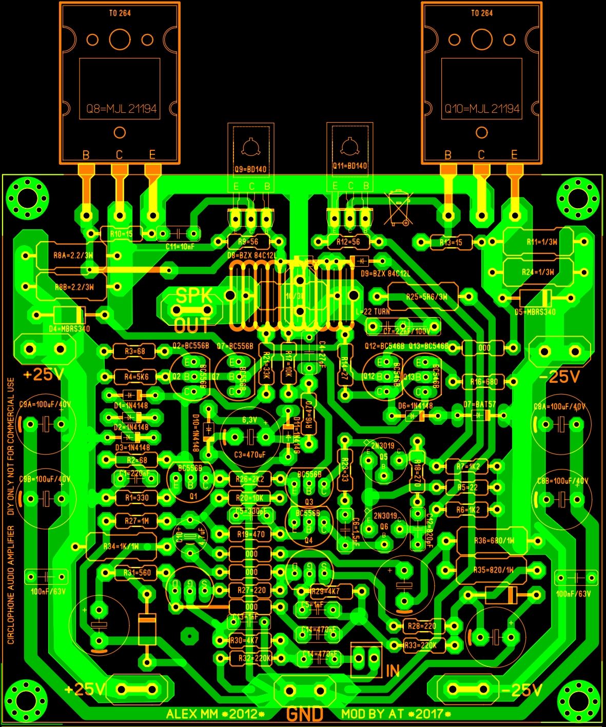

Can anybody help me to convert this pcb layout from sprint to gerber?
thanks

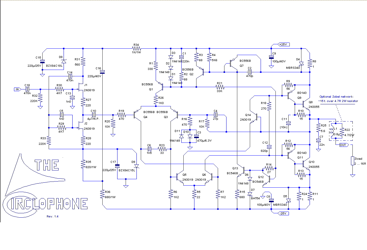

Burnt R10- 2nd time
Hello Folks !
By mistake switched on my set up with full volume, one mid range channel went up in smoke. later inspection revealed burnt R10 (15 ohms resistor ) and completely charred 10 ohms 3W resistor connected in series to output.
No visible damage whatsoever on remaining 4 circlophones - they are running just like before.
This is happening 2 nd time . what could be the reason for this
Last time also it was single channel in mid range when CD player which was connected, started with full volume by mistake.
My setup :

R21= 39K
D8,D9= 15V and 13V
Output transistors = TIP35C
PCB- Alexmm ( without any fuse )
None of these amps have Pot connected to it ,hence volume is controlled through source (Volumio or bluetooth )
All speakers are 8 ohms
Outputs and drivers mounted on common heat sink, remained isolated when checked after the incident

This should pose no problem, except perhaps for your speakers and your ears.Hello Folks !
This looks like a violent load-dumping event. It could happen in case of severe clipping and highly reactive speakers.later inspection revealed burnt R10 (15 ohms resistor )
A fix would be the addition of anti-kick-back diodes across the C & E of each output transistor; 1N4004 are sufficient, but you can also opt for larger (3A) diodes and fast types. Connect them with the cathode to the collector obviously
Which resistor are you talking about? There is normally only the zobel in series with the output, and it is shunted by a coiland completely charred 10 ohms 3W resistor connected in series to output.
I do not see any plausible explanation other than load-dumping: almost everything else would have ended with the OP devices shorted.Want to find out root cause of this problem, not sure where to begin.
Any help would be highly appreciated.
Don't mind rebuilding the entire board with all fresh components (SQ of circlophone is worth every effort) but want to know the root cause
Note that they might be damaged, even if they are not short-circuited: the reverse bias of the E B junction is not healthy.
In summary: replace OP and drivers as a precaution, and add diodes to all your modules, including the ones that were unaffected.
