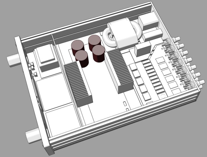

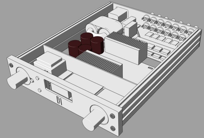

Hi guys,
I have a question for you:
Here is the background,
1 - I want a compact build, soi chose a HiFi 2000 Galaxy box !
2 - I want a digital input/volume selector with a log relay volume control.
3- to keep things quiet i choose a R-core tranformer .......this is the start of my dilema...:
should i have transformer inboard or will it interfere too much, from images you can see the reason for my hesitation, the output RCA pair is close to the AC wiring.
I can shield this but the question remains ....will it be enough ?
Glad for all sugestion I'm still at the stage of milling the front and other bits.

The R-Core will not interfere significantly but the AC cord and primary cabling can bring some more mains frequency when near to the RCAs. I had one measured built with a narrow back panel and AC coming in likewise. I could see 50Hz higher on FFT than normal, but was inaudible on the speakers. It did not use coaxial in/out cabling though. It was a Mezmerize, so the naked portions were short.
Then put the output pair on the opposite side, and start connecting the inputs by the other side.
