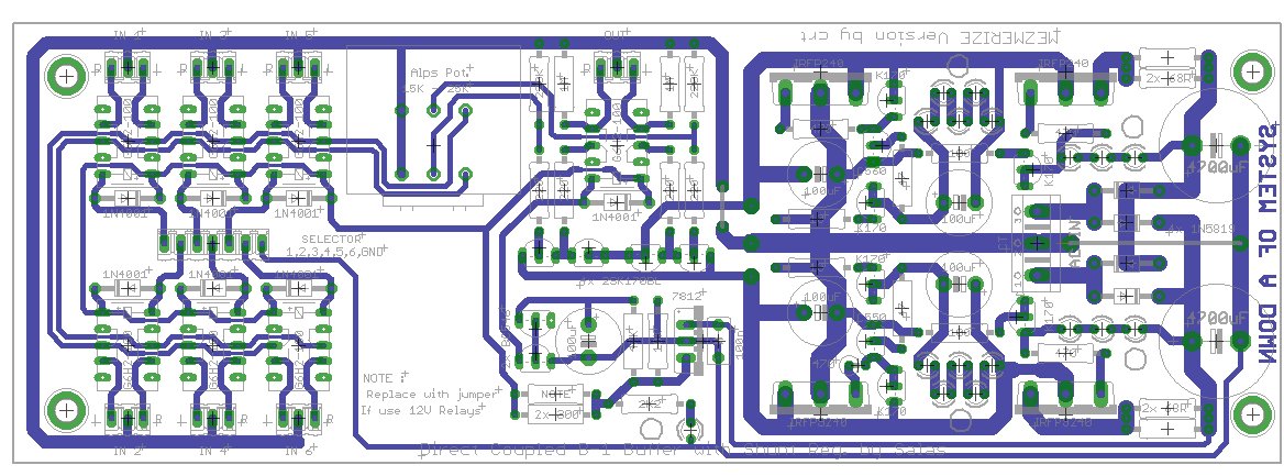

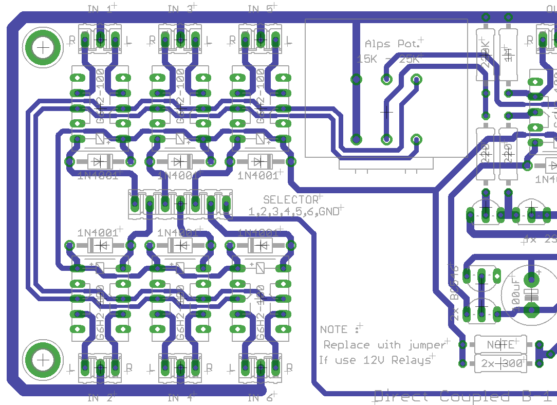

The pin outs shown printed on the board are not correct! They are as in my post Gnd, 6, 1, 5, 2, 4, 3 in that order from shunt side to relay side of the board. Thats the order of the relays as they are routed to the connector. (I am sure you know this already)
My basic testing last night between 1 and 4 concurs with BillyK.

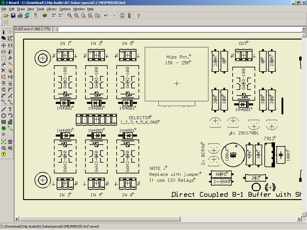

They are correct if you look at the new overlay and the traces on this overlay here:
http://www.diyaudio.com/forums/showthread.php?p=1909777
The input relays got new numbers to make it match, on the new overlay the input numbers changed, now it makes sense so to speak...
