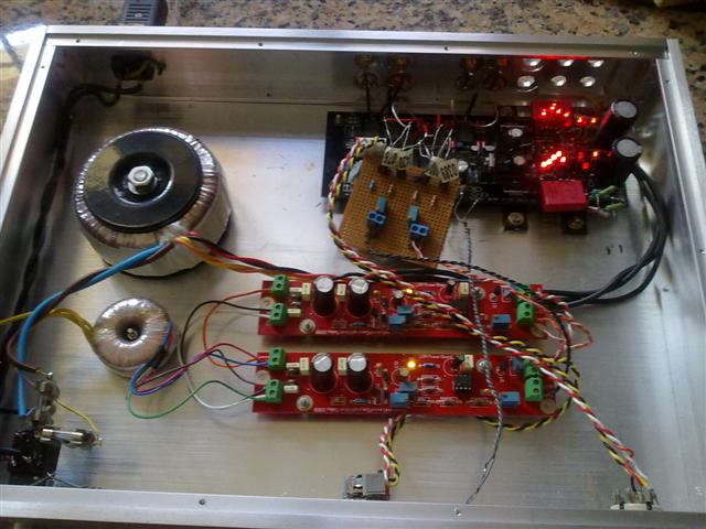

My DCB1. pls pardon the untidy wiring, am trying out the LDR vol control, with Uriah's control boards. Was also experimenting with the LEDs, so just soldered to the leads. But once I got it to work and played music, just left it as it is! Using WIMA MPK10 0.68uf and CCS has been hot-rodded so chassis does get a bit warm!

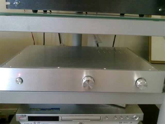

I like that slim chassis. Is that chassis not ready made, but DIY from aluminum panels? Congratulations for the build, you can organize it later inside, most important is that you got the sound you liked. What is the rest of the system made of?
Thanks to Salas for the tremendous help rendered during the build!!
Got it from a local store, think they CNC-ed a a few sets for hobbyists. But yeah I guess it's DIY from some aluminium panels.
The DCB1 is currently driving a Rythmik sub and a TDA2020 amp powering Coral Beta 8s. IMHO, sound is superb to me, even the wife says so!
