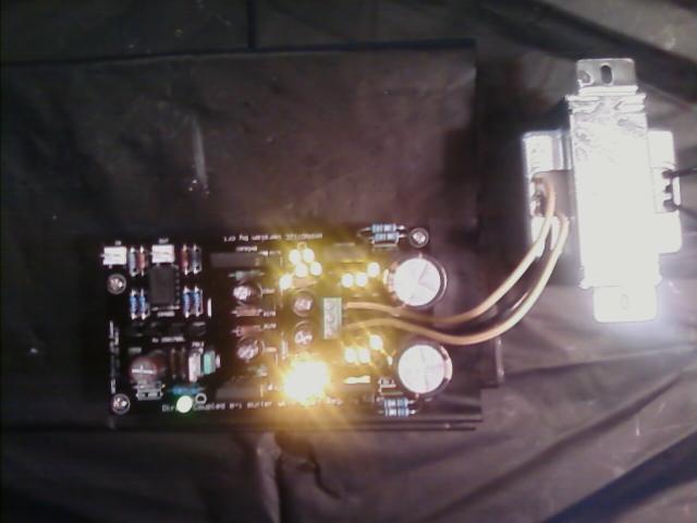

regiregi22 - I believe in an earlier post Salas suggested to try .1 to 1 uF MKP's to replace those electrolytics. The Wima .22 uF being a "known good" part. He had suggested to me to try the Vishays as bypass caps on the existing ones, as those seem highly regarded. Decided to just yank the 'lytics completely. Parts Connexion listed .1 uF as the largest value available. Wanted to target that Wima so another in parallel underneath gives me .2 uF.

Successful first turn on...
Voltage measured across the the 68 ohm resistors is 2.14
DC offset less than .001 volts. (below what my DVM can measure)
VRef positive is 10.79 V and VRef negative is -10.11.
MOSFET's are just a bit above room temperature.
Not sure if there is any further adjustment required at this point. Only hurdle I had was misunderstanding the suggested transformer type. Fortunately Radio Shack sells an acceptable 12.6V CT transformer that I was able to buy local.
Thanks for the work that went into this. More pics to follow as the project progresses.

You mean 25V Tx with center tap I guess. All tests indicate success! Let us know how you will like it later when run in your system.
Oops... You are correct. The package says 25.2 Volt, 2 Amp with a center tap.
When I measured the LED's most of them were 1.90 Volts. For a starting point I used the ones that measured the same and got the results I gave above.
Is there any reason to lower the VRef+ to approximately 10.2 - 10.25 Volts? That would be about 1% higher than VRef- which is still at -10.11 Volts. I do not know if it worth doing or not.
No, because it fortunately fixed so well your specific audio jfets for unmeasurable output DC offset as is. I believe that the relay clicks OK? If not, here is the reason of 0 offset success! If it clicks OK its success indeed, and I suggest you give it a listen now.
The relay is working. I can tell that the meter sees some voltage because the display changes between + and - when measuring. And it does briefly show a 1 if I wait long enough. Even after an hour the offset measures the same way.

It will still remain a bit unequal for voltages. He is referring to running currents. Since there are differences in Vgs between PMOS and NMOS batches, same Rset values don't produce same currents in both sides. Gfs will not significantly change if they are already roughly near for current though. Some report very near Rset Vdrop in builds some not. Random.
I think the DCB1's output bias is determined by the Vgs @ Id of the source follower.
If Id is close to Idss then output offset (=-Vds) is near zero. If Id = Idss then output offset is zero. It may wander a little with changes in junction temperature.
