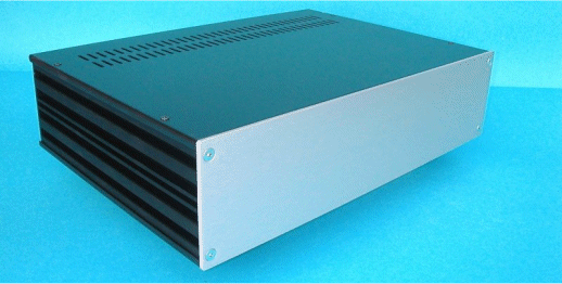

For Europe this seems a good alternative : Hi-Fi 2000 contenitori per l'elettronica, case modding HTPC, Galaxy, rack, DIYaudio, computer cases, knobs,milled Handles, milled fronts, hi-end,
There are a lot of sizes and they seem not too expensive, approx EUR50 including shipping.
edit : EUR50 based on a 23x17cm case for the B1.

I'm working on it. If you chose the 28 cm deep version, you could also fit a suitable xfrm.
My idea is to hold the pcb (Hyp or Mez) with some 3 x 3 cm L shaped alu bars 5 cm apart from the back panel. The bars will also provide heatsink for the mosfets and hold the selector sw and volume pot for Hyp board.
The xfrm (Hammond 229D24) will be placed close to the front panel with other 1,5 x 1,5 alu bars.
Stay tuned
Massimo,
I am not sure about this but if I am right you will short a turn on the transformer by mounting it to the chassi with an aluminum bar on each side if you will be attaching it by the core that sticks out the sides of that transformer. I would mount the transformer on some perf board or similar then mount the board to the chassis. I could be wrong about shorting the turn. But thought I should warn just in case.
