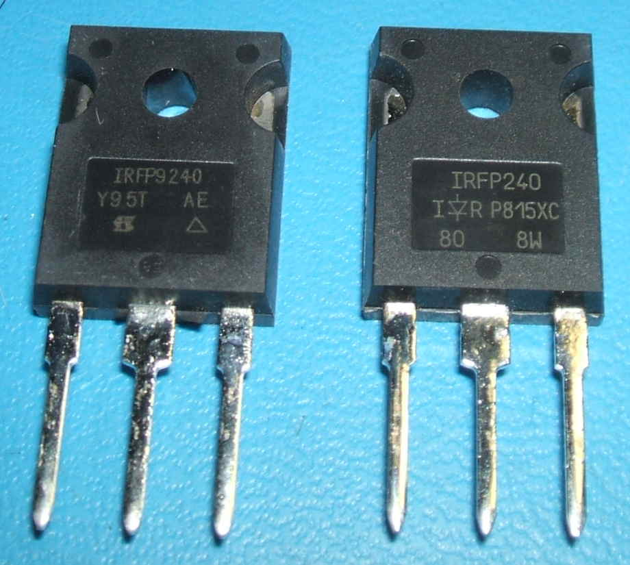

My IRFP devices from ebay arrived today, 10 x IRFP9240 and 4 x IRFP240, USD$2 each, the IRFP240 look OK, but I'm not sure about the IRFP9240. They were sold to me as International Rectifier devices. My opinion only, I am concerned that the device on the left may not be the real thing. The IRFP9240 I used in the proto PCB were sourced in Australia where I live and cost AUD$8.95 each, and they have silk-screened (or printed) characters and logo, but this new lot from Hong Kong has etched characters and logo. However the IRFP240 from the same seller are not etched and look similar to the ones I sourced locally. Any comments welcome...
