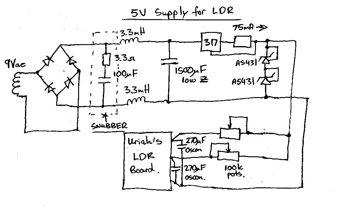

Hi Uriah. That is very interesting about capacitive coupling on the LDRs. My supply is perhaps already similar to what you suggested (see circuit below). Do you think the Oscons are ok as final filtering elements? Any other suggestions for mods are welcome.
I think the problem I had might have been exacerbated because I use an LC filter after the rectifier bridge. This caused a weird looking waveform on the output of the bridge which seemed to also upset the transformer and produce some additional ringing on this and other windings.
The snubber I fitted is shown on the diagram. The waveform there is still strange, however the sharp resonances noticed on all windings are gone.
As an interesting bonus this snubber even eliminated the minor ringing on other windings which was generated independently of this circuit.

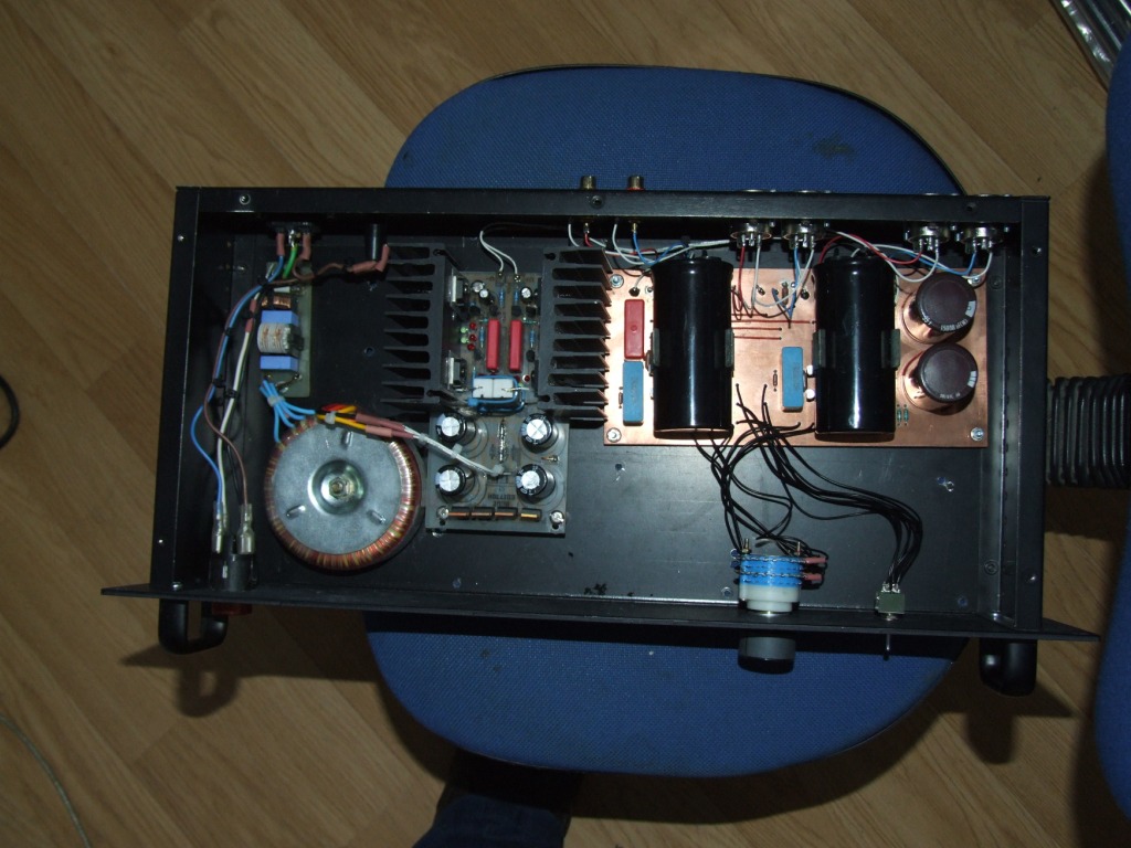

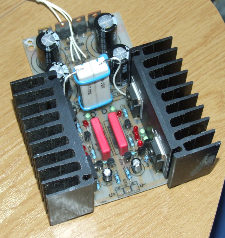

Well I went ahead and cut the DCB1 PCB in half and now have a SALAS Shunt Reg that I can use with my B1.
I've reduced the series resistors to 10R and added heatsinks.
Question is - Why are the resistors so massively specified ?
By my measurements with the original 22R resistors VR = 1.4V.
Now that I have 10R, I=E/R so I = 1.4/10 (which equals 140mA)
The resistors are only going to be dissipating I^2R = 0.14x0.14x10 = 0.2W
I/ve used 10W because that is what I happened to have.
Under test VR has crept up slightly on one rail to 1.77V but stays at about 1.58V on the other.
That means that I am running 177mA +/- 10% on one and 158mA +/- 10% on the other.
I'm letting it cook to see how warm it gets.
(The tolerance by the way is the tolerance of the power resistors).

Should be OK. THe IRF's are tough. You can judge then if you have enough. What is the reating on your trafo secondary?
15-0-15 60VA

After a great deal of playing, I've now settled in for this weekend with my B1 running with the Salas Shunt reg. set at 180mA.
I do think that 600mA might get a bit warm in there but I might try 500mA later.
The B1 is a far more forgiving board when it comes to laying it out and is completely silent. A correctly laid out DCB1 is silent too, don't get me wrong.
I can use my wonderful Obbligato 10uF PIOs in this layout which suits me as I have a DC coupled amp.
The B1 doesn't need the dual reg, but, hey I'd built it anyway so I'm just using is as a 19V DC supply.
No humming, no buzzing and no distortion. Just pure listening pleasure. No relays, No turn-On thump, just everything as I would like it.

Jeremy,
Your supply should do the trick. Oscons are nice. I find them expensive. A Nichicon or Panasonic will give you the same effect. Dont forget to throw a film on the electrolytic's leads.
Uriah

Great. I found the Oscons in my parts bin and thought "what the heck". Best I delve back in their for a film cap too.
Thanks for the advice.
Jeremy
