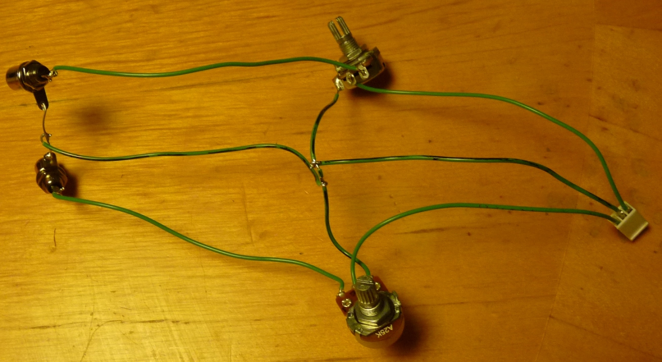

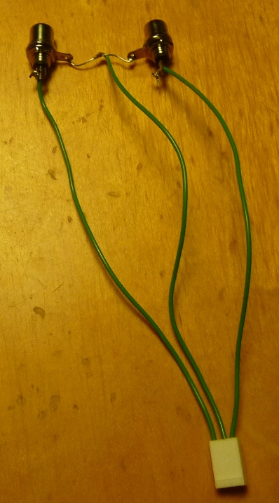

This is how I wire the input and output.
Inputs: for two pots, center lugs are the outputs.
Outputs
A picture will help.
Looks like normal 3in 2out 1gnd pot wiring. Is there a picture of the board also? Offset OK?

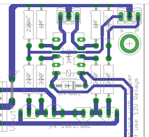

This is the board. All LEDs are lit and the voltage are 10.1 and 10.0.

Visually it seems normal. I can see the jumpers there too. When you will connect the in & out sockets and see for offset check with the DMM in Ohm mode also that there is earth continuity in all places RCAs & pots that should be. Also see that no 220R position is swapped with 220K by mistake.

Yes, but also check there is voltage drop on the current setting resistors (1.5-2.2V). You report good Vo symmetry as for now. Look for it does not have more than 5mV DC on the AUDIO outputs. The warning about DCB1 is don't use it with DC coupled power amps that sport no DC protection systems just in case it will break down in its life time and will drive high DC in the power amps. A healthy DCB1 with low to almost zero DC offset on audio outputs is as normal to use as any preamp for all intents and purposes beyond that disclaimer. As a matter of fact many here use it on F5 (DC coupled) on own risk for long. Yours is described as a fully protected power amp, no info if DC coupled, and is the only reported bad test incident till now. Can't imagine the reason with no more data yet. Investigate, and good luck.

I might have found my problem. The ground wire wasn't secured properly on the input or output.
Anyhow, after I think I "might have" fixed the problem - the DC offset from the output measured at
- 1.1 to -1.3 on both sides when the DMM is set to 200m VDC. I always put the black prob on the "G" positions. Is this correct?

Your probe is used fine. If it is -1.1mV to -1.3mV then its very low offset. I would suggest you try to test listen on a secondary cheap system like powered computer speakers. Make sure your source used during the power amp injuring test does NOT have any large DC offset on its audio outputs that DCB1 would have certainly allowed to pass.

Got it. These are the measurement when I turn the 25K volume pot to maximum. My guess the problem is that the negative wire is not touching the center of the three pin connector either on the input or output. It's a bit shaky right now so I'm thinking to solder the input / output wires directly to the PCB. Would that be OK?
With lessons learned, I'll take measure every step changed.
