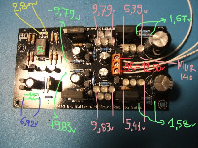

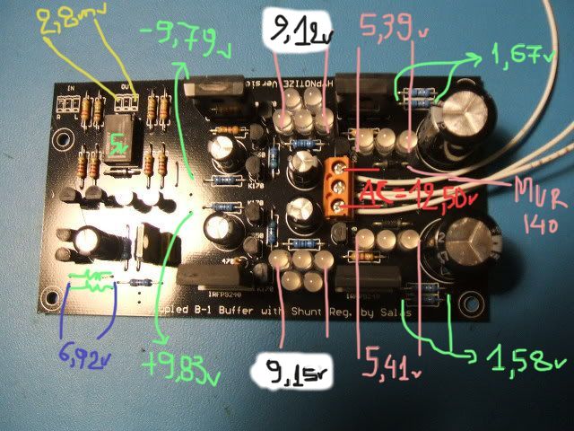

I've just reconnected my DCB1 - Mezmerize and it doesn't work anymore as expected.
If power ground is connected to safety ground it's quite silent with slight hum but music appear a lot attenuated, say 1/50 of the original volume.
If power ground is disconnected a full volume hum with hiss is present (obviously I must shut off the amp suddenly...)
I've measured voltages on AC rails (ca 14,3 V, OK), on led VRef (ca -10,32V, +9,73V) on regulator output (-10,96V, +10,36V).
All relais seems to work as expected, as the input switching.
I suspect that the 2SK170s are broken...
I need help...
Thanks in advance
Hi Tea-Bag
first of all thanks, I've made the suggested measures and all seems fine.
I've measured ground continuity with the DMM in several point (all inputs and output ground vs power ground and all jumpers) and it seems OK.
Broken ground...mmh...Ouch!
I've inverted signal and ground on output cables! :eek:
Now it works!
Thanks again you drove me to the solution. :)

Some measurments after one hour working!!!
Comments about R1 ccs voltages?
