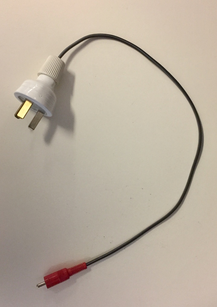

Oh GOOD! Although using an XLR connector is inviting trouble... I tend to use 4-pin Lemo or Tuchel connectors for such cables (using 2 pins for ground) so that mistakes cannot happen. I thought it looked suspiciously like my favourite 50Hz Test Oscillator :)
Looks like the DC umbilical, not mains... ?
Yes, DC raw umbilical....back in the day I had the job of hooking up (making up) my sons bands xlr's. He used this vintage mic which needed 30vdc down a 25mtr run. It was always a enigma to me...why not use a modern mic? but he wouldn't be persuaded. XLRs are good, used world wide by all professional rockers....
'The mains cable' as used by a quality british audio manufacturing company as signal hook up from pre to power amps....
50hz tester, like it :)
So, move on
