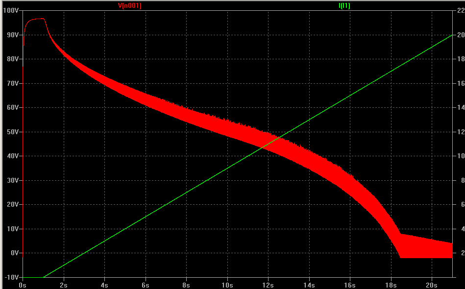

megajocke said:The leakage inductance is on the AC side of the rectifier so won't work as the common inductive filter supply. It will make the conduction angle wider though as you say. Output can drop below rectified average.
On something poorly wound, or with intentionally poor coupling. With a primary wound closer to the core and evenly wound, primary side reactance is a small portion of it.
So-called "inherently limited" trafos or these split-bobbin EI units that they use for low capacitance, the primary side reactance is quite high. They drop like stones under any sort of load. A 1-amp unit could flywheel at 100mA. But we don't use those to power big audio amps. I've yet to load a 60 Hz toroid heavy enough to get it to drop below rectified average. Except maybe the one time I melted a potted 225VA unit making hydrogen from salt water back in undergrad school.
I agree that in the center tapped full wave rectifier the distribution primary/secondary will matter and there will be an effect similar to the one of inductive filters.
But in the circuit used in audio amps we draw AC from both ends of winding of the transformer so it doesn't matter if all leakage inductance is transferred to the primary.
The drop isn't proportional to current though, the output resistance decreases the more current you draw as the conduction angle widens so it fits with your observations.
See attachment, first 20% or so drop fast but after that it gets much stiffer. Also, ripple doesn't increase much with current.
This was with 1mH leakage inductance referred to secondary, bridge rectifier and 100V peak (70V RMS) input. 30mF smoothing and neglible resistive loss. This leakage inductance is on the high side compared to what would be found in a power amp transformer but the only real difference would be the scaling of currents. Red = output voltage. Green = load current
