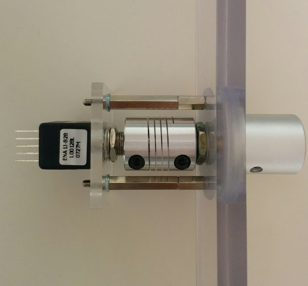

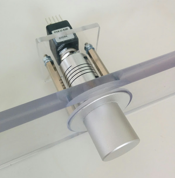

You might think that finding a quality high resolution rotary encoder would be simple but it's not! There are tons of low resolutions ones available that are 32 PPR or less but once you've used a nice high res encoder the others feel really cheap.
If you have around 200 volume steps then it would take about 6 rotations to use the full range, which I find annoying. I tried two encoders:
Bourns EN series at 128PPR
Bourns EM14 at 64PPR.
128 PPR is I think this is about as high as you can go and still (just) be able to adjust by a single pulse. Both of these Bourns models are "designed for audio" and the feel of them is really nice compared to the cheap encoders. Also, they don't need debouncing at all in hardware or software.

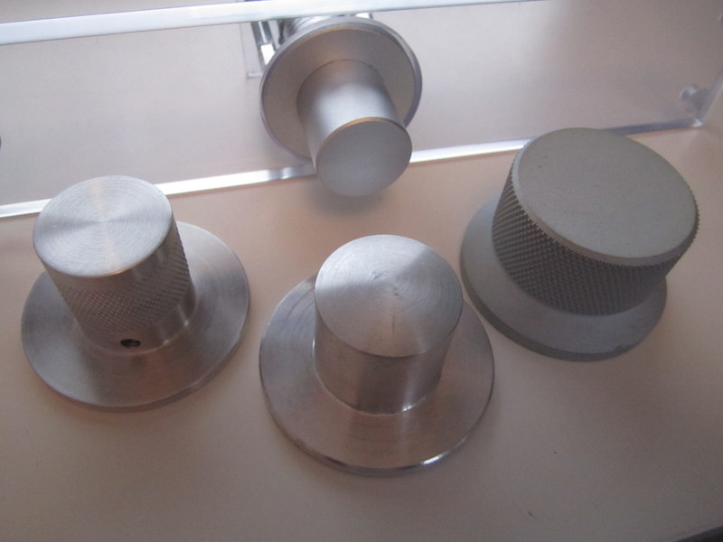

In the end I decided to use the Bourns EN series as it was smoother and higher resolution. The problem with these encoders though, is the shaft size, it's 6.35mm (1/4"). This is a pain because I couldn't find ANY nice knobs with this shaft size, all the nice ones have 6mm holes. I tried drilling the hole in a 6mm knob to 6.35 but it's difficult to get the hole perfectly centred and ended up looking a bit off when the knob was rotated 🙁
I tried a shaft extension kit that was compatible with both sizes but the tolerances were too low and again when the knob was rotated it wasn't quite centred.
So I then started to search for something a bit more precise to convert a 6.35mm shaft to a 6mm hole and found these:
I bought one and it works really well but takes up a lot of space in the enclosure.

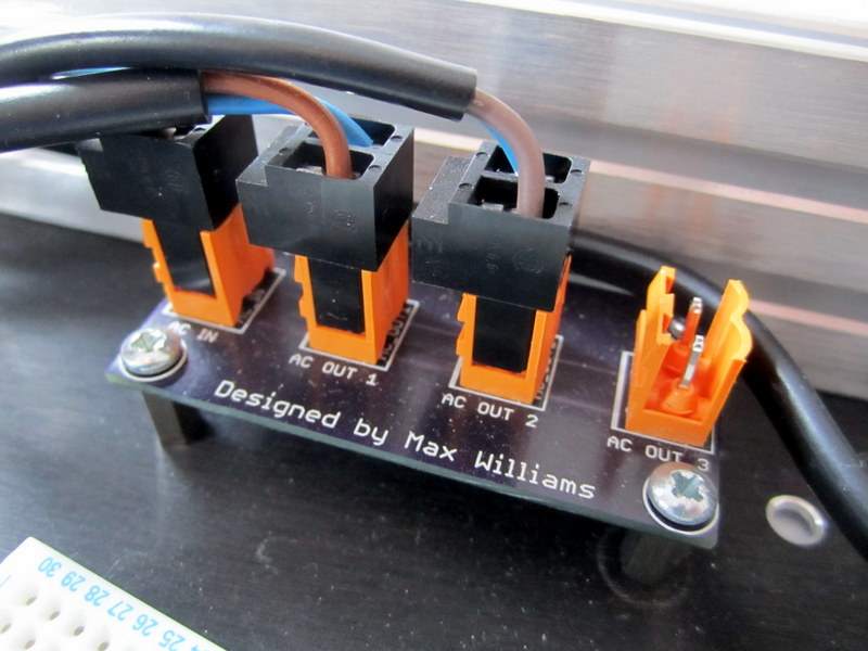

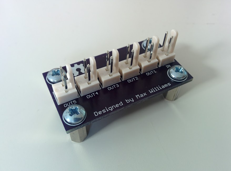

I also designed two simple PCBs for distributing mains and 5V power. It could have easily been done on strip board but I wanted something that looked a bit nicer.
The pin headers and crimp housings on the 5V board are these:
MC34481 - MULTICOMP - CRIMP HOUSING, 2.54MM, 2WAY | Farnell UK
MC34629 - MULTICOMP - HEADER, THT, VERTICAL, 2.54MM | Farnell UK
2218T - MULTICOMP - CONTACT, CRIMP, PLUG, 26-22AWG | Farnell UK
I also used the 3, 4 and 5 pin version on my other designs.
And the 2 pin headers/plugs on the mains board are these:
1716470000 - WEIDMULLER - PLUG, FEMALE, 5.08MM, STRT, 2WAY | Farnell UK
1517260000 - WEIDMULLER - HEADER, THT, VERTICAL, 5.08MM | Farnell UK
Schematics and layout are attached.

Just a small tip, if you'd like to make the holes bigger of the volume knobs use a 1/4" - 6,35 mm reamer.
They're made to make a hole slightly bigger and are very, very accurate.
I prefer to use them in a bench drill (is that the right term?)
So you can really feel what your doing using the Pinole.
Also, put a small cloth or tissue under your know as you're reaming.
And use a bit of wd-40 for lubrication. I'd run the reamer at about 200rpm
This way it'll fit right away on your encoder.
P.s. Make sure that you're using an oversize reamer, H7 or H9 tolerance.
Peter
I really like your thread, loved to read it and eager for updates.
I'm busy trying something similar to your idea.
Thanks! I've ordered one, I'll post host it goes once I've used it.

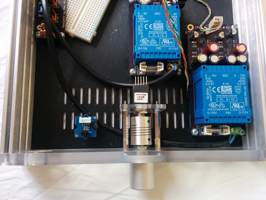

Max,
the untwisted input pairs could be picking up interference.
Could be! When I install the dividers I'm going to redo all cabling to make it twisted and as short as possible.
Is that the Earth Tag on the mains inlet filter that is not connected to Chassis?
Bolt it to the side panel with a short wire.
Yes it is connected through the bolts of the IEC inlet itself. I've tested it and it makes a good connection throughout the enclosure 🙂
Are the fixing bolts passing through plastic insulation?
On the outside but the contact is metal to metal where the casing of the IEC socket touches the enclosure. This connection is then pressed together by the machine screws. I think it's solid.
Is any of the aluminium anodised, or liable to corrosion?
See my 6th post, I requested a non-anodised case so it conducts well. Aluminium won't corrode 🙂
