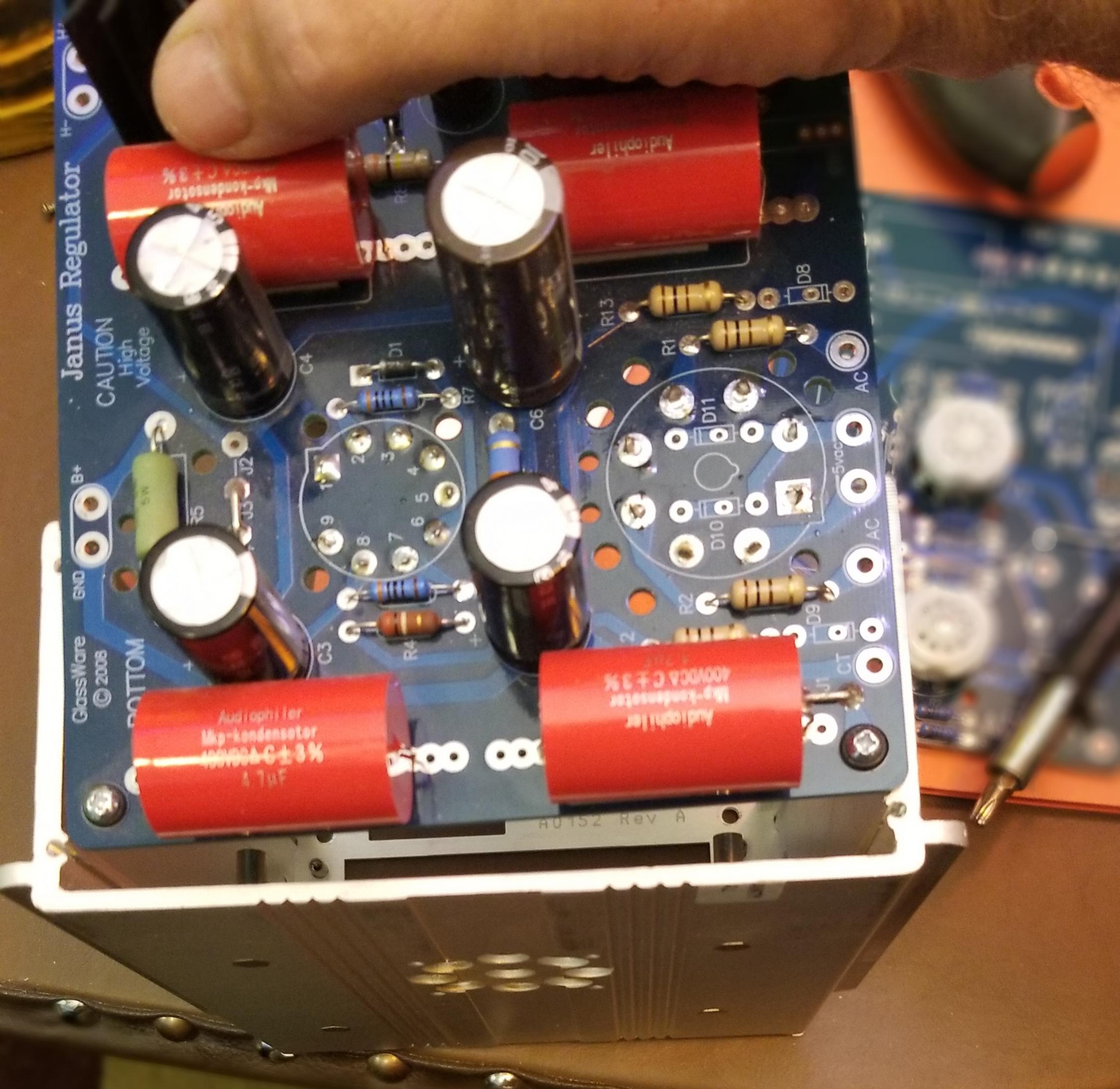

I got the boxes yesterday. I figured the Janus Regulator board would be a tight fit but I did 't figure the walls would be so thick. I'll have to grind out the inside walls of the box so the board will fit.

I see on your photo that you have both 9 pin and 8 pin board - I don't know this variety but pretty sure the designer will have kept the usual range of options.
One thing I'd suggest if the budget allows is to get a couple of the Obbligato caps for an optional output (add a simple heatshrink sleeve over their metal jacket for safety) - there's plenty options (and opinions) about the choice of capacitors - some cheaper nice Russian NOS too.
It looks like you've kept the power resistors well above the pcb surface - they 'char' the board after awhile if close to surface -

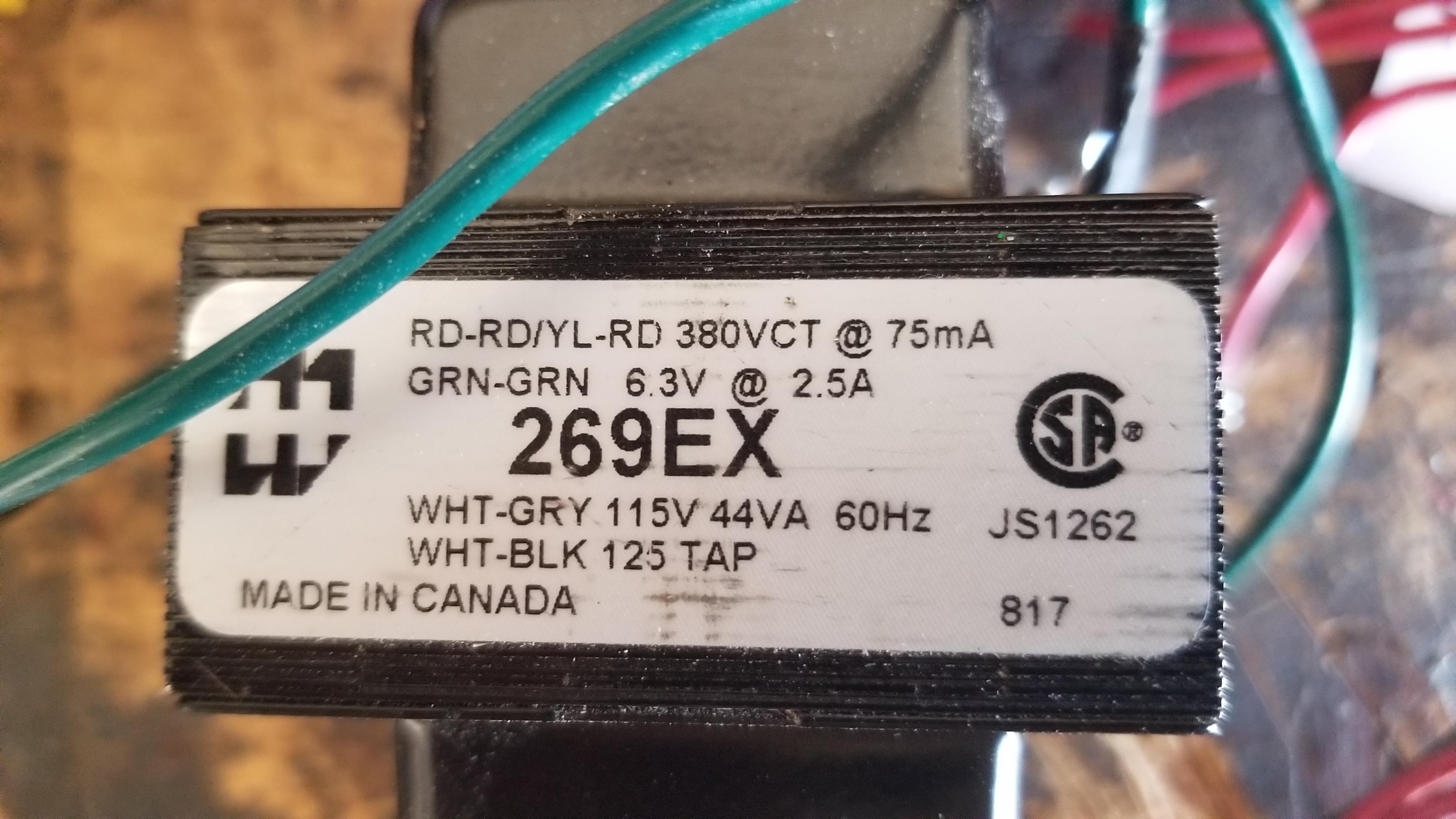

This tranny seems to be a little small and is a little shy of what the Janus Regulator manual calls for. What do you all think? I'll also need another one for 5v and 12v any suggestions there?
