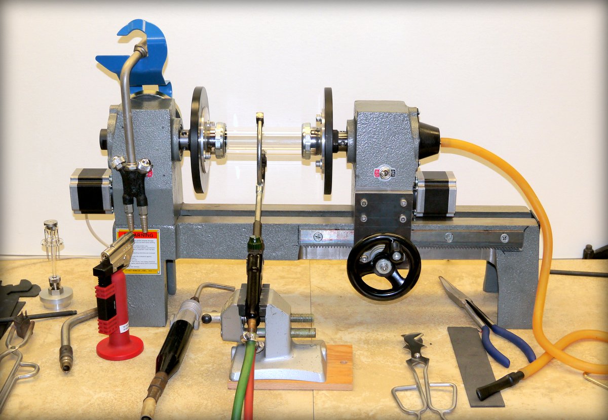

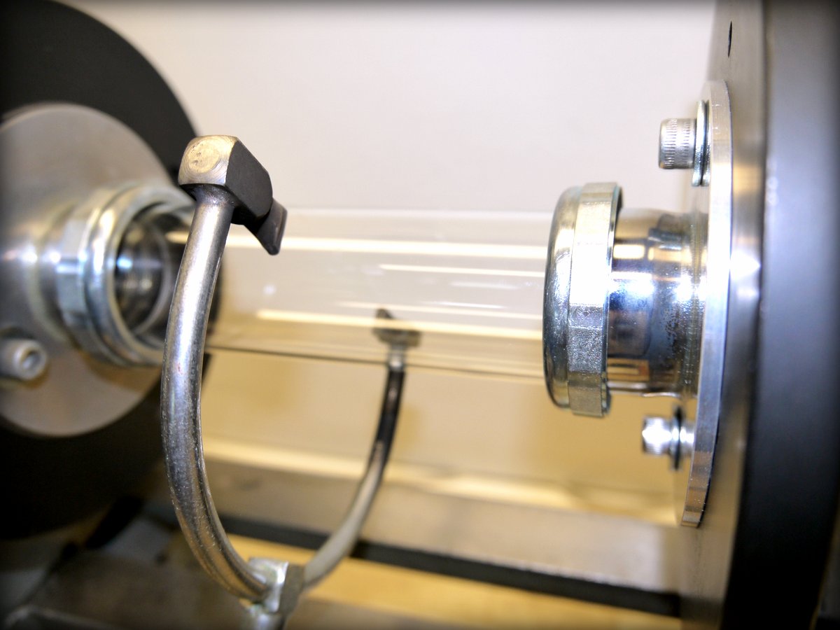

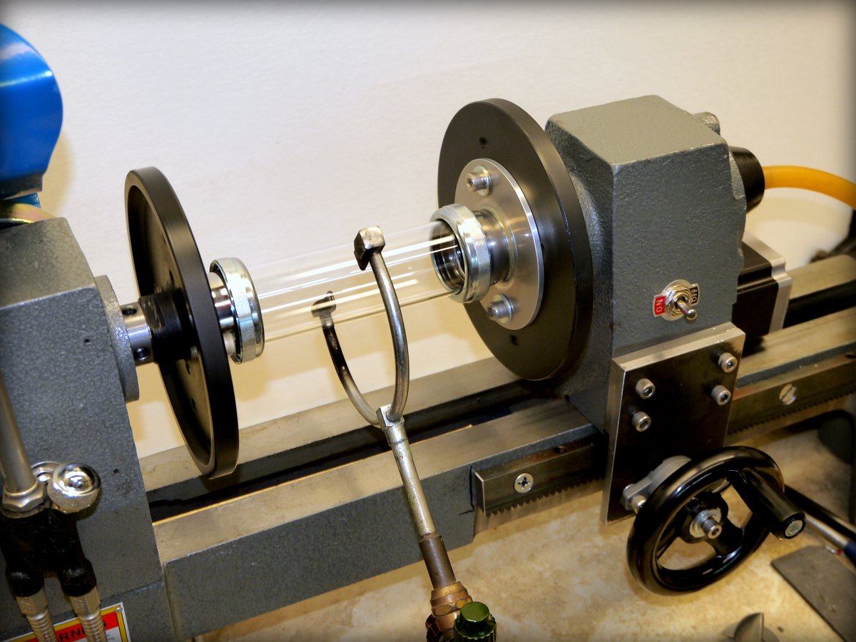

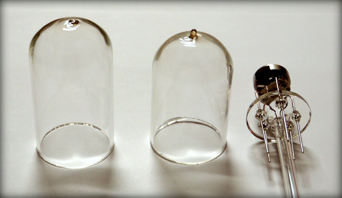

I got a chance to try out the new version of the glass lathe yesterday and was pleased with the results so far. The project was to make some envelopes for the new triode design that will be along the lines of a WE 101D electrode geometry. The lathe will make 2 envelopes at once and the process is really simple. The photos show the way the torch is mounted and aligned with the work. I'm looking forward to sealing in a stem assembly and being able to do a proper bakeout now that the tubes can be made with all glass seals.

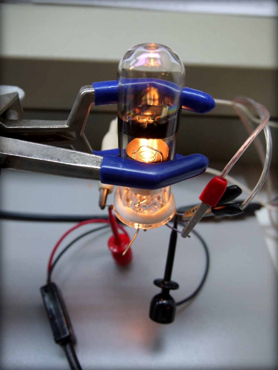

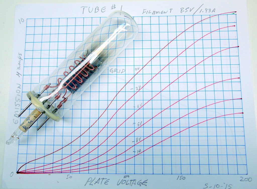

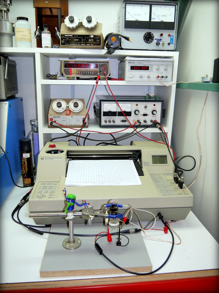

Kevin - The Workshop has instruments set up to be able to plot the characteristic curves of the tubes after they're processed. The photos show the setup and a typical plot from a single wing Audion type build. These tubes made good AM radio detectors.

Kevin - Thanks for the positive comment! That tube was one of maybe 20 or so that I built back in the mid 90's. As can be seen by the date on the graph it was tested last year and is still a working tube. This fact should be an endorsement of how well an epoxied together tube can last. They didn't all make it, but a few are still functional.
Now that the glass lathe is up and running the DIY tubes built in the Workshop should last as long or longer than any tube made back in the early days of radio. I expect that the Workshop version of the WE 101D will perform on a par with the original design. We'll see.
