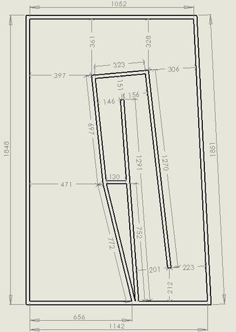

Oh yeah, if you want to covert the drawings from metric to inches, just divide the numbers by 25.4 since 25.4mm = 1 inch.
I was, but Petter PM'd me and let me know that just using the closest thickness of American plywood (in my case, 3/4") wouldn't hurt the sound quality. Knowing that, I'm gonna hold the same measurements, just with slightly different wall thicknesses.Hi Spuddy,
Are you looking for inch measurements for the drawings from Post #1, e.g.: see attached?

My biggest concern with metrics was that I can't get metric plywood here, but since that isn't a problem according to Petter, I'm gonna take the easy road and use the first measurement conversion site that comes up on a google search. I'll be buying wood tomorrow (ok its 2am, so later today really ) and starting as soon as I can around my busy schedule, so you can count on updates when I have something good to show

Spuddy, I am really glad that you built this subwoofer. Ever since I
designed it I wanted someone that could make it real. The design was
optimized according to:
1) Low freq. extintention
2) About 1200 mm wide
3) As thin as possible to fit behind a movie screen or to be hidden some how. (that´s why it did not fit on x no. of sheets)
4) Easy built with not too much foldings.
5) Cheap long throw drivers.
The name Kracken will be its name from here and so on. Great choise, sounds terrifying

I'm doing my best to get the metric-standard conversion into MS paint for you; Bear with me, as I'm a very slow MS painter (tough being a perfectionist and using a very rough-cut program), but it should be ready for the weekend if nothing unexpected pops up. For now though, you'll need:
-2 JBL GT0 1214 subs (get em on eBay for $84 each with free shipping from seller billselectronicgear2000)
-3 sheets of 3/4" void-free plywood or MDF
-Couple pounds of coarse 1 5/8" drywall screws (and some separate screws/bolts for mounting the woofers if you wish to go that route- personally, I just used the drywall screws, but it's a bit hairy because there's not much room for error if the wood happens to have a soft spot right where the screw needs to be
-Big bottle of wood glue
-Counter sinking bit (if you don't already have one. You definitely need to counter sink the holes if you want the screws to hold tightly while the glue dries though. This is important!)
-Some pegs/proper size drill bit/clamps for dado jointing one of the panels (If you want to keep it down to 3 sheets)
-Heavy wiring, and putty to fill the hole you'll make to wire the two speakers together
ANNNDDDD before I forget, make the port opening before gluing and screwing anything and you'll save a lot of hassle. Also have a way to get your bracing in place from the start, because a standard drill won't fit where it needs to be once you have walls up. You probably already know half of what I said, but I figure it's worth posting the problems I had at any rate

Looks like you hit your goals pretty well!
1) That's a home run. This sub has let me know that my house's resonant frequency is 16hz. Seriously, 16hz is downright VIOLENT full-bore, and it still goes deeper that that
2) Sounds about right
3) Couldn't be much thinner than it is and still use 12's! It's also juuuust thin enough to work as a false wall in my case haha
4) Seemed like a lot to me, but I've never made a horn. At any rate, only a few cuts needed to be angled because most were close enough to 90* to not worry about, and that definitely saved some time.
5) There's our winner! Hard to top the Kraken at a mere $480 total cost!
