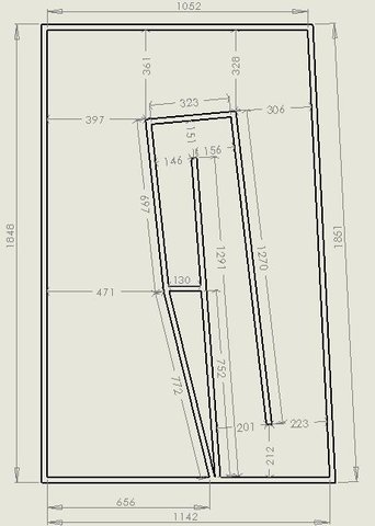

I hope I don't get kicked off the forums for not being a good searcher, but here goes:
Can anyone explain to me how having two speakers in the box effects the measurements?
In other words, which speaker do I measure from? Or does it completely change everything?
EDIT: To clarify, I'm talking about measuring the segment lengths as per Hornresp. Also, using the push-pull arrangement.

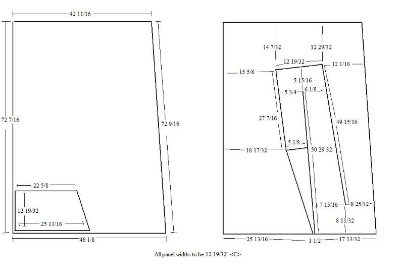

so you could do 20 hz or 16 hz if you buy a rn of 100k
I would add an access panel on the low pressure, final fold of the horn side.
Don't put a panel on the high pressure side! Just use bolts and make them studs (like on a car wheel) for the speakers to bolt to. Not too difficult and with the
panel on the low pressure side, it will be much easier to keep the seal. If it leaks on the low pressure side, it will sound weird. If it leaks on the high pressure side, it can cause the driver to loose pressure and exceed Xmax.

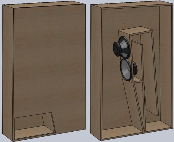

i want to build a tapped horn. I can get these two drivers for a good price.
I want to use the tapped horn for movies.
Eminence Eminator 2012
Eminence Eminator 2512
I just want to you 1 driver. Are there any plans for a tapped horn for one of these drivers?

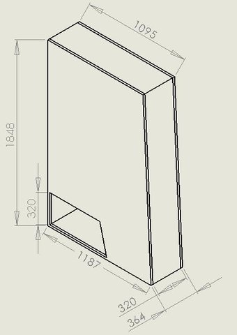

I read the thread and now i know what i want to build. I will build the kraken 112.
I want to build as cheap as possible. Therefore some questions.
The Infinity 1260w looks very similar to the jbl gto 1214, but is 40€ cheaper. Can I use the Infinity?
http://www.jbl.com/resources/Brands...uments/en-US/BoxesandParameters/GTO1214TD.pdf
http://manuals.harman.com/INF/CAR/Boxes%20and%20Parameters/1260W_final.pdf
Is it possible to use thiner plywood than 19mm or mdf 19mm?
What is the best glue for this build, availible in Europe?
