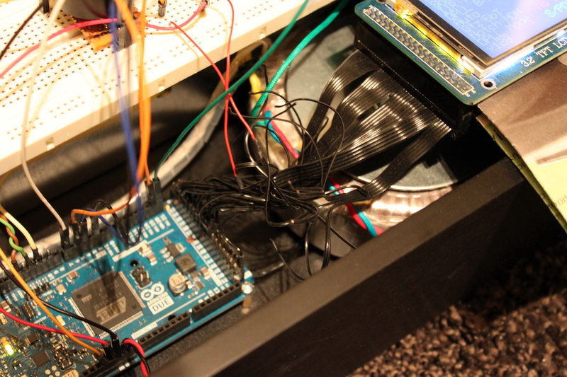

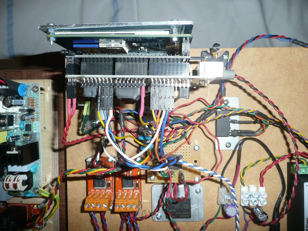

Btw, dear bigpandahk, I probably shouldn't be doing this to you, since you appear to have your hands full with the power supplies, but I have been experimenting with the Arduino Due as a controller and am pretty happy with the results.. The operation is now much snappier. Take a look at this comparison video that I made:
Arduino MEGA vs. Due - YouTube
You may notice that the startup is pretty much instantaneous (ok, no one cares, but still..), the volume control is extremely fast and the input changes are close to instantaneous as well. I'll be sticking with the Due for my implementation. I only have to find out why the rotary encoder is no longer working (it probably has something to do with the way the Due handles interrupts.. I'll look into it).
Very nice, very tempting.
How did you connect the Mega & the Due to the screen without the shield, when I tried that it didn't. are you just wiring direct from the screen to the board, a picture would be great :)

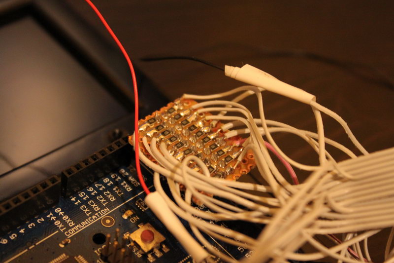

I made this adapter for the Mega:
attachment.php
It is just a bunch of 10K resistors connected to all of the signal pins.
In case of the Due, it is even simpler, since it uses 3.3V logic so no resistors are necessary:
attachment.php

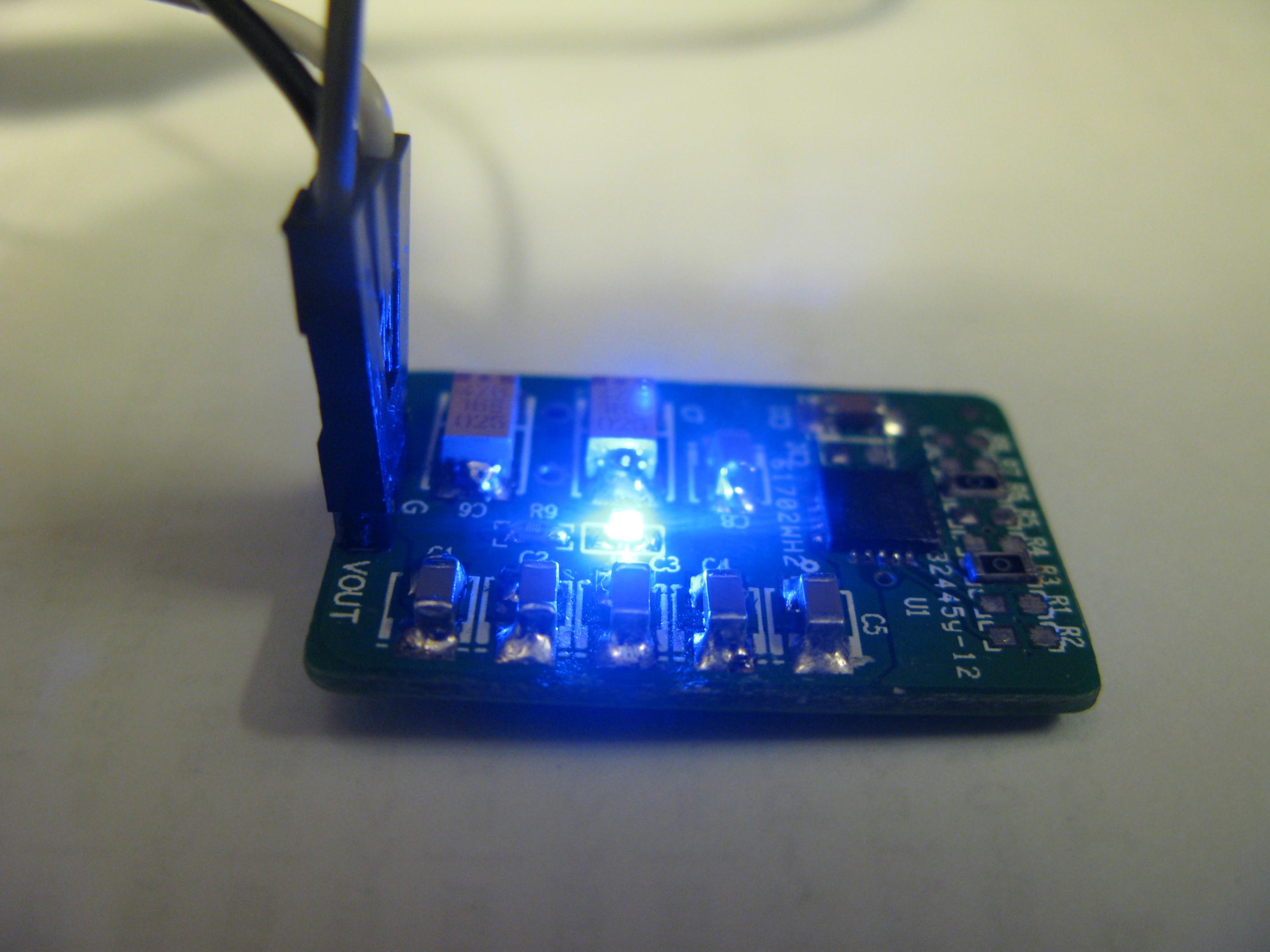

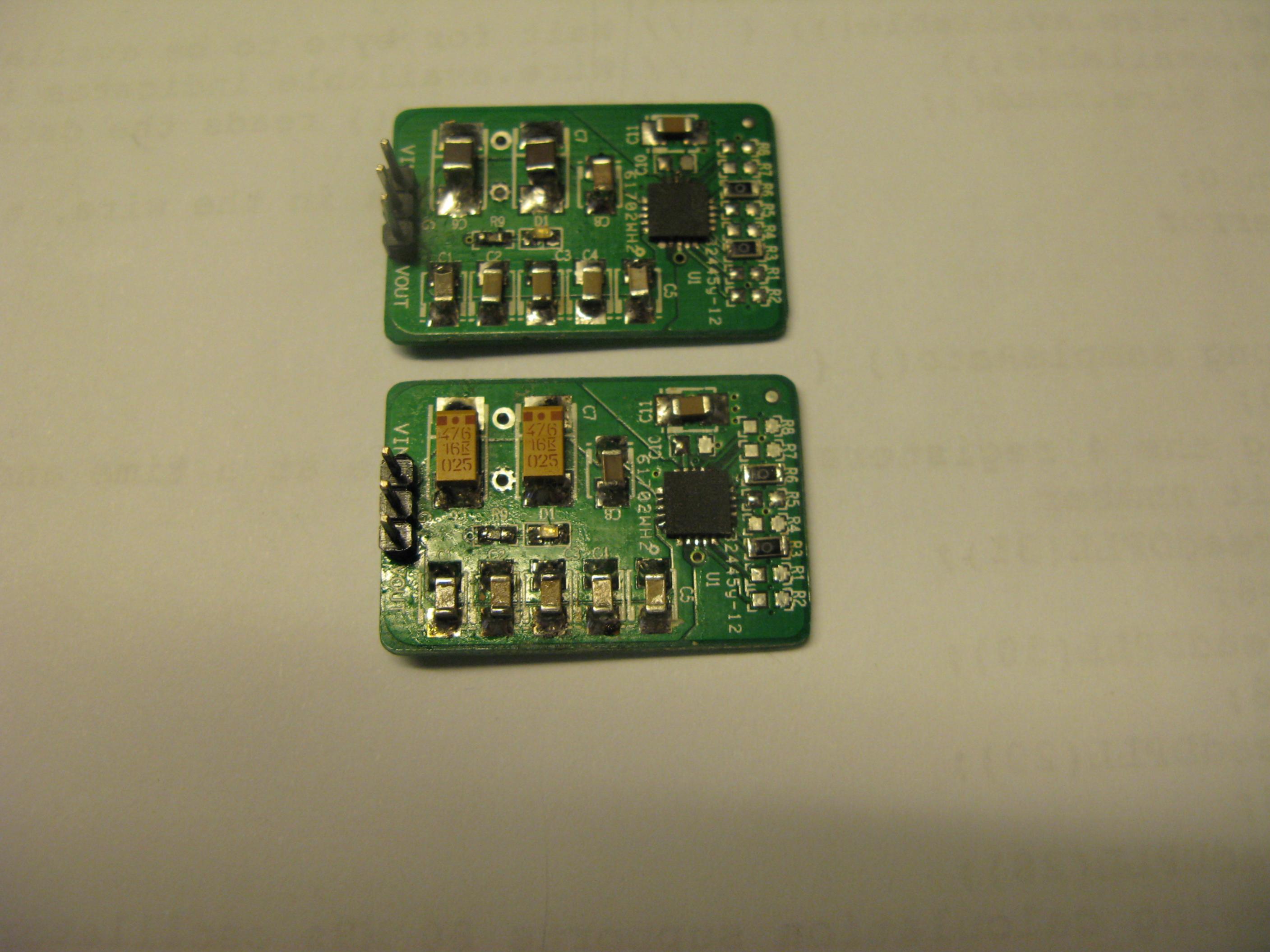

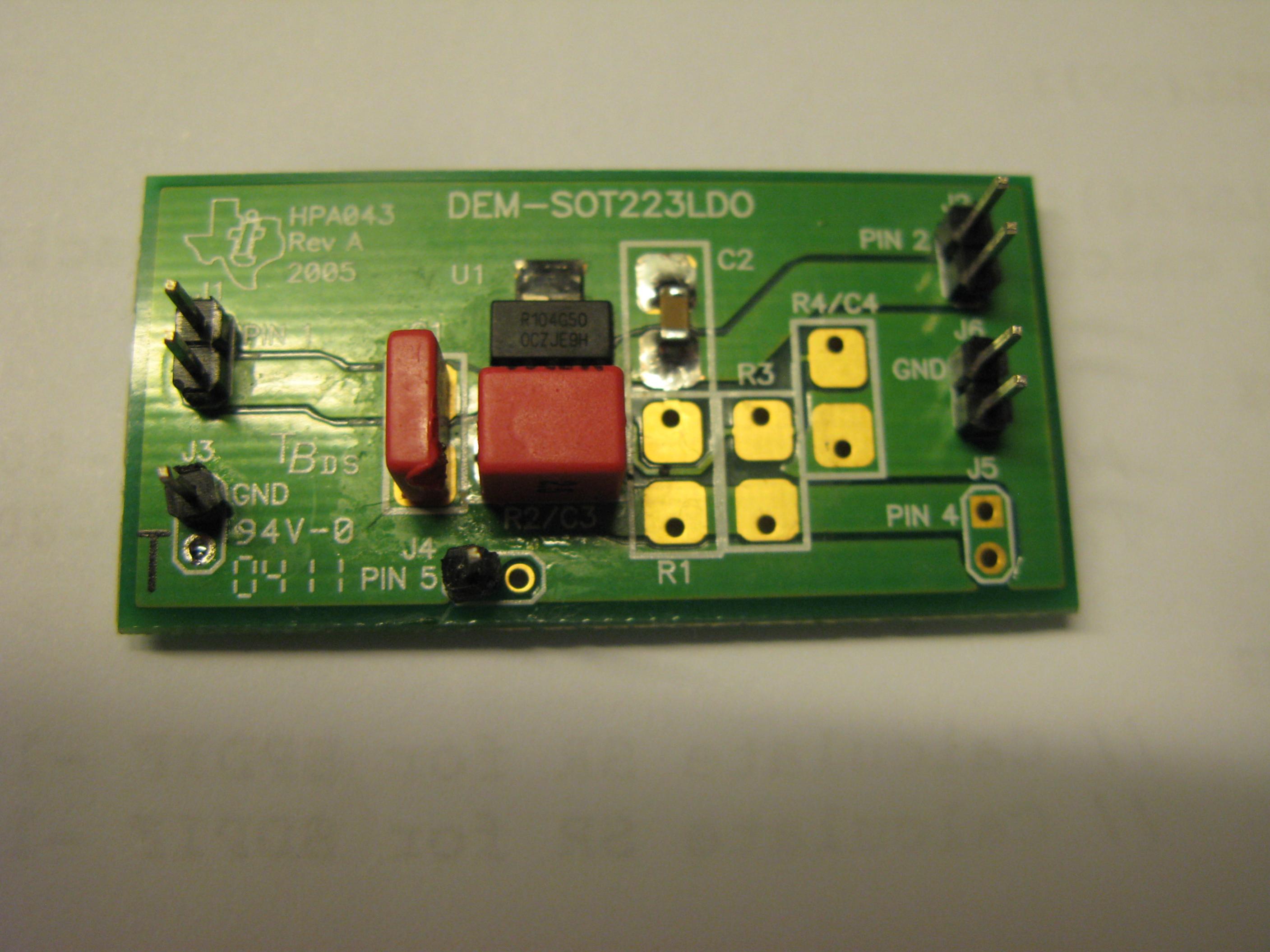

finally fixed the damaged 4700 PCB and built two 5V LDO with Ian's boards.
I also bought some PCB from Ti which suitable for most SOT223LDO, will use this to power the relay boards.

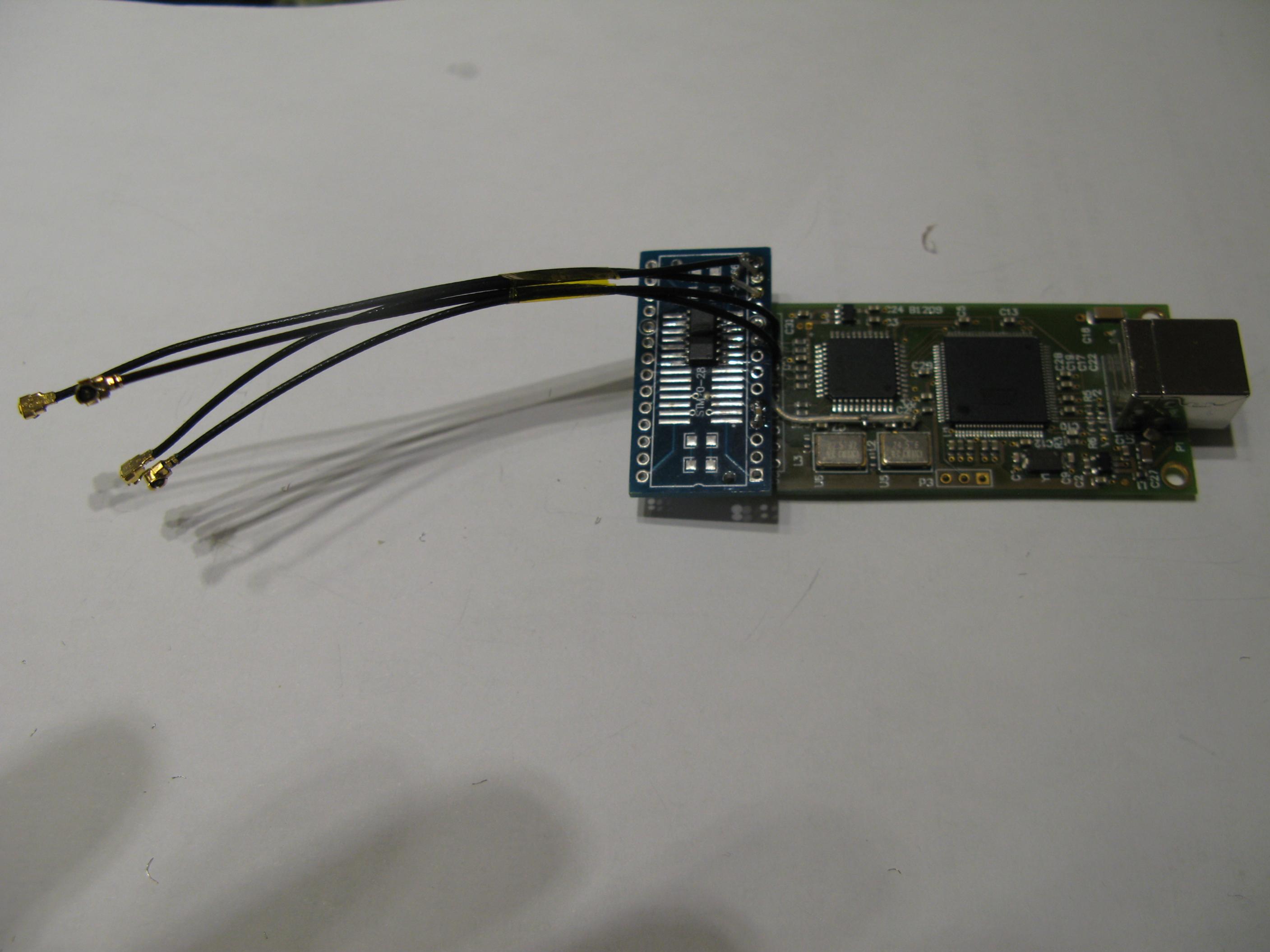

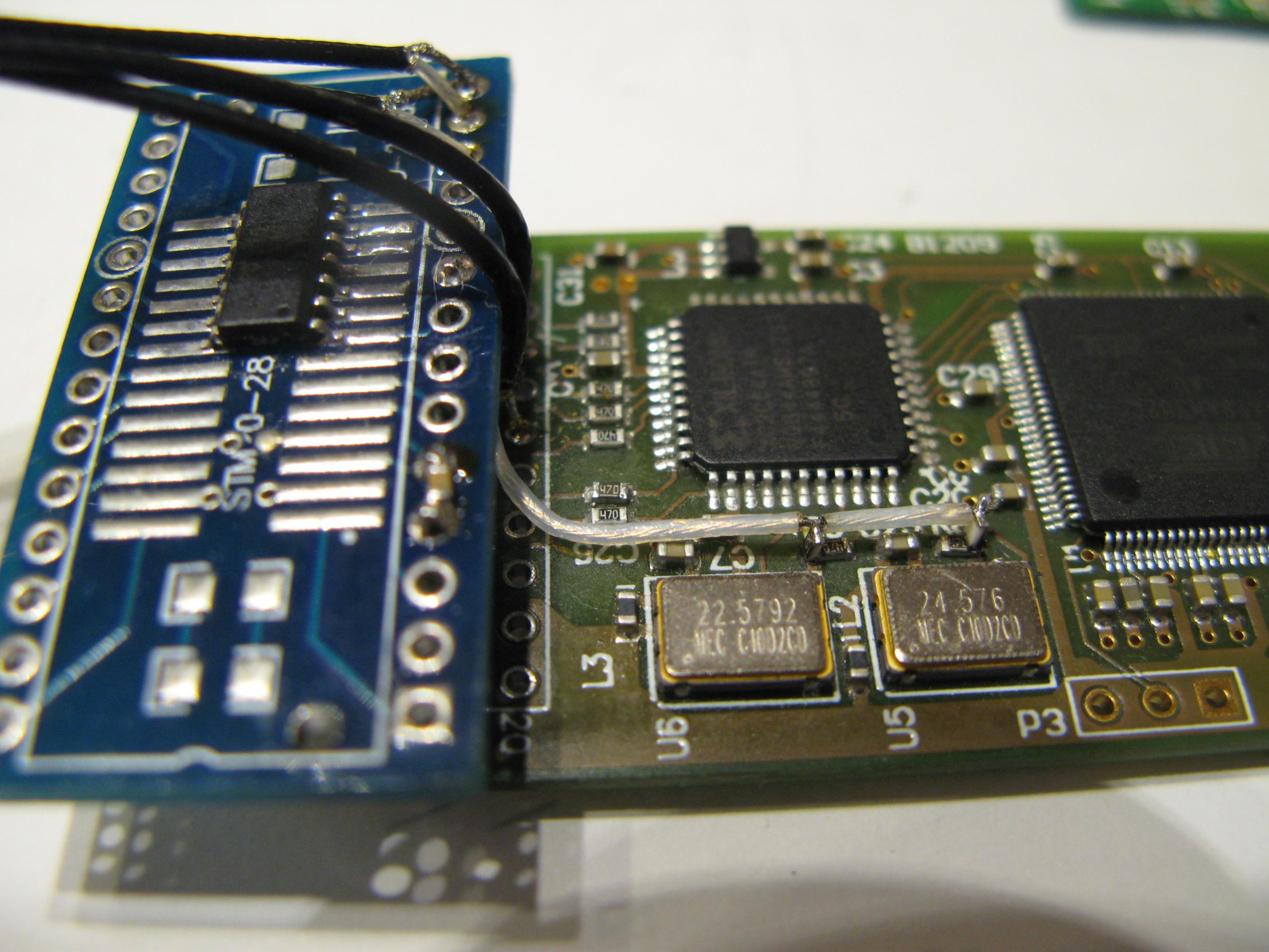

Next is to modify the Amanero using 4700LDO and re-sync the clock.

I modified the Amanero today but don't have time to test.
