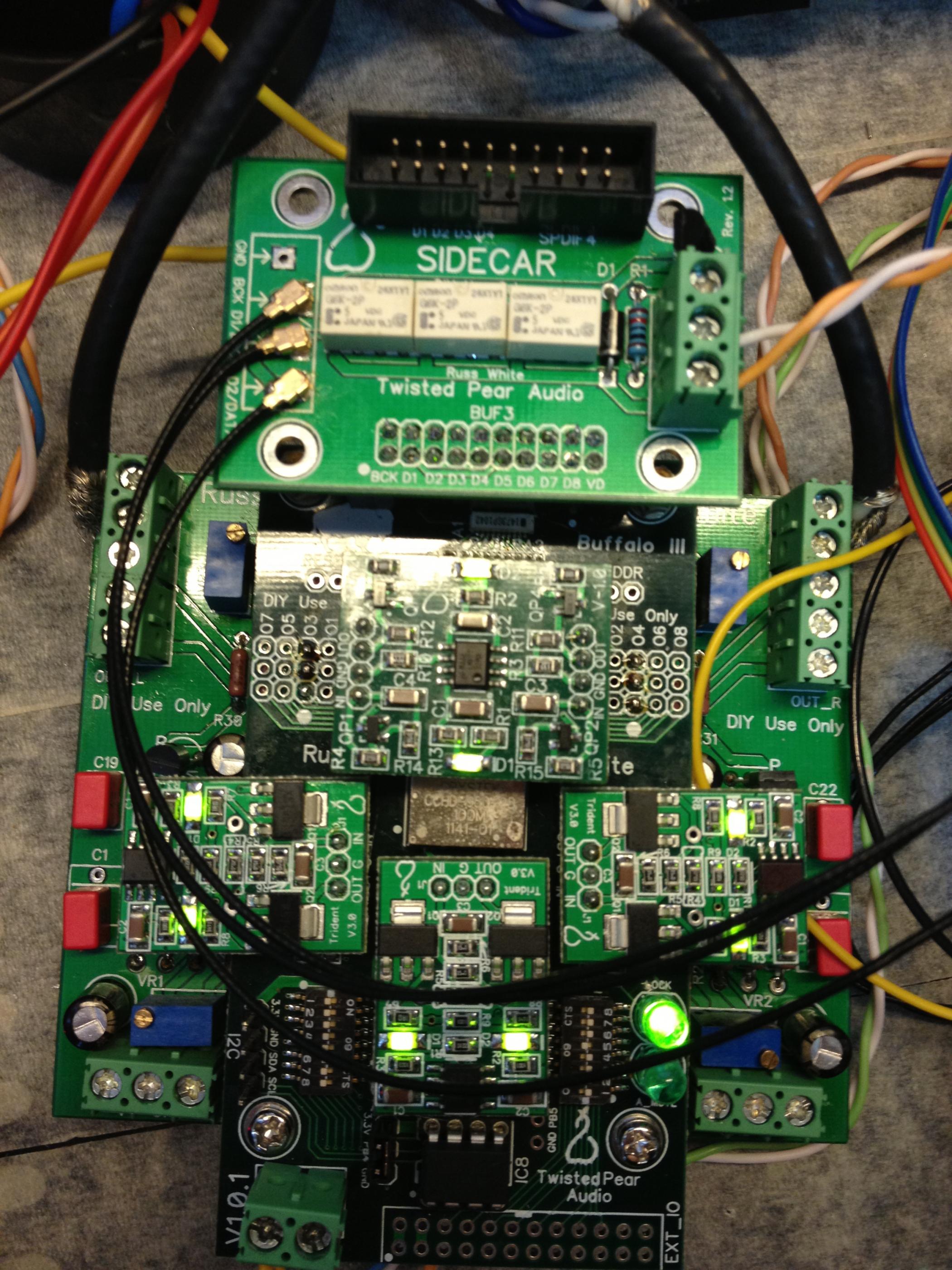

While waiting for the NTD1 GB, I start to connect all the control modules together. Today I modified the SideCar and directly plug it onto the BIII without using the flat cable. Also solder the U.FL socket to the PCM/DSD input.
WaveIO will be connected to FIFO through the SPDIF backdoor. OTTO2 will be used to select between FIFO and DSD.
My plan is to modify a SACD player to output DSD signal and connect to BIII via Teleporter.
I've joined the GB for the USB to I2S DSD converter, may be this converter has to route through the Teleporter as I don't have so many inputs:confused:

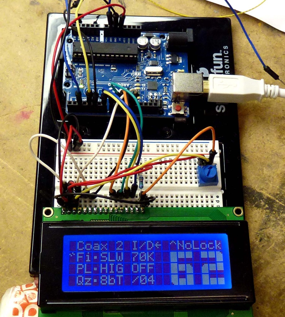

High marks to you and your progress bigpandahk! I got my Arduino UNO with 4x20 lcd going but it doesn't let my dual BIII sing. The code drives me crazy!:confused:
Do you connect the I2C bus correctly with the level converter? Remember to remove the on-board firmware.
Does the Lock LED on BIII light up? if yes, you may put a jumper to short PB4 to 3.3V to see if the Arduino mute the BIII.
Thanks for the suggestions. Yes on the level converter, this one
I followed this HiFiduino wiring diagram
http://hifiduino.files.wordpress.com/2010/10/i2c1.jpg
yes on removing the firmware chip. No lock LED using coax input. I am using the Twisted Pear 4-Channel S/PDIF input board through Sidecar. I tried all inputs with selector and also moving input on S/PDIF board. No code for Sidecar entered yet. Sidecar not triggered so input should pass through.
Can your Arduino Sketch select the source format? Make sure SPDIF is selected.
From your photo, I2S/DSD format is selected instead of SPDIF.
HiFiDuino's code does not support multiple inputs / switching between inputs.
If your source is not connected to the first input (if I remember correctly) it will not be properly selected.
TP's selector relies on the on-board firmware to make the switching (essentially to write the correct values into the 9018's registers), so if you have removed the firmware it will not work.
The solution would be to alter the code so that it supports proper switching between sources (in essense setting the necessary registers). I can help with that, and so can most of the people around here.
