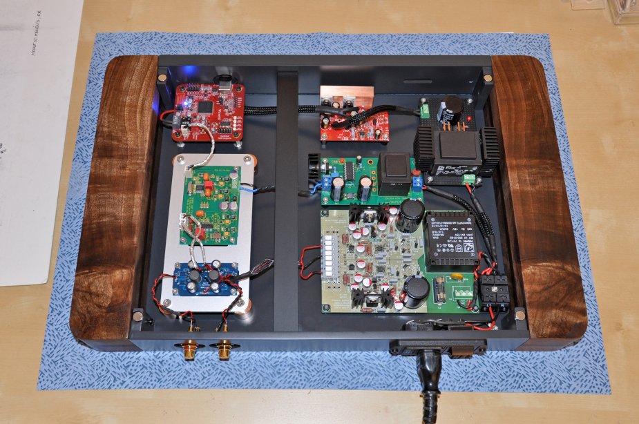

Mine is making progress also...
Almost finished with the case --> sides made from walnut with a stripe of very dark exotic something (not expensive ) in the middle;
signal and power supply divided by a massive aluminum "wall", lid and some details coming in the next weeks. After being disassembled for many weeks it's playing again, and enjoying it minute after minute.

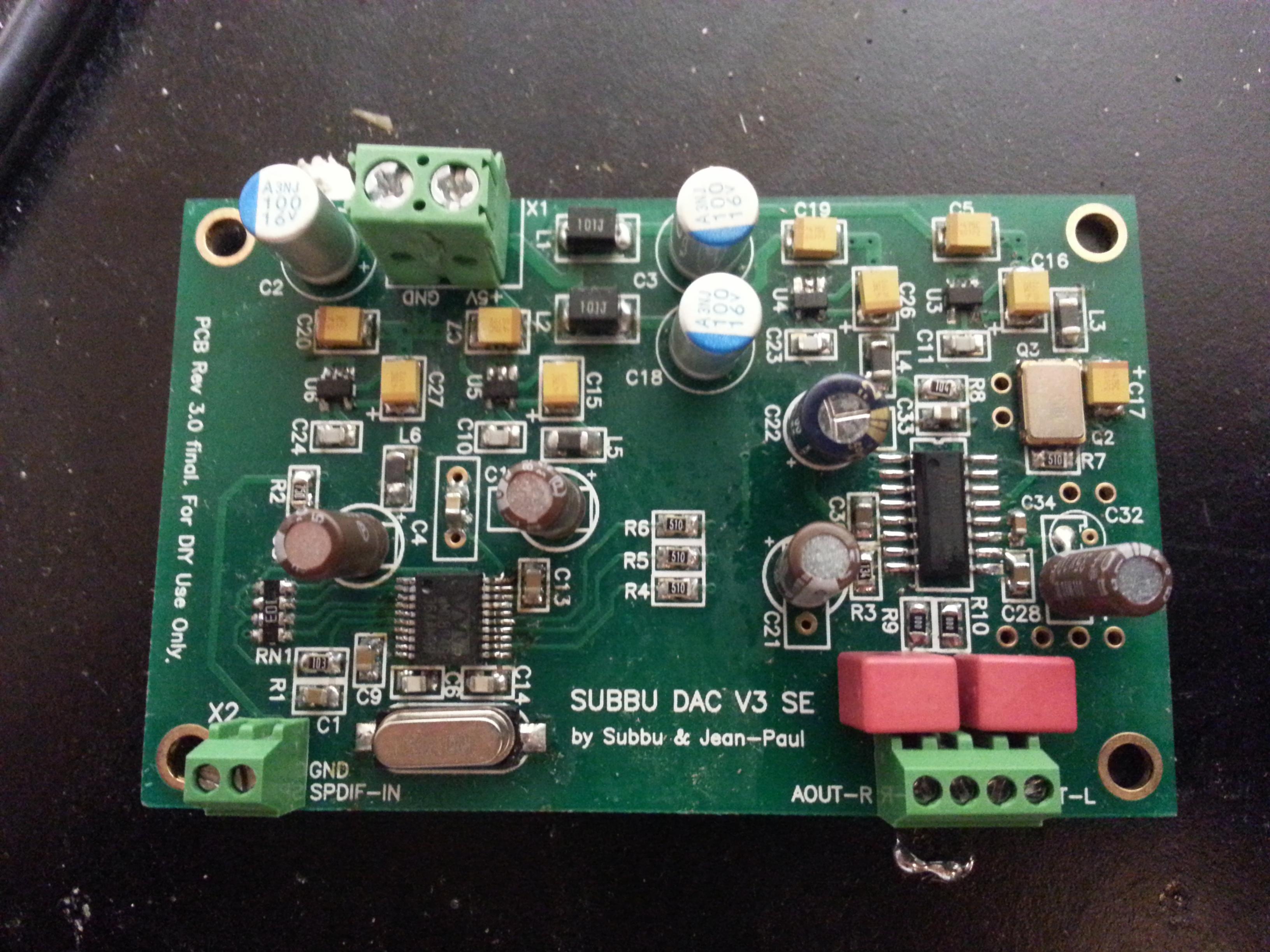

Hmm... I'm testing my board right now but I'm unfortunately not getting any sound out. The power supply gives a steady 4.87V and each of the regulator test points is spot on. No offset at the outputs, but also nothing in the way of music
Any suggestions? I'm hoping one of you can tell me I missed something super obvious
The best way is to check the voltage values : http://www.diyaudio.com/forums/digi...-building-subbu-dac-v3-se-92.html#post3869957
A cold joint on a chip pin can change the voltage values of the other chip : so flux + magnifing glass. Maybe the Wolfson or a reg as the dac chip solder joints seem good and shiny.
At least you should test the solder joint of the XO.
my two cents
my two cents
