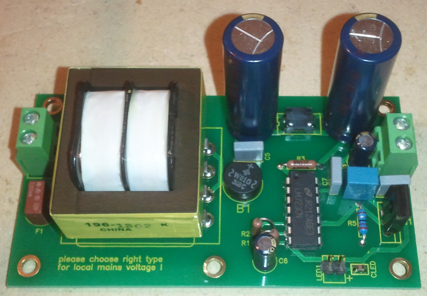

finished psu
here's the psu. just finished soldering the last components tonight (2200uF caps, bridge, led header, and transformer) and cleaning it. the picture doesn't do it justice; it's much shinier in real life :D
-matt
